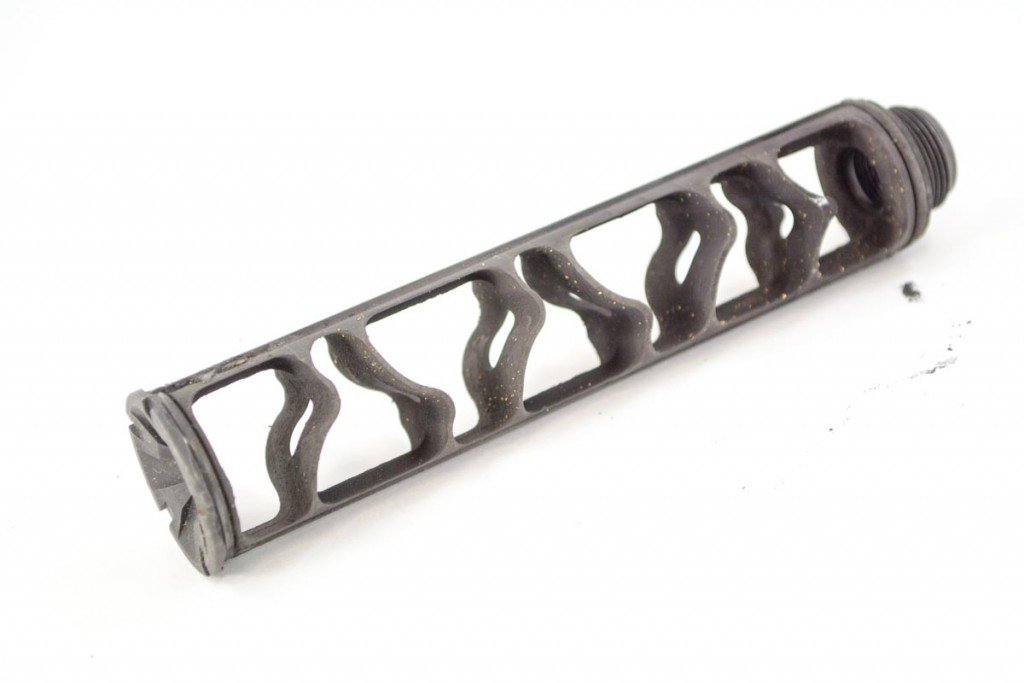

Someone has ever tried a firearm silencer in an airgun I wonder if it will work.
image gusamerica.com
So I have designed and built, legally, both airgun and firearm moderators and suppressors. The firearm designs technically can function on an airgun with the correct adapters, however they don't generally work terribly well compared to their airgun counterparts. Why?
Well a couple reasons. The most obvious is that expectations are radically different for the firearms industry than the airgun industry, so airgun moderators are comparatively larger relative to caliber/power and are intended to make the airgun much quieter. A rimfire suppressor is typically a pretty small device, and meant simply to make your rimfire no longer painful to shoot without earpro, not so quiet nobody would ever figure out what you're doing, as the action of the rimfire itself is typically fairly loud. (even the firing pin strike is hardly quiet) Then there are elements of materials and design. Bullets are relatively resistant to cross-flow in a suppressor, and expectations for accuracy are typically lower than with airguns. As a result they use architectures which will cause POI shift and pellet destabilization in some cases. Airgun moderators, using just cold air rather than burning powder, can use materials such as felt and foam which wouldn't stand up to use on a firearm. This allows further sound damping than you'll find in firearms suppressors.
So, in short, you could do it hypothetically but you'd probably not like the results. I hope that helps. :)

Good info, and one other reason to buy a real "Airgun" device instead of adapting a firearm "silencer". Good airgun suppressors are $150 to maybe $200. Because firearm suppressors must stand up to much more abuse, the standards are much higher, and so is the price. While the firearm suppressor may not be regulated in Mexico, the price of the firearm suppressor is probably 2 or 3 times higher than an airgun suppressor.
Just a thought!
As STO (who is somewhat of a modest moderator expert) mentioned, 'crossflow' is important in Airgun moderators but much less critical in firearms moderators.
This is when gas bounces and swirls off the baffles and inside of the moderators and hits the side of the pellet, pushing it off course. In a firearm, the bullet is generally so much faster it's moved past before the gas hits and deflects it.
He mentioned hot gas vs cold gas and there is a lot of pressure difference too. The cold low pressure gas from an airgun takes somewhat different methods to control the sound and firearms 'silencers' just perform poorly because they were not engineered for it. Seen it tried and heard it for myself too.

IVe got a Form 1 can in .22 LR and an adapter
with my less than accurate/scientific measuring apps, it measures 1 - 3 db louder than a custom can and a TKO 6.5 inch unit
However, my ear hears it as "quieter", which im attributing to changes in tonal characteristics, not a true reduction. it makes more of a sneezing sound than a muzzle pop.like the two AG units produce
My testing site is close to two long narrow buildings and the refleted sound is greatly differnt too, from the other two AG specific units.
never tested for accuracy......
FWIW, the Form 1 can on my 10/22 is dead quiet except for bolt slap (with subs). YMMV
