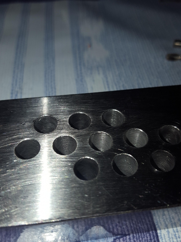

    why dont ask someone who works with cnc maschines they can make you a costum sizer
    i must size my pellets head and skirt in two different sizes becouse my Barrel choke is to smal
    here is my sizer in cal 25 in metric Units 11 holes from 6,34mm to 6,44mm
