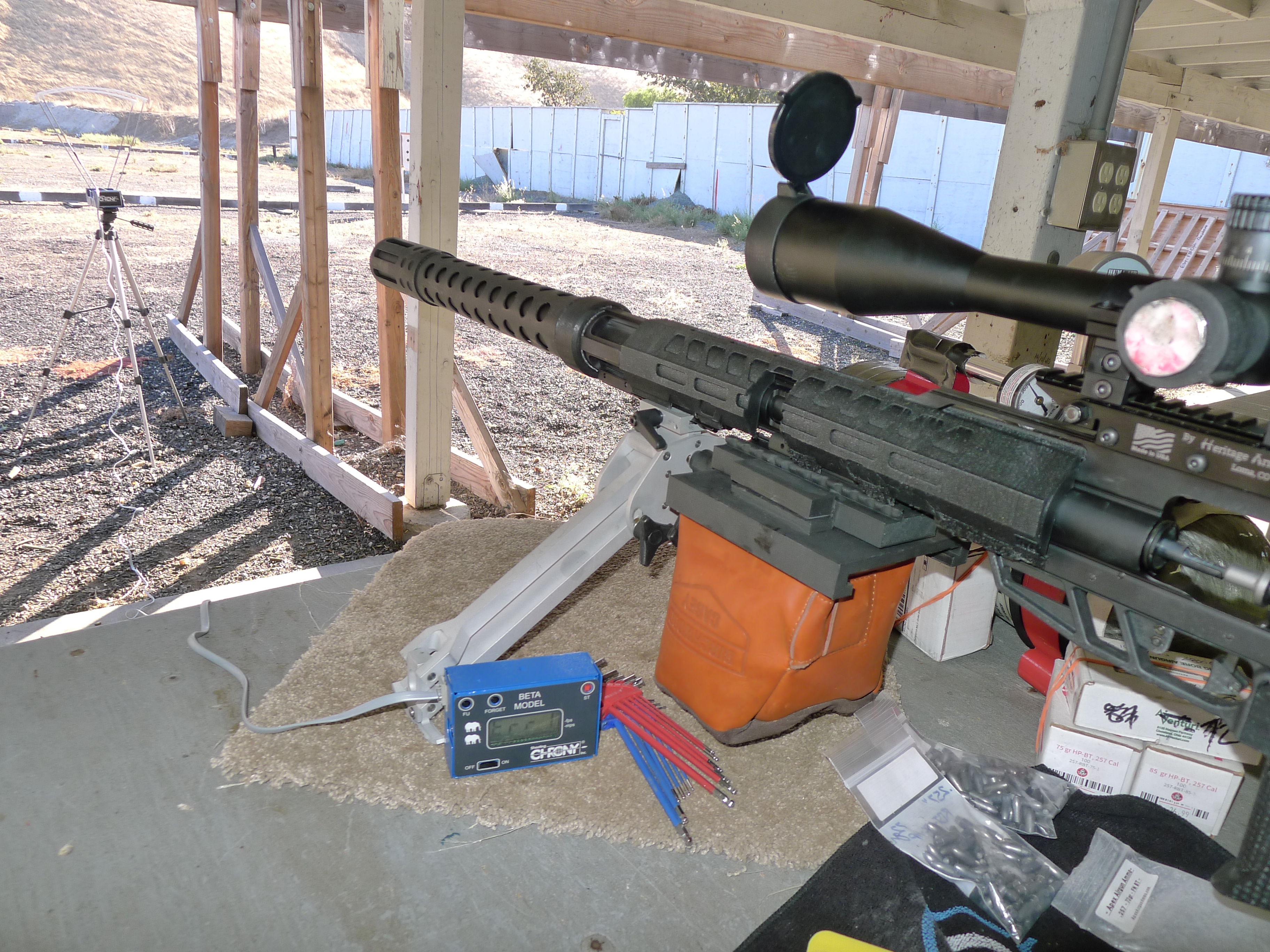

I got the 257 LSS last week from PA.
Yesterday I ordered a Mad Dog Bulldog stock, have a Arsenal 257420 boat tail mold coming and a NOE .258 sizer.

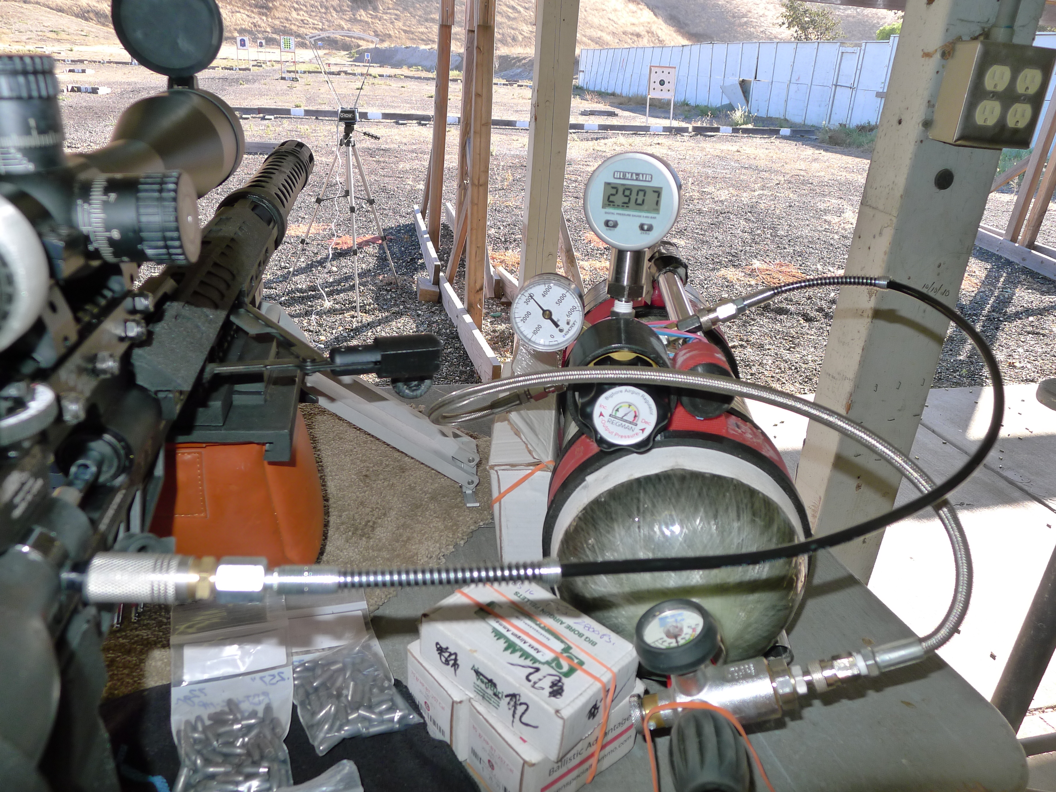

I removed the valve return spring today and I have been looking hard at the .5L carbon fiber 4500 psi tank.
This is my 2nd run at a .257 airgun, the first was a Haley 257 Scandalous with inter-changeable 36 inch TJ Barrels, a 1-14 and 1-10 twist. It was the last 257 Jack made.
If you google Roachcreek 615 yard airgun shot on 12 oz cola can, you can see the Haley in action on utube. At the time that was considered the longest airgun shot to date.
My son has a house boarding BLM land, getting ready to shoot some steel.

Maybe a one liter bottle with the canted adapter?
https://www.pcptunes.com/airforce-larger-tank-angled-adapter.html
With bigger valve: https://www.pcptunes.com/air-filling-essentials/1-ltr-luxfer-carbon-composite-cylinders-300bar-61cu-1000cc-with-extreme-flow-valve-kit.html
Without valve: https://www.pcptunes.com/air-filling-essentials/1-ltr-luxfer-carbon-composite-cylinders-300bar-61cu-1000cc-bare-with-butt-plate-assembly.html
