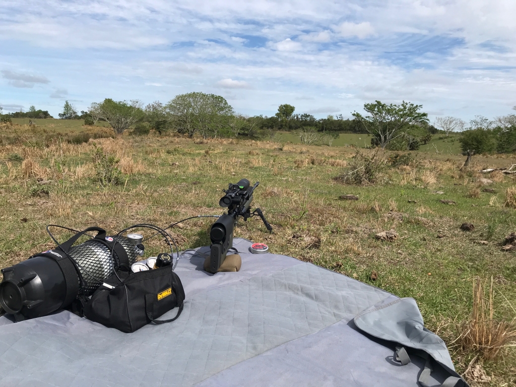

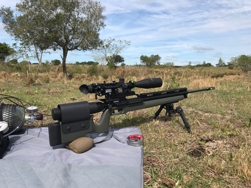

I'm shooting .257 Griffin 72 grain slugs at 2500 psi and at 990 FPS. My groups at 200 yards are around 4 inches. Any recommendations on how to shoot smaller groups?
