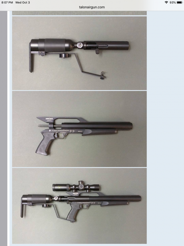

I have a Talon P sort of. I put a Micro Lite kit on it to turn it into a bull pup. A guy on Talonairguns.com named Tagdagger developed the kit to turn a Talon P into a bullpup. This kit moves the breach back about 4” . Using the stock barrel the kit includes a baffle that goes inside stock frame. I bought a Delrin version. I think he now sells an aluminum version of the kit here is some pics.
1538615796_13870780215bb569f48e9242.65482760_AD1B734F-9DA8-4831-A5F8-4E9A54DB8B3B.png
