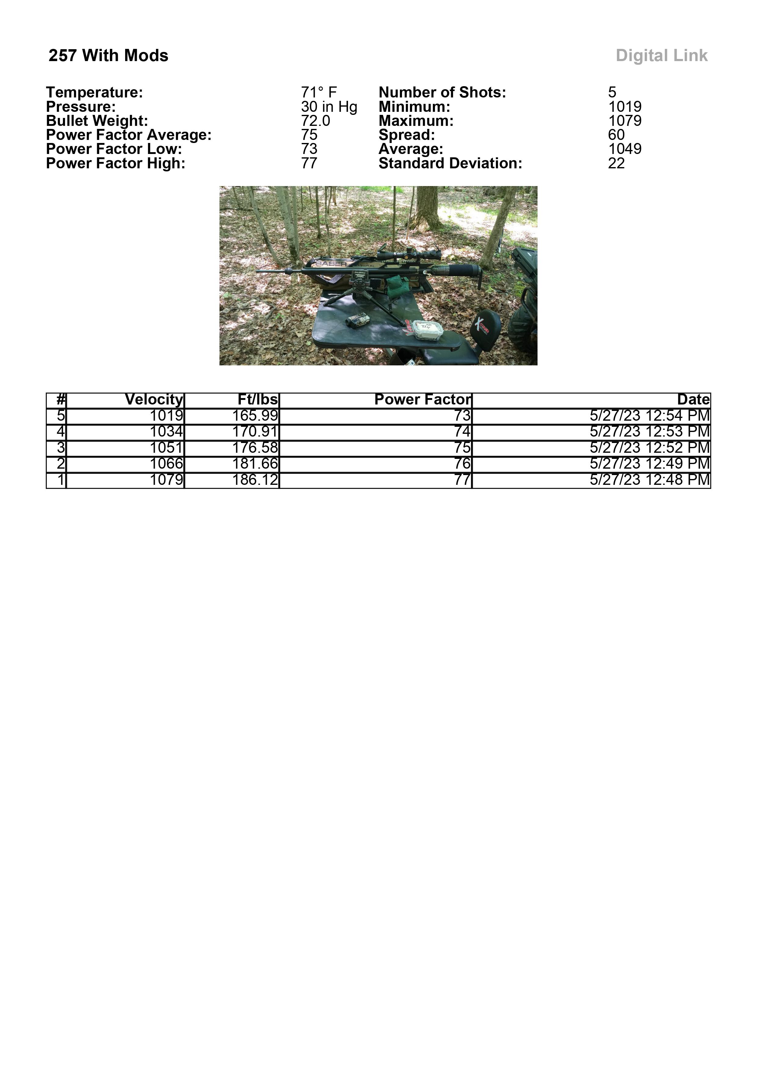

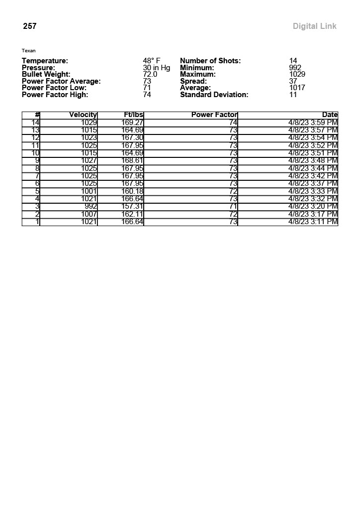

The quality is very good, well made.Imvery happy with it. I don't get that first shot valve lock when you fill it. when i did the chonos i had it about 10-15 feet from me,, it was the only sun i could get so the number would be higher if i move it closer to the muzzle. You can feel and hear the power difference!Wow!!!!Nice.........1079 fps with a 72 slug .....Not bad......How is the quality???? Looks pretty good!!!!!3625psi?I'm glad this valve is working for you....
Thank you, Im very happy with it!Man I'm kinda getting tired of my .510 and 800 fps.....The African Air Ordinance 4500 psi valve too much...I wouldn't mind a .257 switch barrel setup....I'm already used too tethering 3625 psi....This valve is Affordable kit to do a switch barrel rig. I'm so glad you tried this out!!!!!!!
