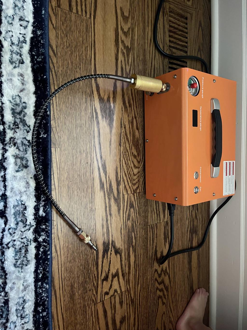

So I do have the smaller filter, does it really matter if I attach it directly to the compressor? Secondly does it matter too about the direction if I switch around the QD to the other side, reason I ask is because one side has desiccant and the other half is a filter. Thanks

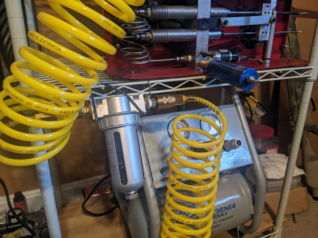

3) Shop compressors with air tools and spray guns hooked to them all have water filters that have a reservoir where gravity is used to keep the water inside the filter. This is how I have the my primary stage of my shoebox set up. From the small 2nd stage output filter the hose goes upward and the gun or tank being filled sits on the top shelf.

If you look at the "vertical" filter in my pic (it's actually horizontal with a vertical reservoir) there is a drain to remove water. In the pic with the Tuxing filter in a vertical position, where does the water "drain"? and where does it go?
Seems to me that it goes back to the compressor, right? To sit in the compressor to be pumped up again? Why you would want to do this makes no sense to me, but to each his own I guess.
My thought is that you are removing the water when you vent. I don't see that water could "return" to the compressor since the venting is between the high pressure cylinder and the high pressure from the compressor. Less than ideal without a drain at a reservoir? Seems so. But I still see the gross moisture that builds up as mostly leaving the system at each venting. But as you note, to each his own (especially since neither of us knows FOR SURE what is happening inside the system).
