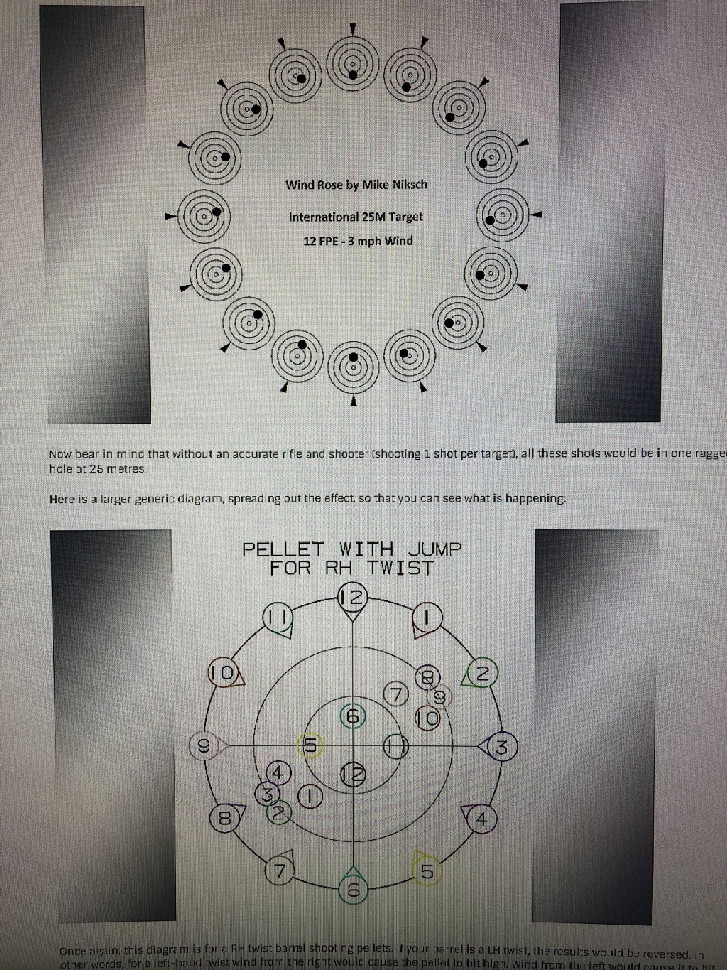

To the OP, look for something like this. It is called a wind rose. It helps you to see that given the direction of the wind, the pellet will be effected in different ways. For example, a headwind will cause the pellet to impact slightly down from the POA. And Tailwind will cause the pellet to impact high of the POA.
Be sure when you find a wind rose online somewhere, that you are getting the one for PELLETS. Slugs behave abnormally comparatively.
