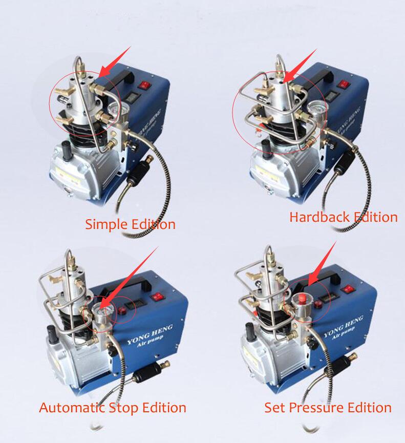

BTW, There are 4 versions of the Yong Heng Air Compressor; I own the Hardback Edition. Best of luck, friend, Fellow air gunner and artist, Jef
The "Simple Edition" does not have a water separator and the "Auto Stop Edition" stops near 3000psi so you likely want the "Hardback" or "Set Pressure" units. These are decent compressors I have one that has been good for 2 years and another, I bought for back up because I over heated my original badly several times, that had a $12 part go bad in two months.
Thanks for the replies, guys. I should have mentioned I've got a 75ci Omega carbon fiber bottle I will be filling with it - I know what means it will run longer and wear more, but it sounds like people are using the Yong Heng to fill bottles without too much difficulty. The "set pressure" version seems like a good idea if it could actually turn itself off at a set temp without babysitting it, but whether it actually works seems unclear. Is the consensus that the "hard cover" version is the best?
The set pressure version works pretty well but it is not totally reliable and shouldn't be trusted to leave unattended. The coolant pump is also something that should be supervised so having an auto-stop feature is redundant IMO. The information about the auto-stop version above is incorrect. The cut-out switch on this model is set to trip at 300 BAR on the gauge. Mine stops just under that at about 4200 PSI. I have disconnected the switch and it now operates the same as the hardcover version. If I was buying another one and I had a choice, I would get the hardcover version.
