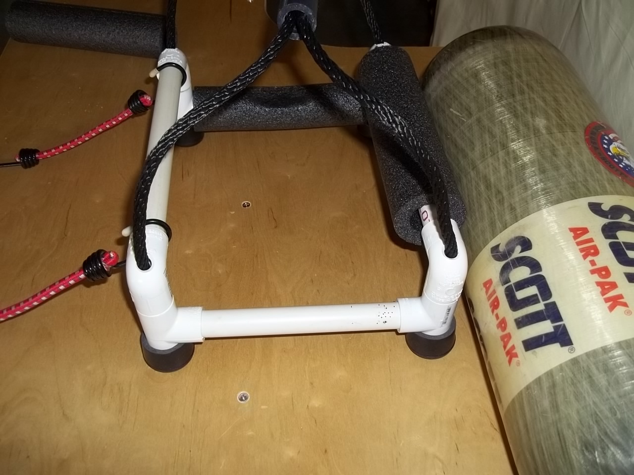

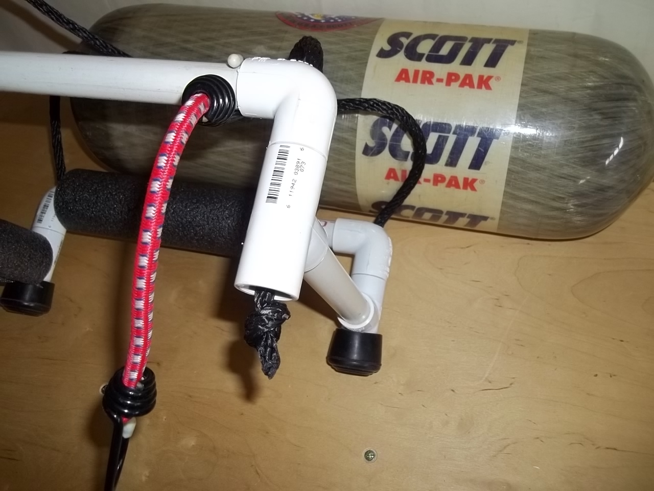

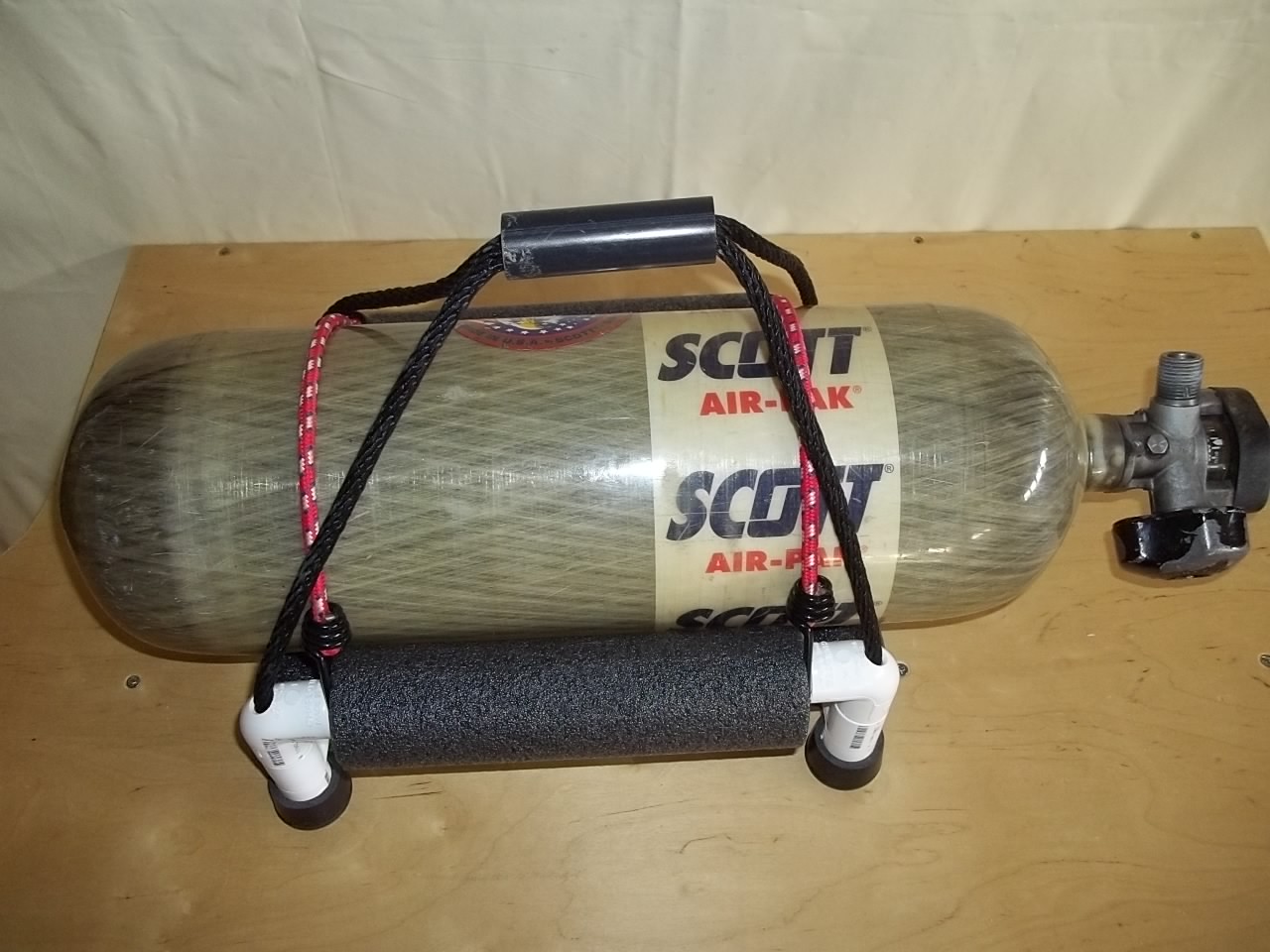

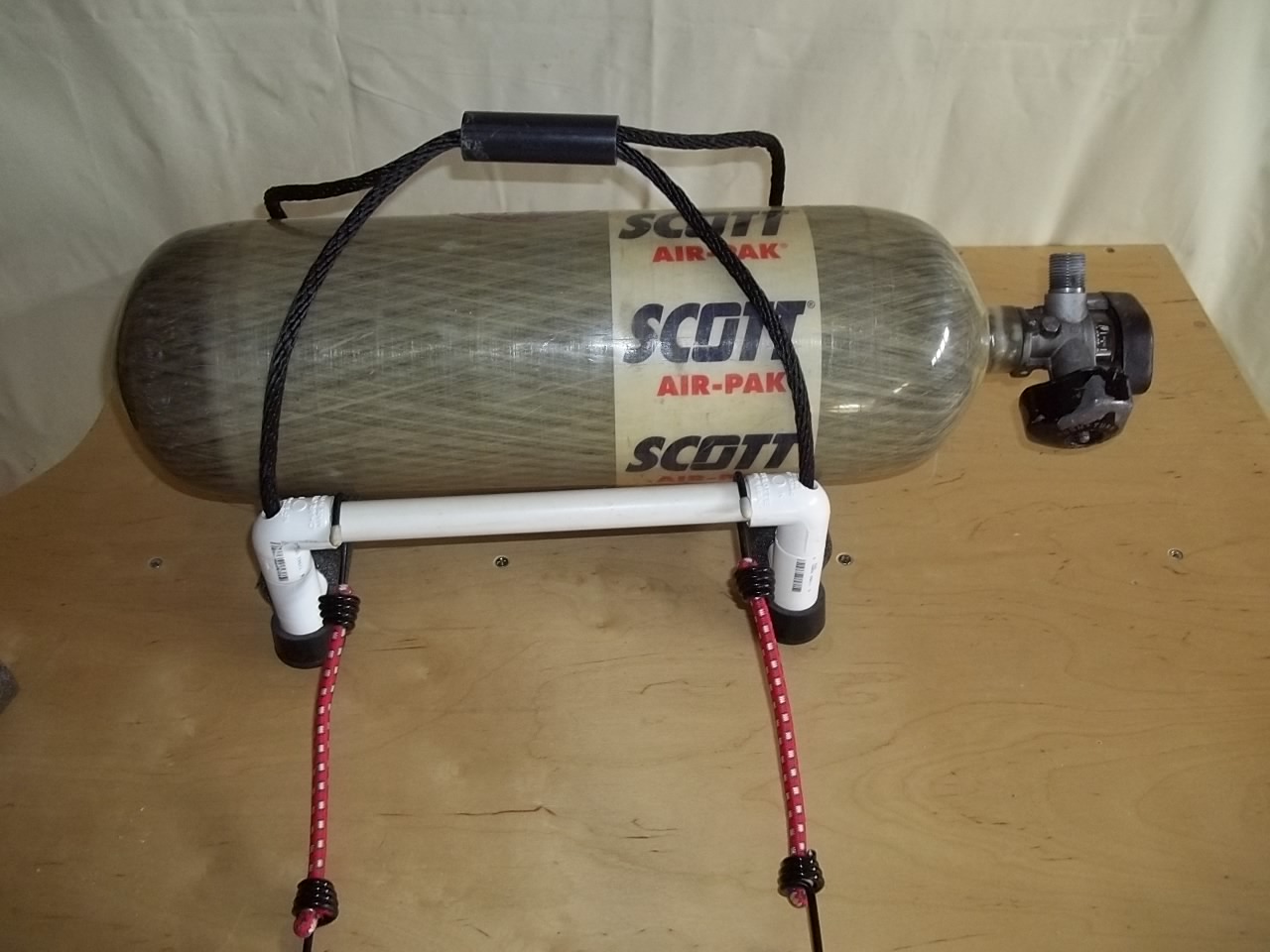

Been raining last five days, so decided to do something constructive, came up with pieces in the basement to make a bottle carrier. To buy all material to make will cost $10-$15
List of 1/2" PVC material schedule 40.
(4)-1/2" "T"
(4)-1/2" L-s
(2) 7" cross pieces ends
(2) 10" side pieces
(4) 1 1/2" connecter pieces T to Ls
(2) bungee cords
(1) 6" piece for handle & rope
Foam removed to see frame
(4)-1/2" "T"
(4)-1/2" L-s
(2) 10" side pieces
(2) bungee cords
