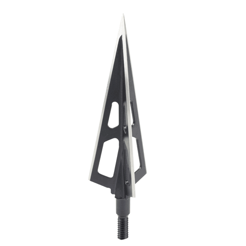

Broadhead wise I think the best for this application are either the Magnus Snuffer or the Wensel woodsman.

I was using 160gr Snuffers initially on the Claw and didn't see any I've now settled on the 125gr

@AirArcher66 I keep coming across “Woodsman” or “Woodsman Elite” branded broadheads. Are these the same as the Wensel Woodsman broadheads that you’re recommending? Here is a link to one of many that I’ve seen in my search results. https://bowhunterssuperstore.com/br...KJogj2ptOWKB1g91veiEHnBHOdHe2mHIaAl5rEALw_wcB
Yup, Wensel is the guy who designed the heads ( I just always called them that way for some reason :ROFLMAO: ) , the 3 to one ratio makes this head even better then the Magnus Snuffer
Well, mixed results with the Dragon Claw. It fires field points very well. I shot on low power and am estimating its firing the bolts over 400 fps. Same point of aim and it only drops 2.5" at 30, and 5" at 40, this was using my 20 yd hold. Broadheads were hitting 5-6" high left at 30, so now I'm searching for a better broadhead. I tried 125 sniffers and Rage xbow x heads.
