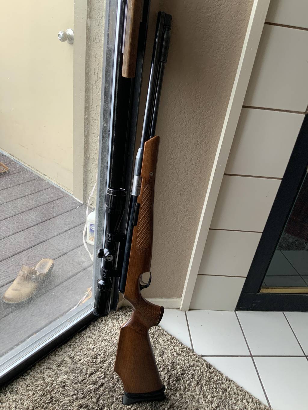

Hello there. I’ve got a TX200 that I need some help with. It shoots magnificently, but I like my springers to not have a single fault. The TX200 is my first under lever, and I don’t understand much about how the under lever mechanism works.
There are two issues I have with it. First, the under lever is loose; by that I mean it can be moved left and right and is not sturdy. It sways left and right ever so slightly and it doesn’t affect anything...however I want to fix that! Secondly, the trigger blade is loose as well, so like the under lever, it can be moved left and right ever so slightly. Let me know.

Is this a NEW rifle or a Used one ?
Used.
OK .... The wobbly cocking arm is WEAR & TEAR. generally aggravated by off center cocking pressure and a lack of lubrication on the pivot.
FIXING is Replacing the entire lever.
Trigger blade follows this same thinking ... wear and tear running w/o lubrication on pivot.
Now looked at as a general "Why For" ..... Rifles been SHOT A LOT !!
