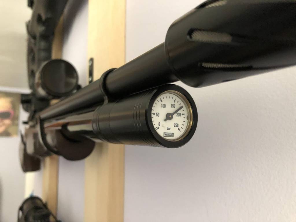

Is yours already regulated? If so disregard. If not, and you ever plan to put in a HUMA, the pressure gauge on the stock will read the regulator pressure. If you want to read your cylinder pressure, you need an end gauge. I put in a Wika gauge that uses a fill probe and it was worth the 100 or so bucks for the part. I got this one off Darren at XTX before he closed up shop, but you can get them from other sellers

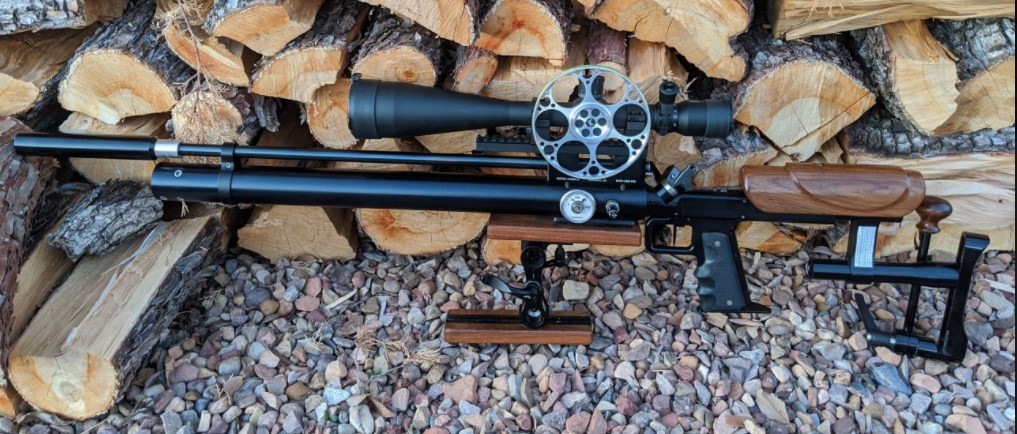

I'm in the foreground. My knee riser/hamster is one made by Tim McMurray. His normal knee riser has a wooden cup that kinda hugs the knee cap vs the longer rectangle of wood that I requested. I also specified longer "dog-legs" which is what he calls the connecting pieces between the two rectangular pieces of wood.
Here is a bit better pic of my gun and the Timmy Mac knee riser.

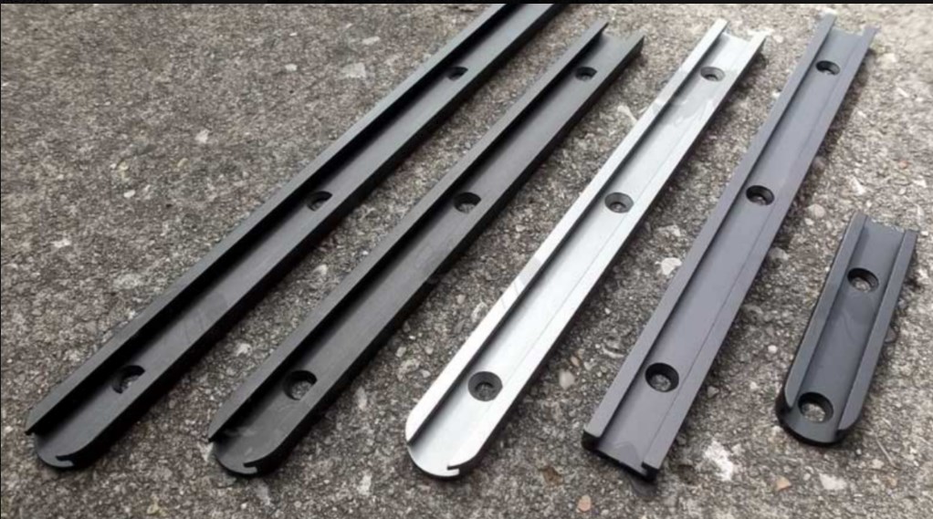

Mine (and I think the RAW option) attaches to the gun with a UIT/Anshutz rail like this:
I think the XS ultimate sporter actually comes with the UIT rail built into the forearm, not sure if your daughters gun is that version of the XS510, but if it is, it'll be easy-peasy since rail is already there.
