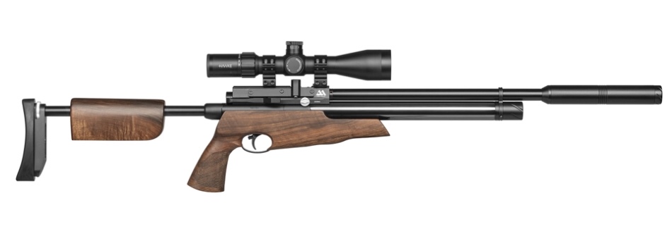

Anyone have one? This regulated version of late (past year or so) ...specifically in .177
How do you like it (esp against hw110/ hw100 carbines)? Worth the $$$? esp on quality build side of things.
What fps and accuracy (again for .177) are you getting shooting heavier pellets and/or slugs?
Lastly having experienced it, would you still get again if had the chance or something else in place of it (what would that be?)
Thank you. (Trying to decide on one...obviously; current price has be sitting on the fence thinking hard.)
