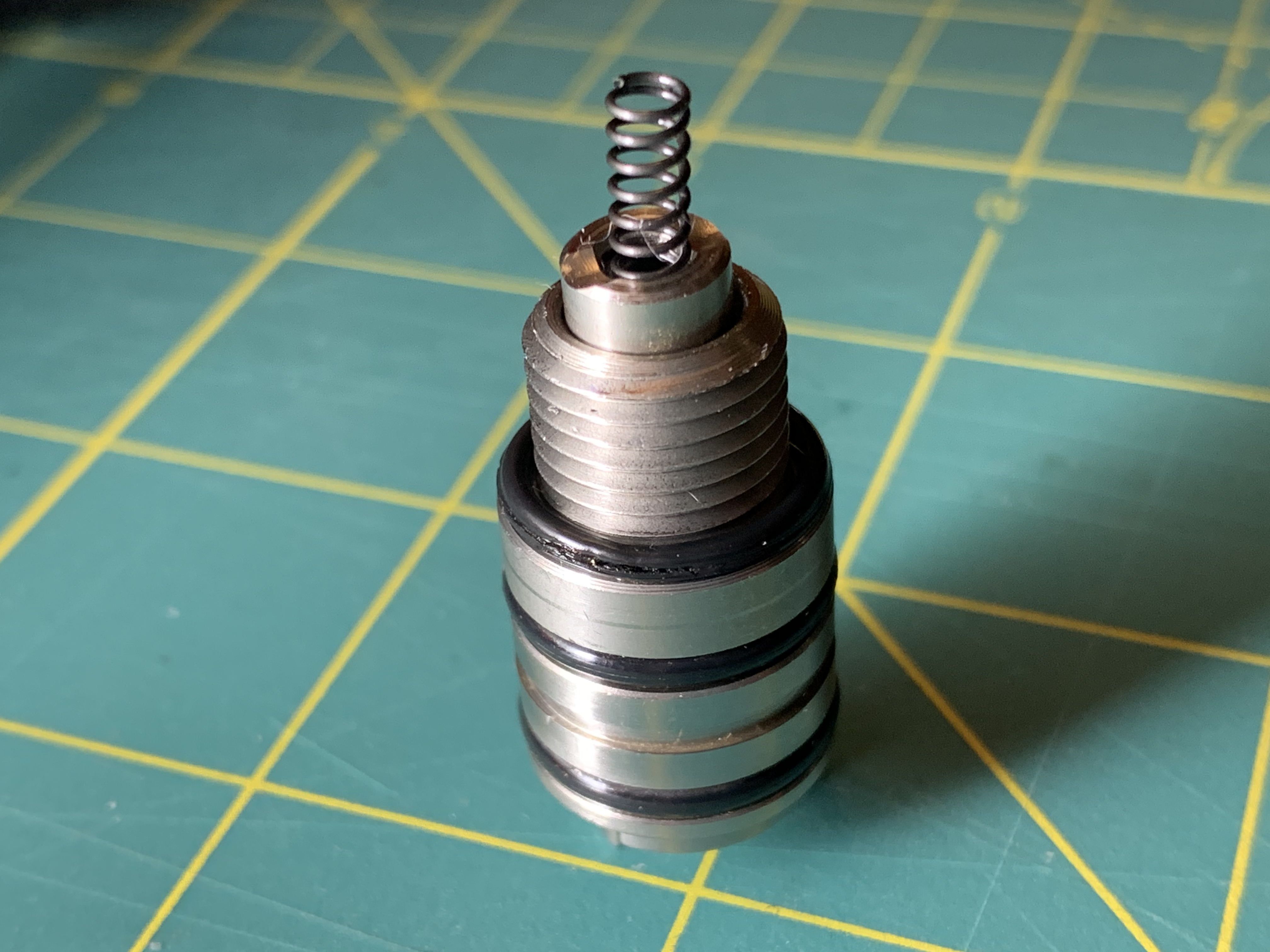

First thing I did was replace the funky AA fill method with a foster QDWas at the computer when I suddenly heard a hissing noise in the living room. I immediately figured it was the Chaser and that I might've left a CO2 cartridge in there for too long. But a little more searching led me to the S510. I put my finger near the fill valve cap and felt air coming out of the hole on the front it. I unscrewed the cap and, sure enough, saw what looked like an o-ring trying to squeeze itself out where the fill valve meets the air cylinder.
Not sure what caused the sudden leak, but the o-ring had a nice slice through it.
I do like to fill it to ~260 bar so when the air cylinder cools it goes back down to 250. That might be the issue. In any case, I figured it was time to install the BEST Fittings Foster kit I bought a few months back. Went surprisingly easy. No thread locker. I did, however, lose the spring for the T-bar valve. Will have to find a source for those.

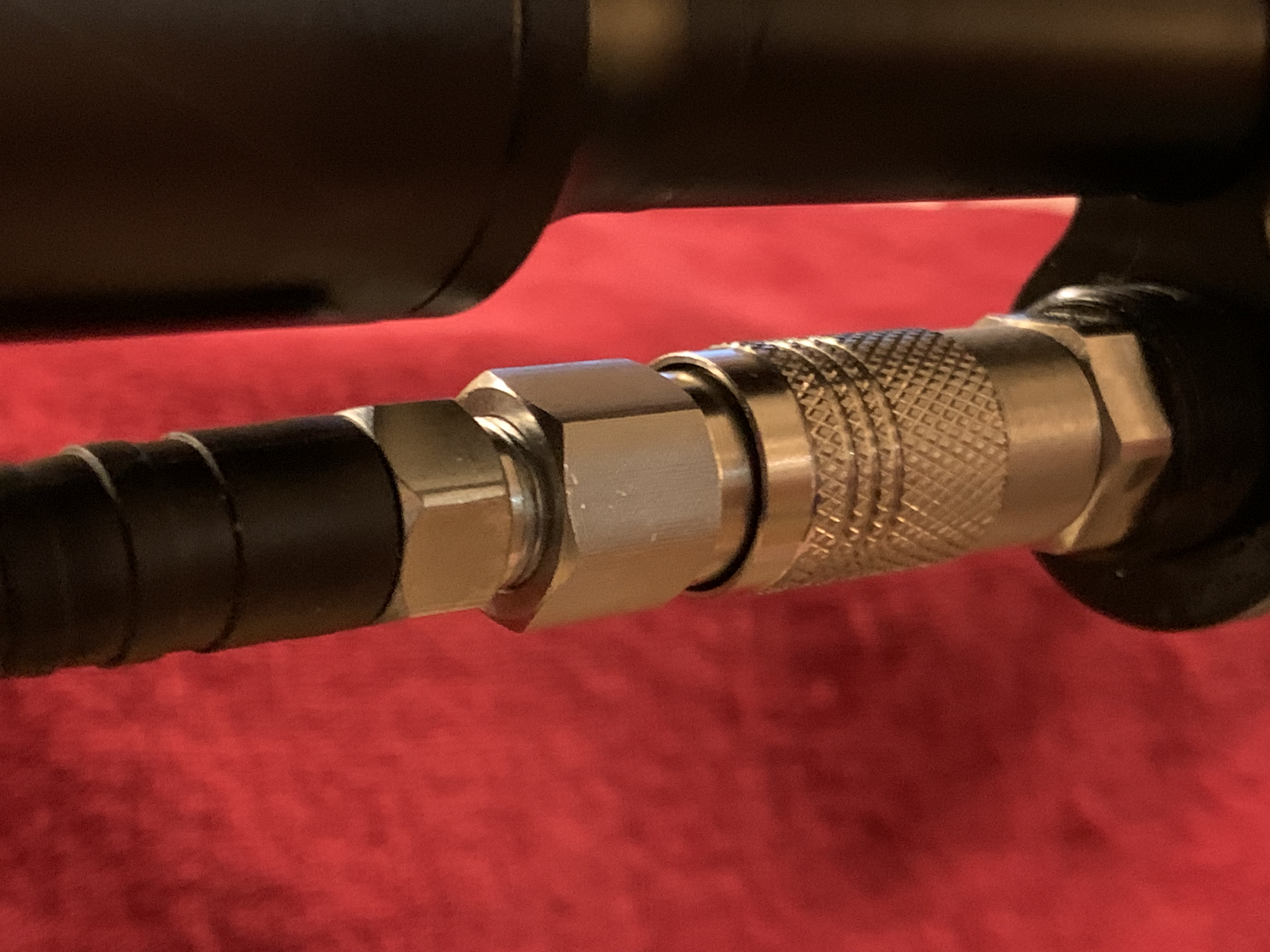

Something I didn't consider beforehand was the clearance between the new valve and quick disconnect. I purchased my Stikman with an extended quick disconnect, and the gap between it and the suppressor is minimal.
I've been considering trying a different suppressor, but even with the DonnyFL adapter I'm wondering if an aftermarket one will even let me fill the gun. Anyone try a new suppressor for their S510? Is it even worth it?
