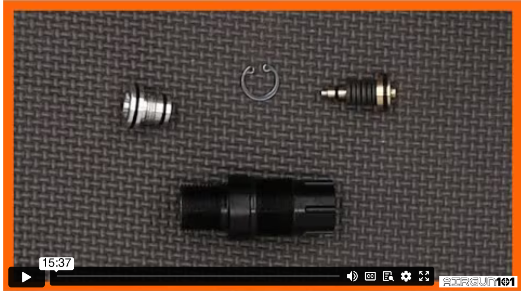

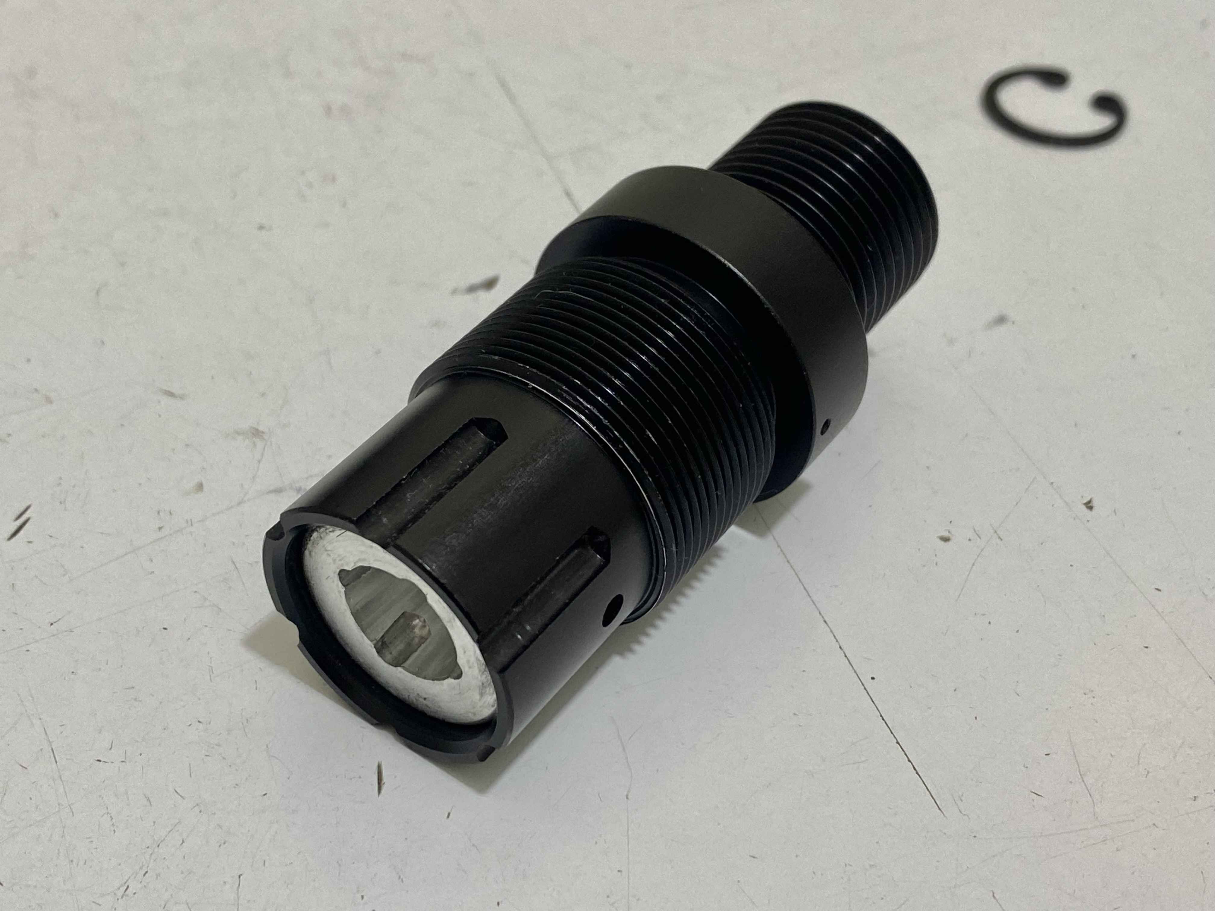

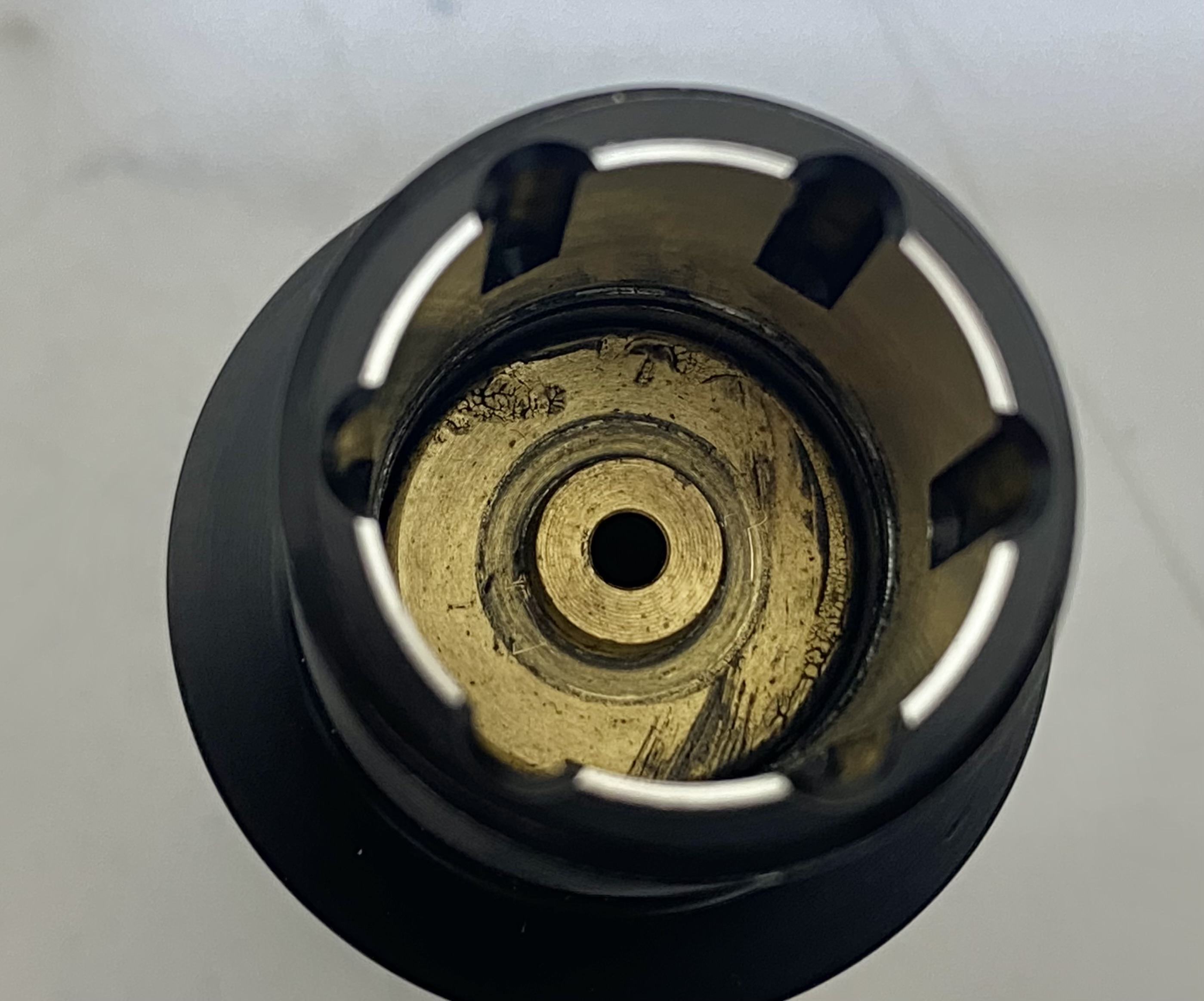

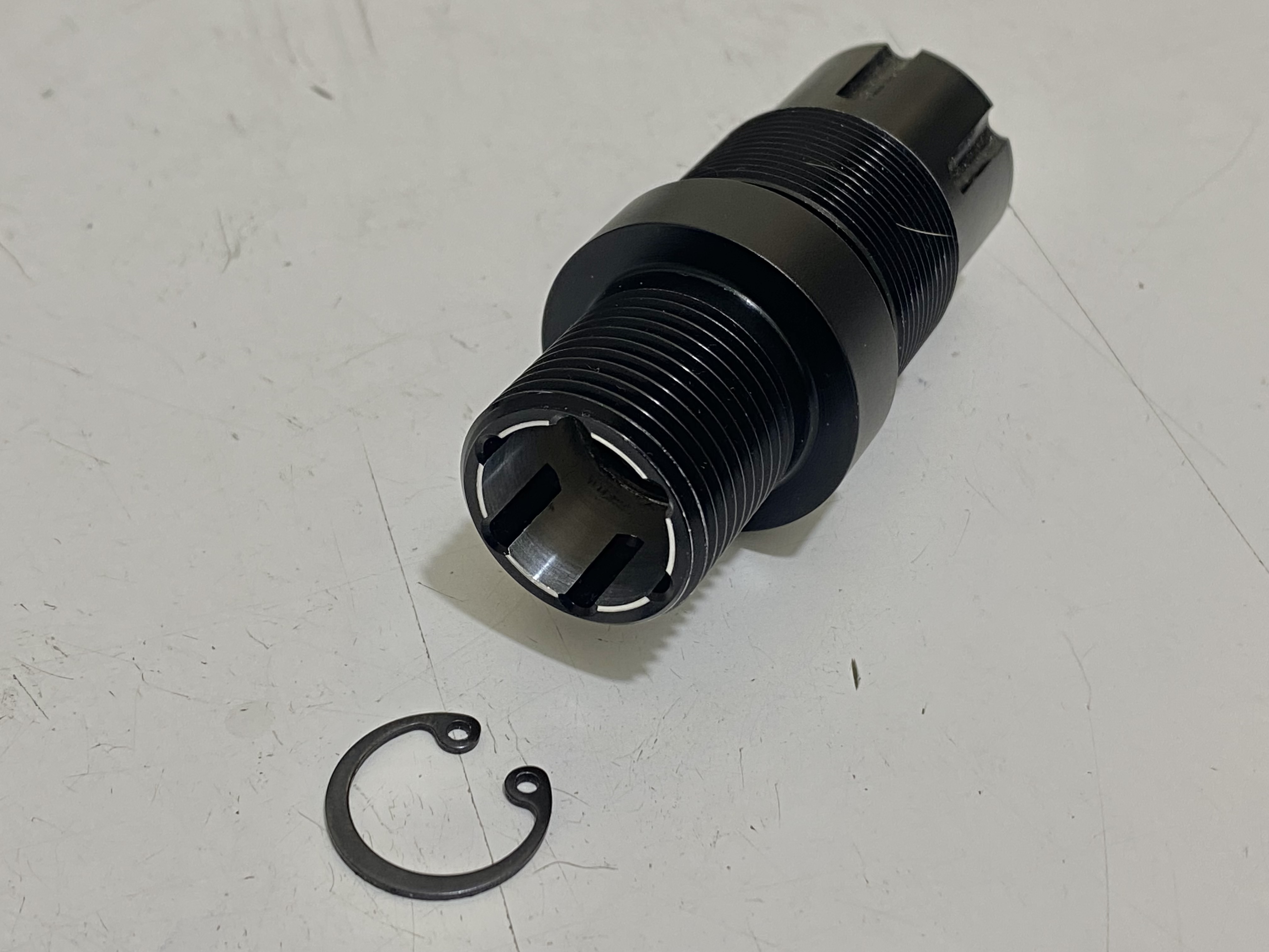

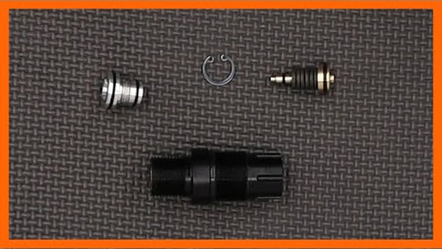

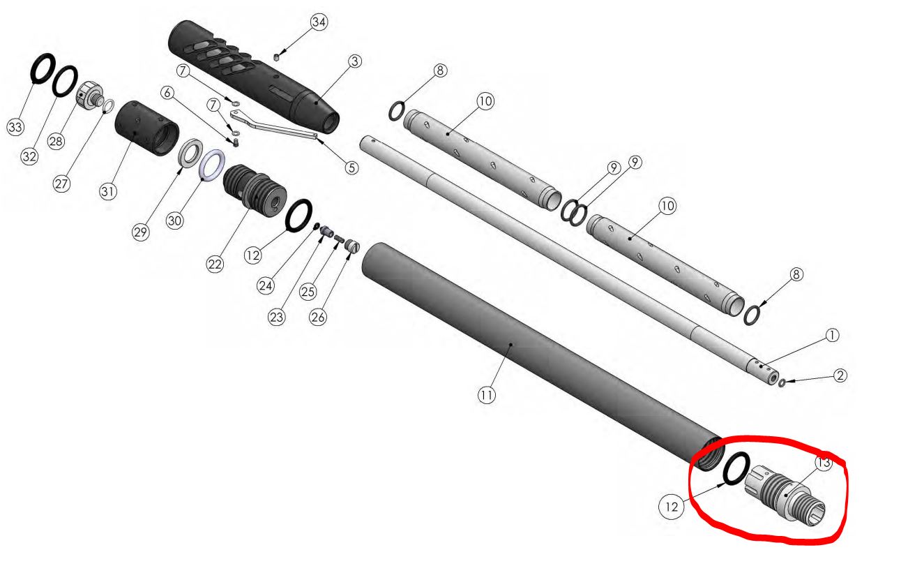

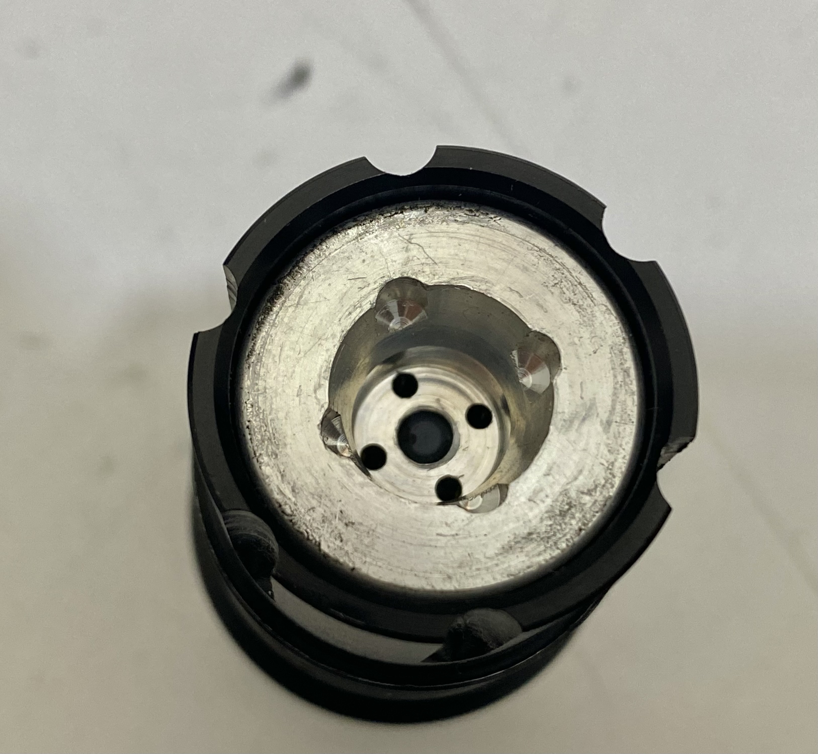

After being put aside for a few years, my FTP900 is found to be leaking basically everywhere. So far I have managed to replace the O-rings in the air tube but the regulator is leaking through the bleed hole. The user manual does not provide any diagrams of the internals of the regulator nor any part list so I don't even know where to start. I have removed a retaining ring hoping that the brass component beneath it will drop out but it did not happen. As a matter of fact, that retaining ring is not retaining anything at all but just sitting in it's slot. The model is discontinued so I am not sure if Air Arms will give any support . Any advice on how to go ahead to fix it ?
