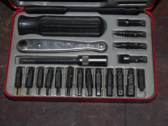

I've had a Chapman set for nearly 40 years. I've twisted one of the smaller allen bits by over-stressing it, but it still works. Great tools and much more of a variety than they had 40 years ago!
@GerryR Have you purchased any of their gunsmith sets or do you use their tools to work on airguns or traditional guns?
I've been gunsmithing since the early 2000's and have used the Chapman set many times on traditional handguns and rifles, mostly handguns. I'm new to airguns. When I purchased my Chapman set, they didn't offer the specialized sets that they have now, so it is the basic set they then offered

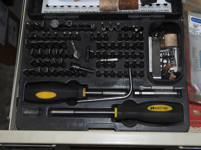

. I also have a Wheeler Gunsmith set, and they have some interesting specialty gun bits, but I would choose Chapman and Brownells over the Wheeler set. The Wheeler set is pretty nice, but I have broken a couple of their bits, I believe, due to poor heat treatment making them too brittle. I indicated that I twisted a Chapmen bit and still use it; it's tough, but not brittle.

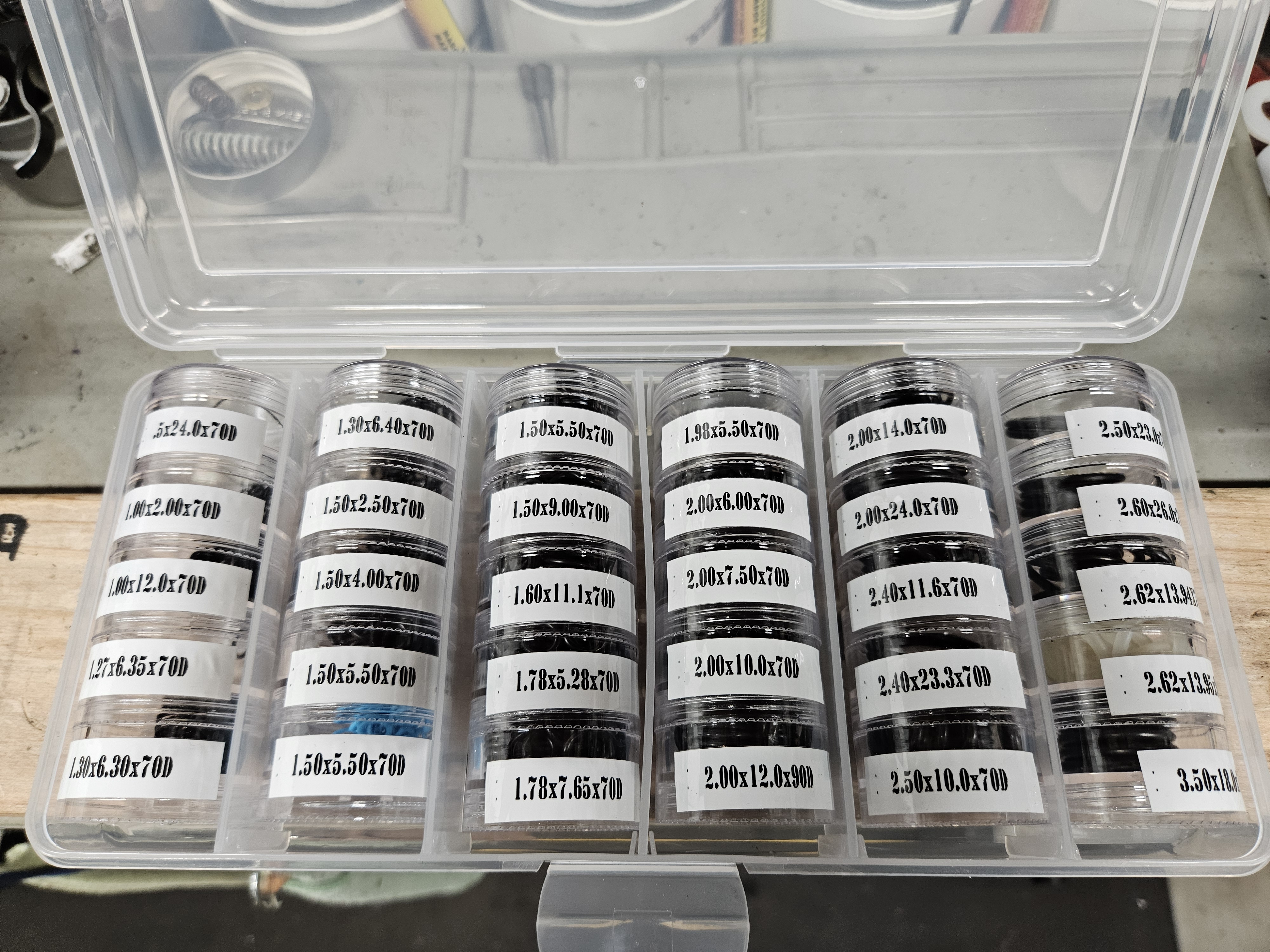

Oh yeah....I like these O-Ring storage cases. Got them at Michael's for about $15. They are actually "Jewelry Organizers" by Bead Landing, made in China....of course. I tried to find any other country of origin, impossible. Each small container threads onto the next. They are also made in larger diameter units, but they won't fit into the box container.
mike
