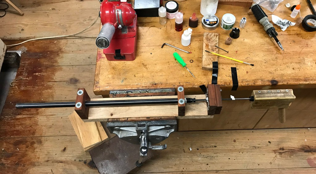

What other airgunsmith tools do you all recommend aside from the typical torque drivers, picks, punches, hex wrenches, padded pliers, spanners, strap wrenches, wooden dowels, bore scopes, etc? What sort of tools for restoring crowns would you all recommend? I saw @nervoustrig with a wooden clamping contraption to work on a barrel, maybe some sort of barrel vise. Is that something that you made?
Yes sir, it's a shopmade lapping fixture.

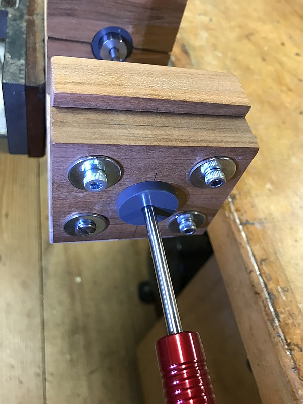

The faceplate has a small amount of adjustment to center up the rod to the barrel to keep it from rubbing:
