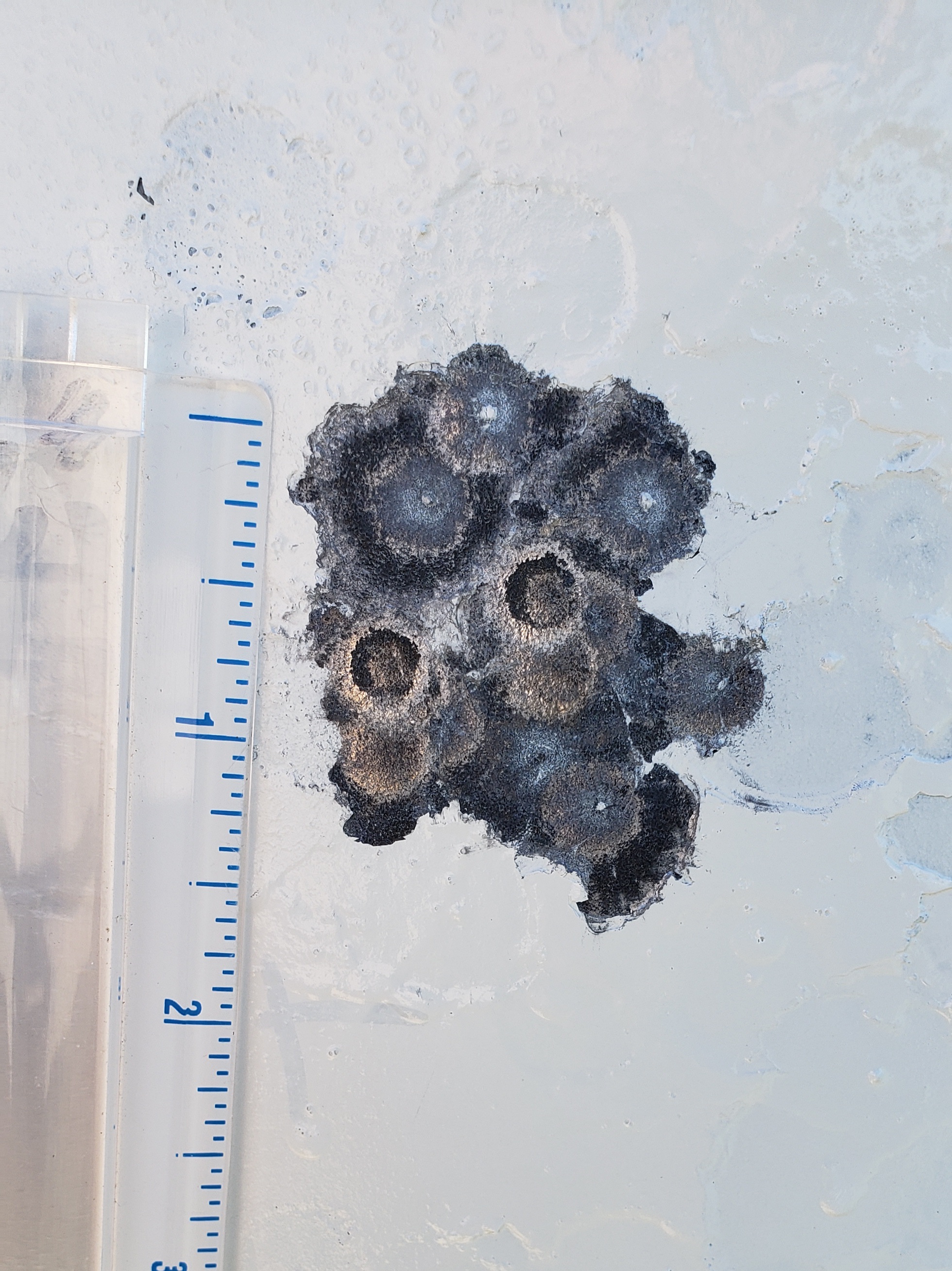

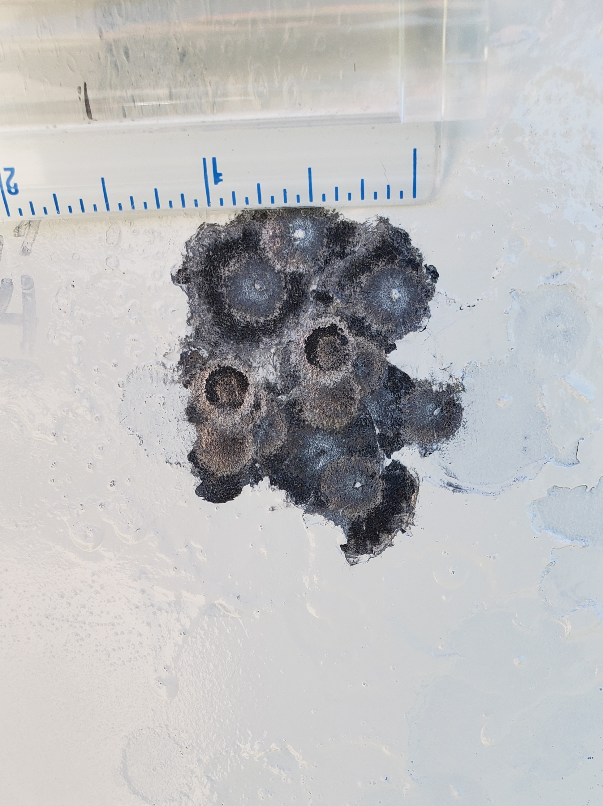

Meanwhile. Back at the ranch....It's been going on now about 6 months since my Vulcan 3 arrived, so I figured an update was due....this was not a cherry picked group, actually it wasn't even the best group. JSB .22 18GR at 100 yds, full magazine. Light wind 1-3 mph left to right. The more I shoot it, the better it gets. AGT Vulcan 3 is staying in this ranch stable. Nice guns.
Meanwhile. Back at the ranch....It's been going on now about 6 months since my Vulcan 3 arrived, so I figured an update was due....this was not a cherry picked group, actually it wasn't even the best group. JSB .22 18GR at 100 yds, full magazine. Light wind 1-3 mph left to right. The more I shoot it, the better it gets. AGT Vulcan 3 is staying in this ranch stable. Nice guns.View attachment 289607View attachment 289609

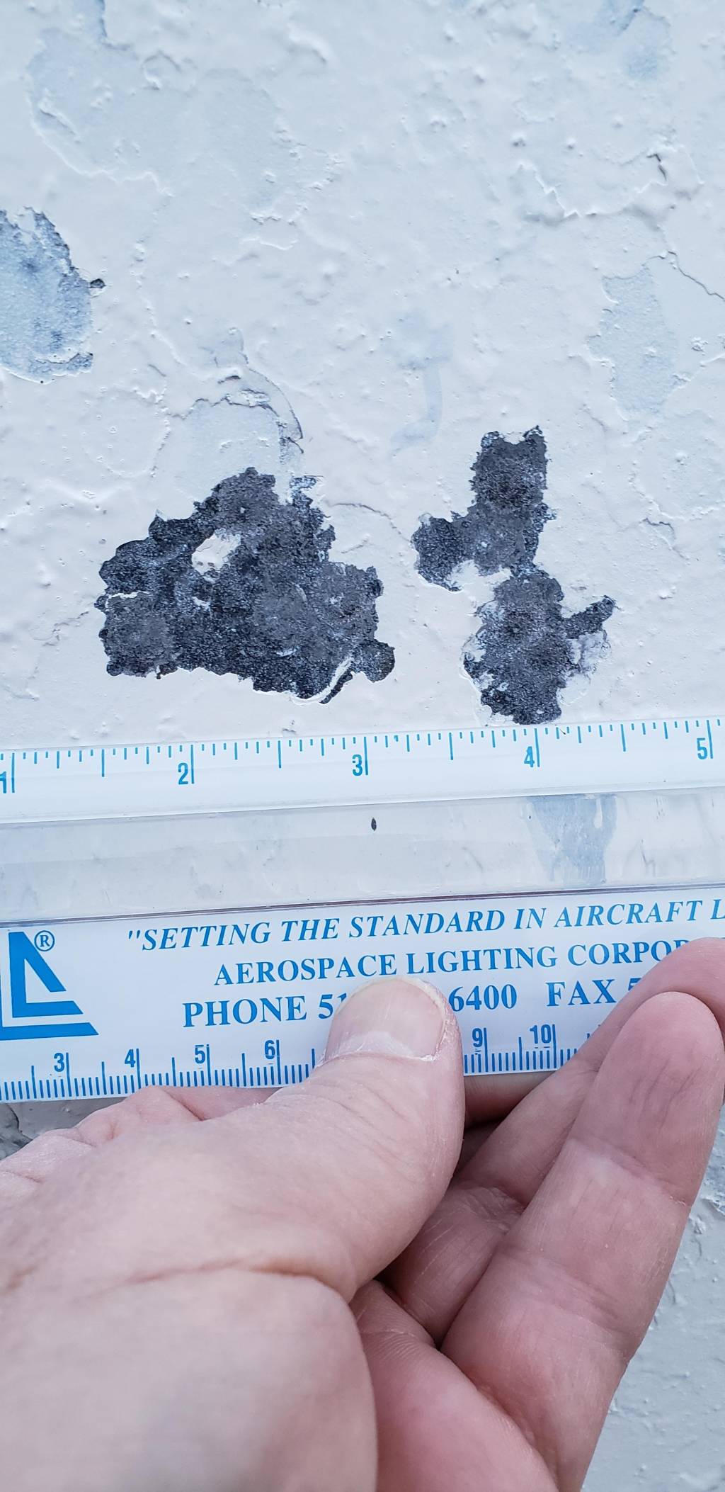

Got my V3 yesterday just before dark. Brown Santa got here just in time for me to mount a scope and head to the back porch.

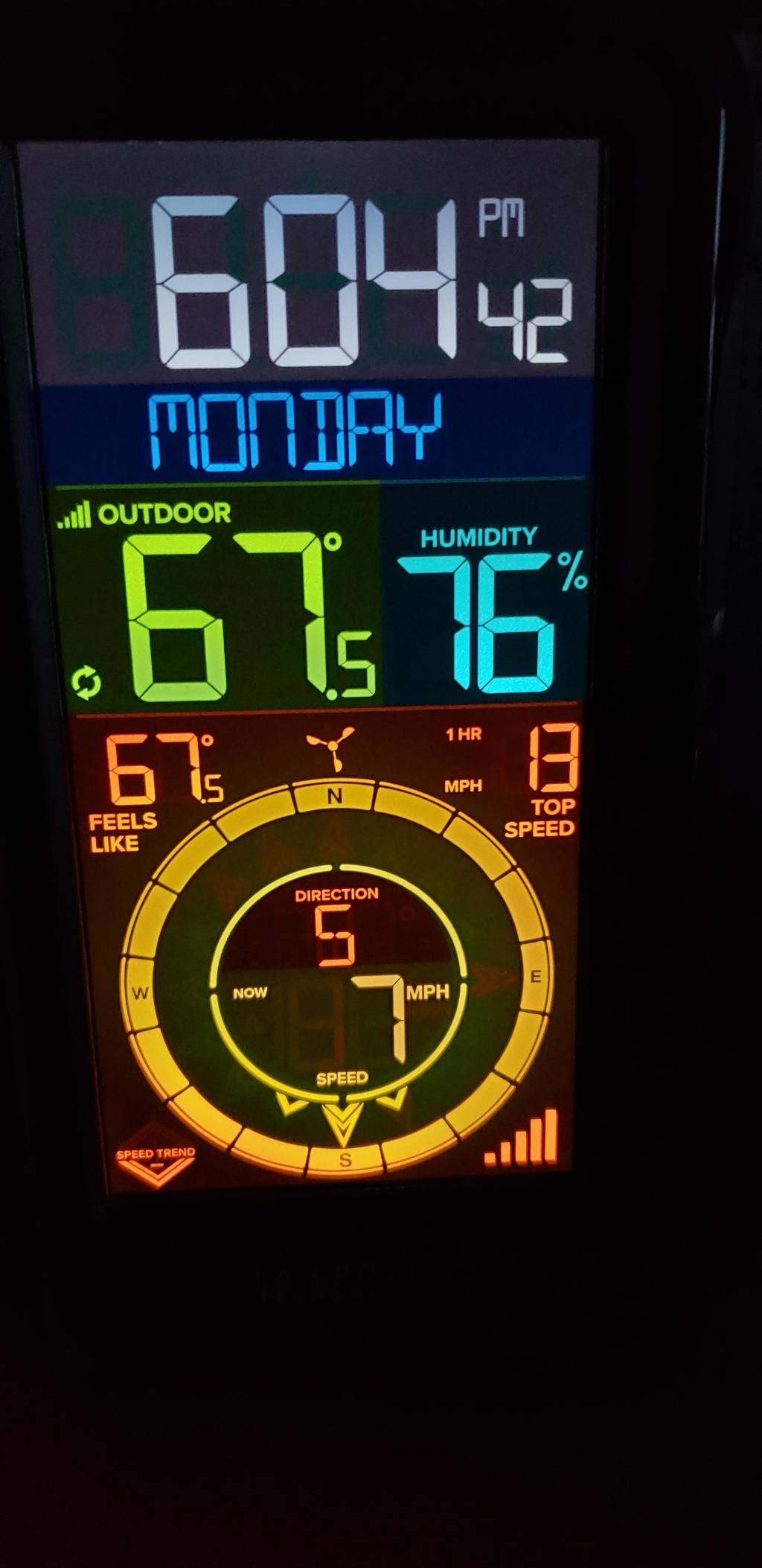

I didn't clean the barrel, shot 3 shots at 55 yds to find POI/POA, made a quick adjustment on turrets and turned to the 100yd target. .22 FX 18gr. Winds 90 degrees right to left 7 to 13mph. Closer to 7mph during this session. Here are the quick results. Only 2 mags thru the gun total so far, 12 shots at 100yds. 9 in the group to the left and 3 in the group on the right. Two groups due to wind dropping off during the 3 shots. Not bad for a .22, straight out of the box!
View attachment 200868View attachment 200883View attachment 200896
Congratulations!!!!
Airgun Technology rifles are the very best buy for the price !!!
Once you know the accuracy of these rifles very few seem to be able to match with them.
