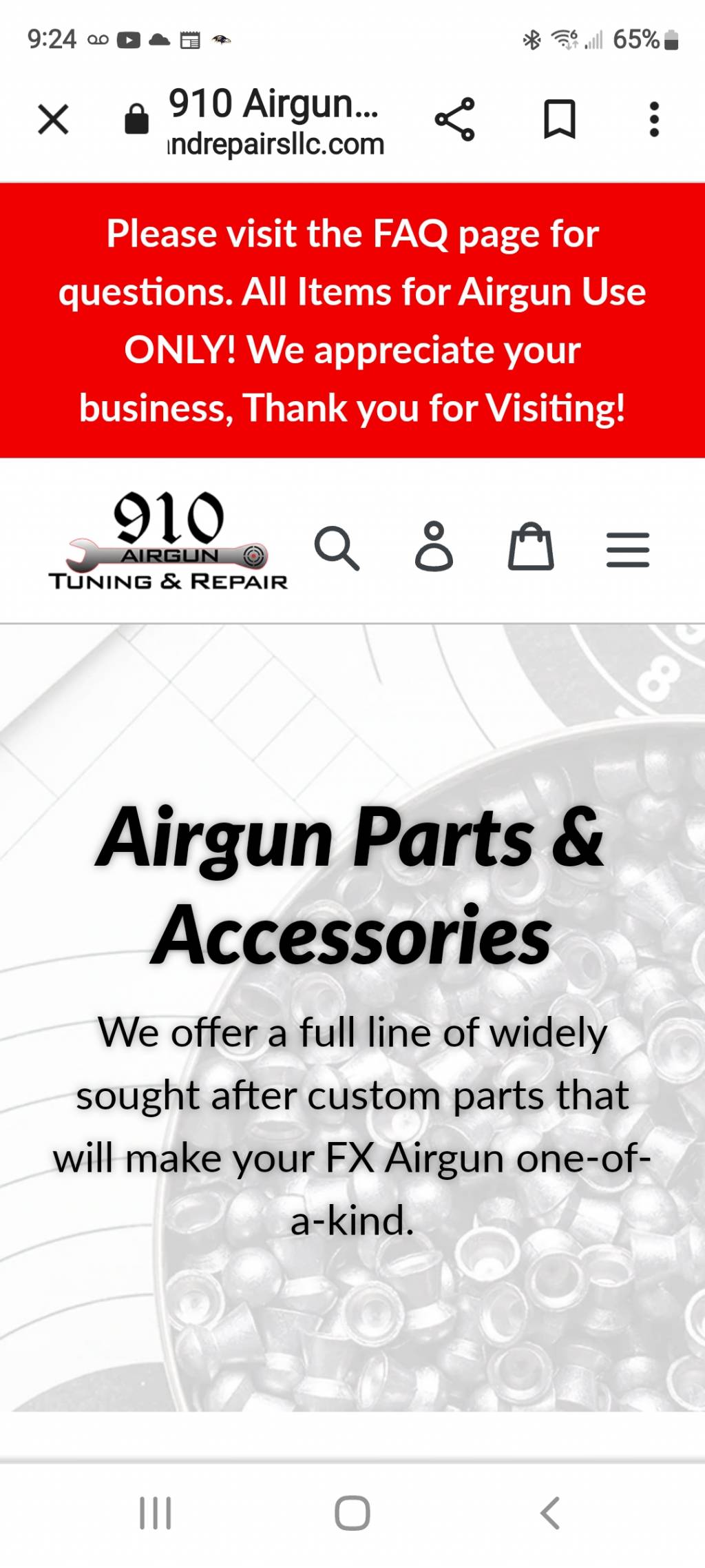

I would send Newman an email @ 910 tuning. Curious to what your reg pressure is set at.
