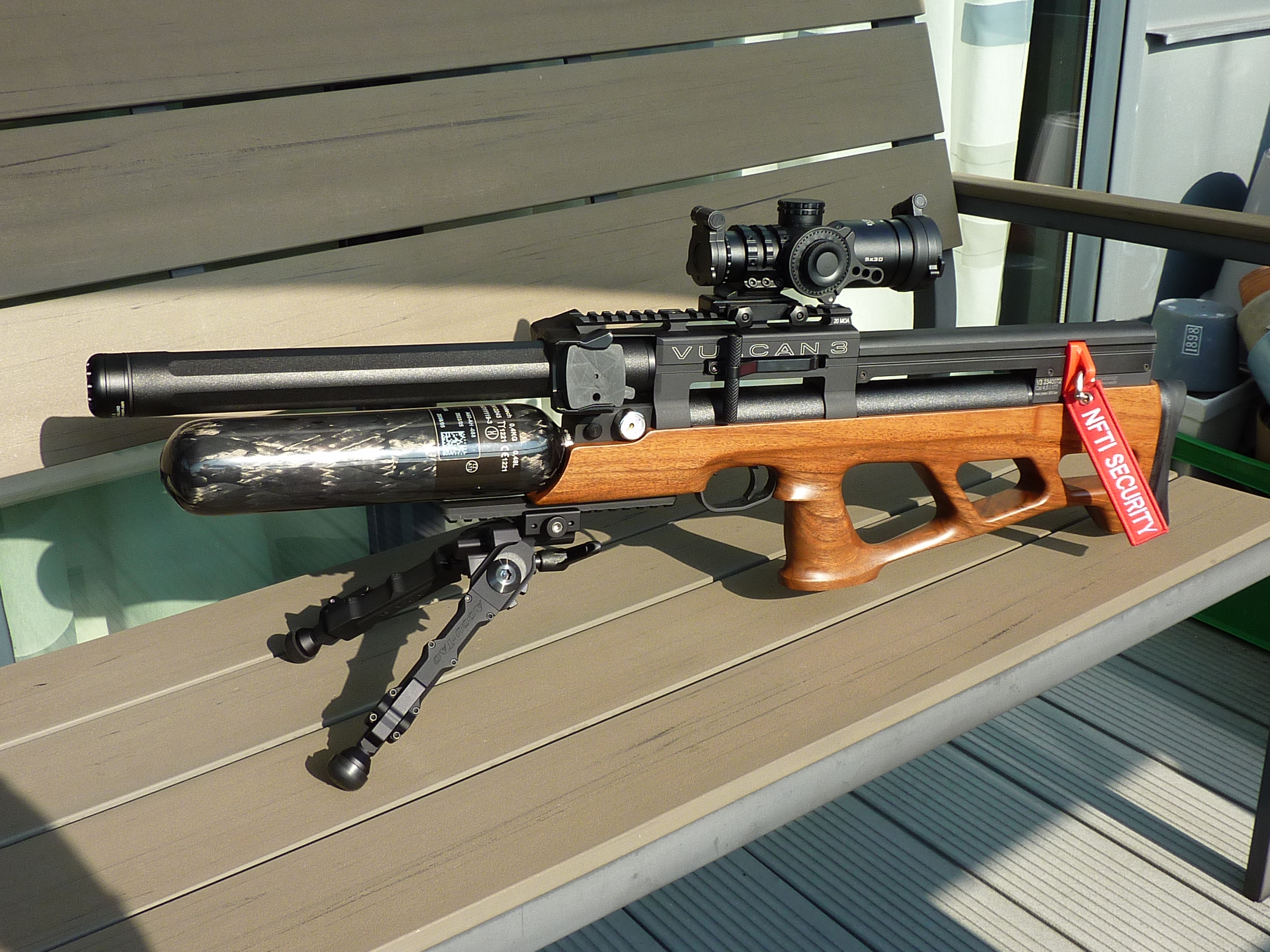

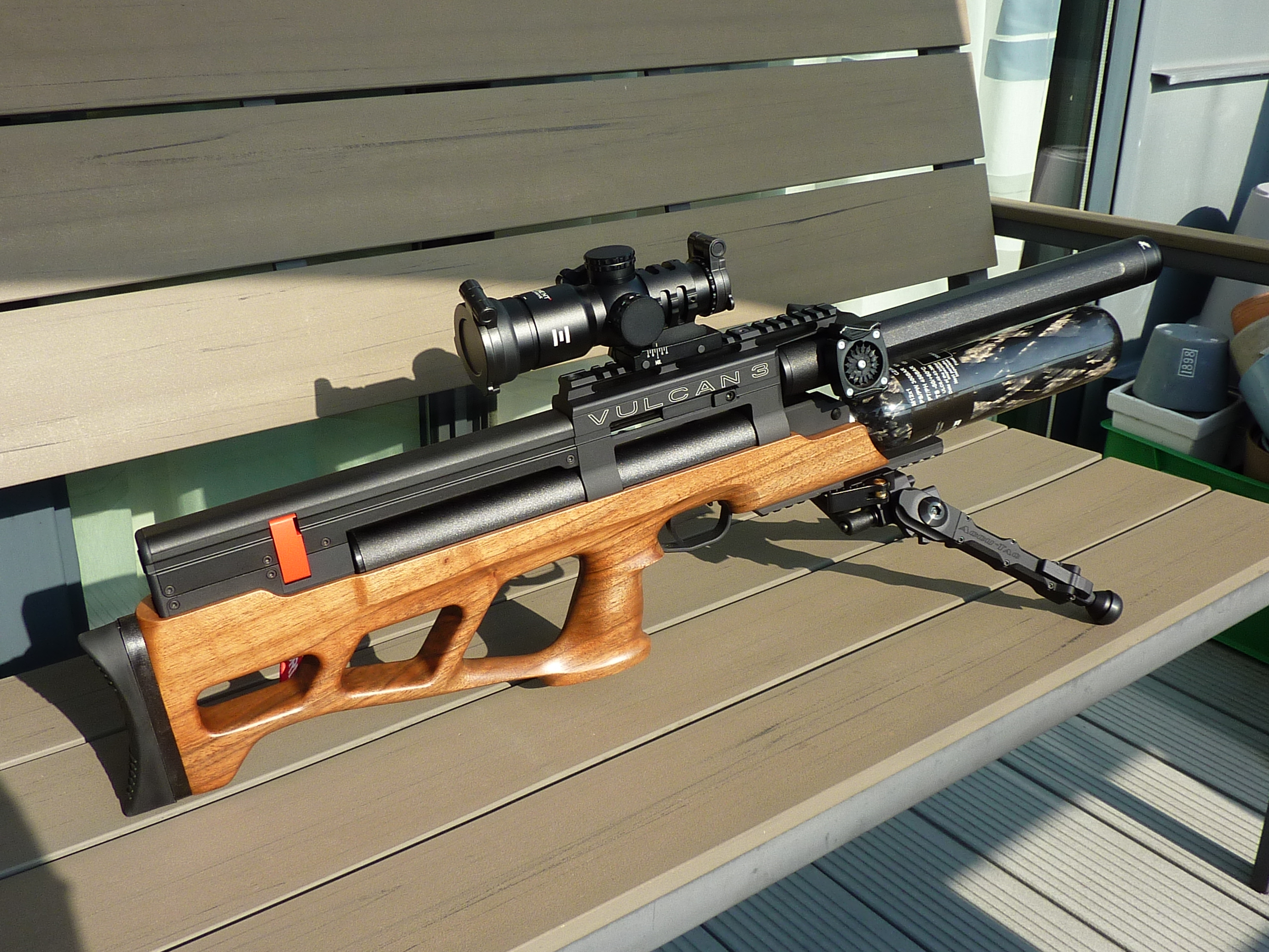

Shoots great with jsb 10.34. I sold it a while ago, and now shoots with a Vulcan 3 also a super rifle.

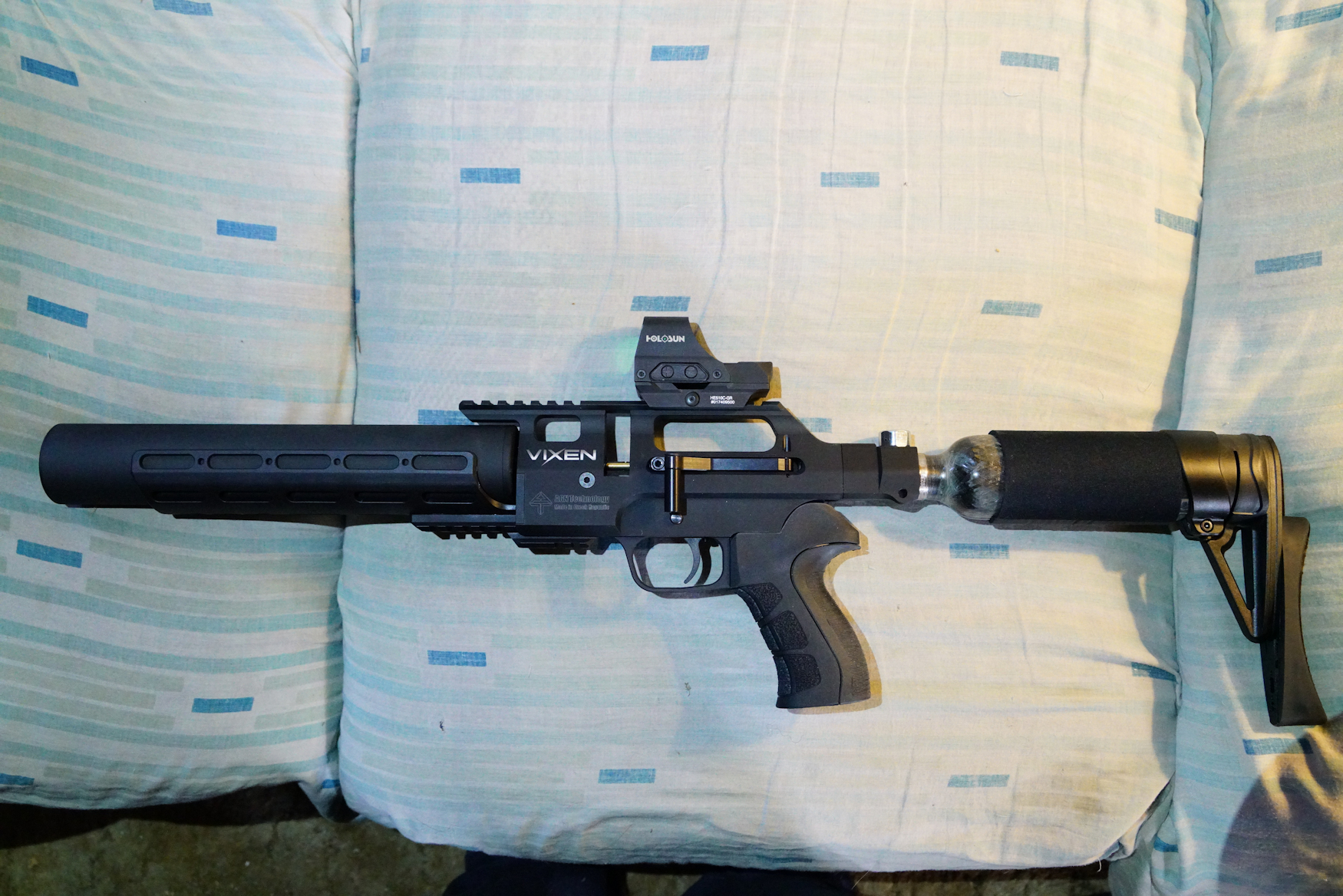

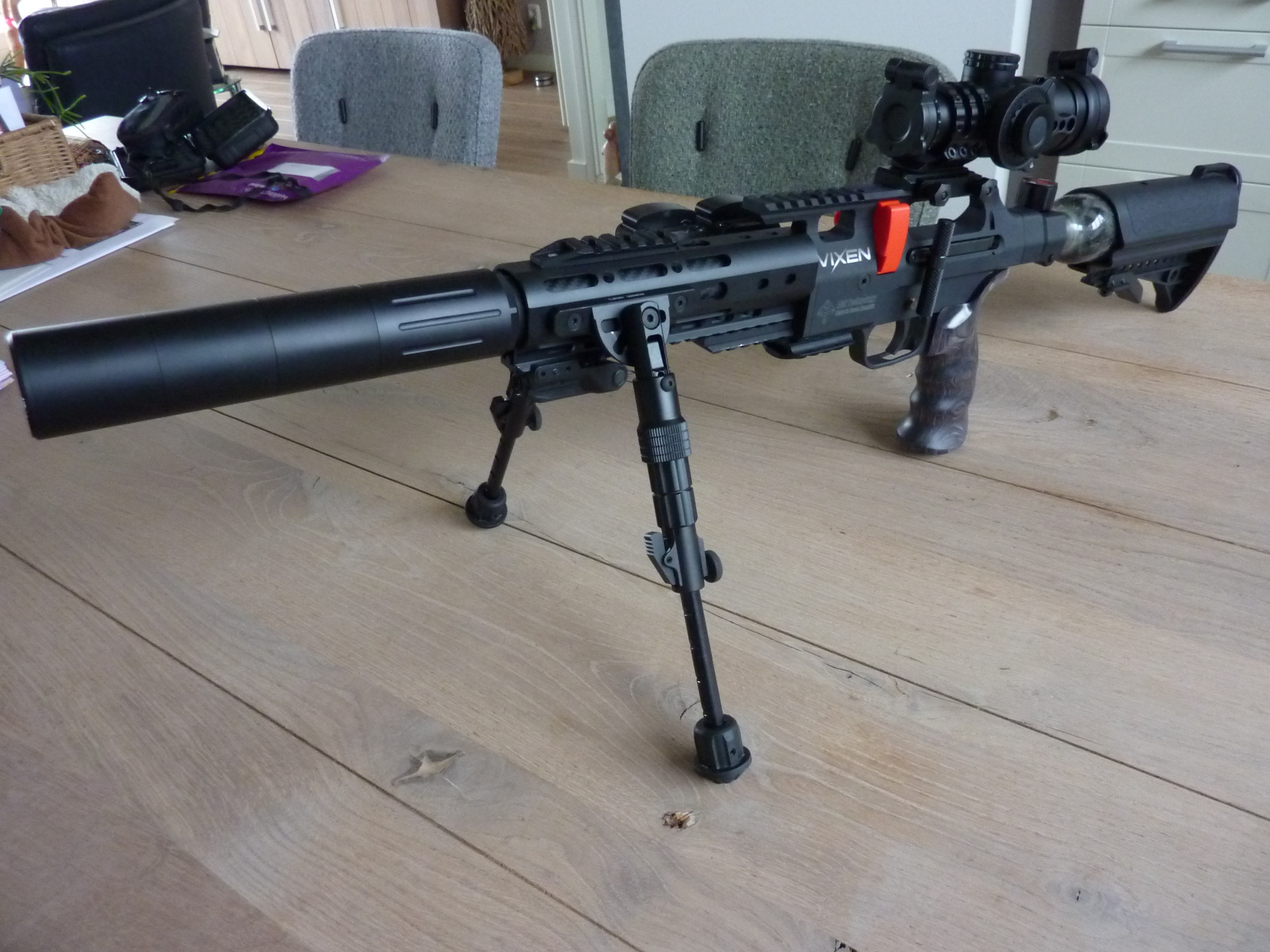

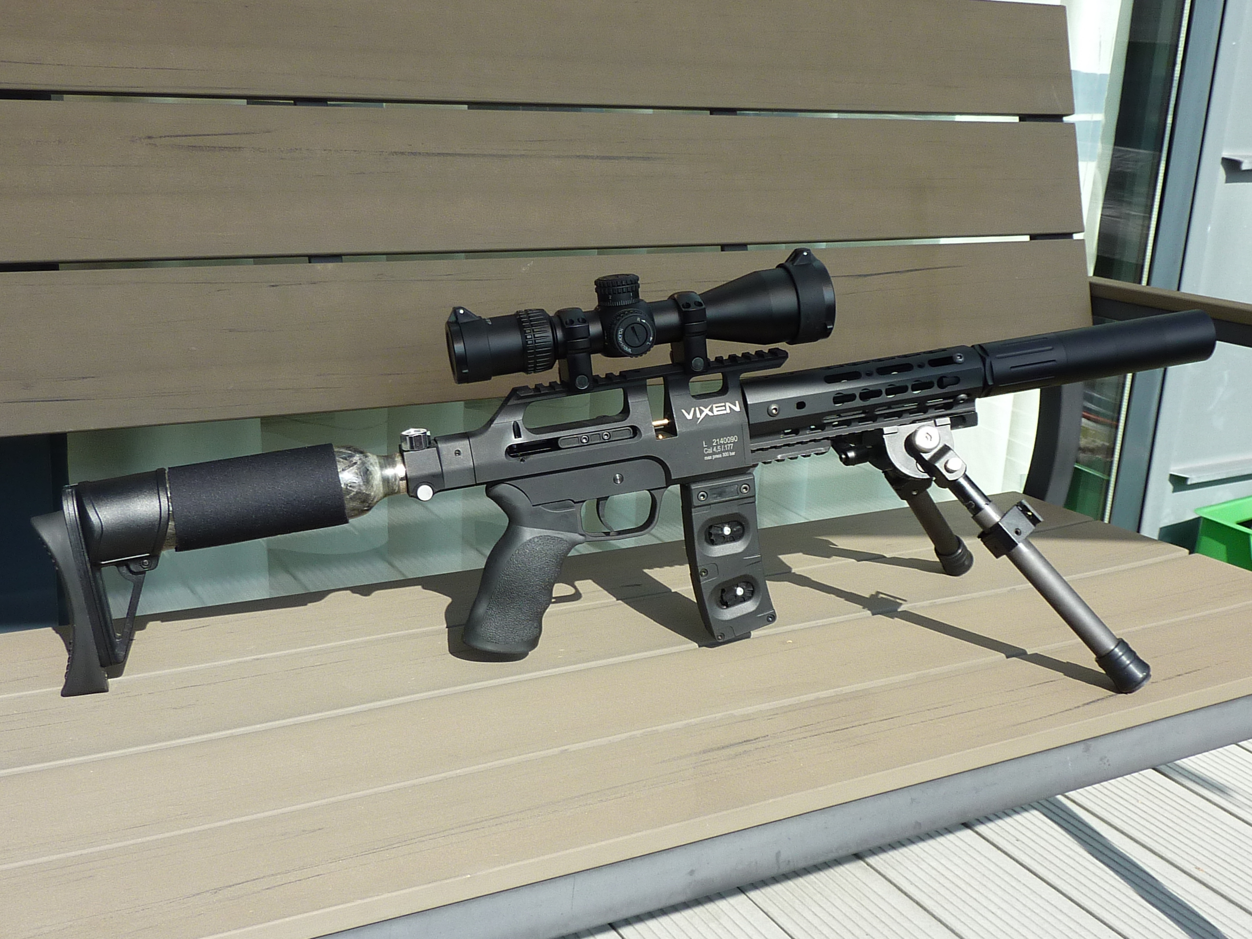

Sorry for my bad Englische bud a Picture of my Vixen Short .177
Greetings Cornelis
Hello georgeb94,
It is a great rifle and you can modify it a bit to your own liking.
Greetings Cornelis

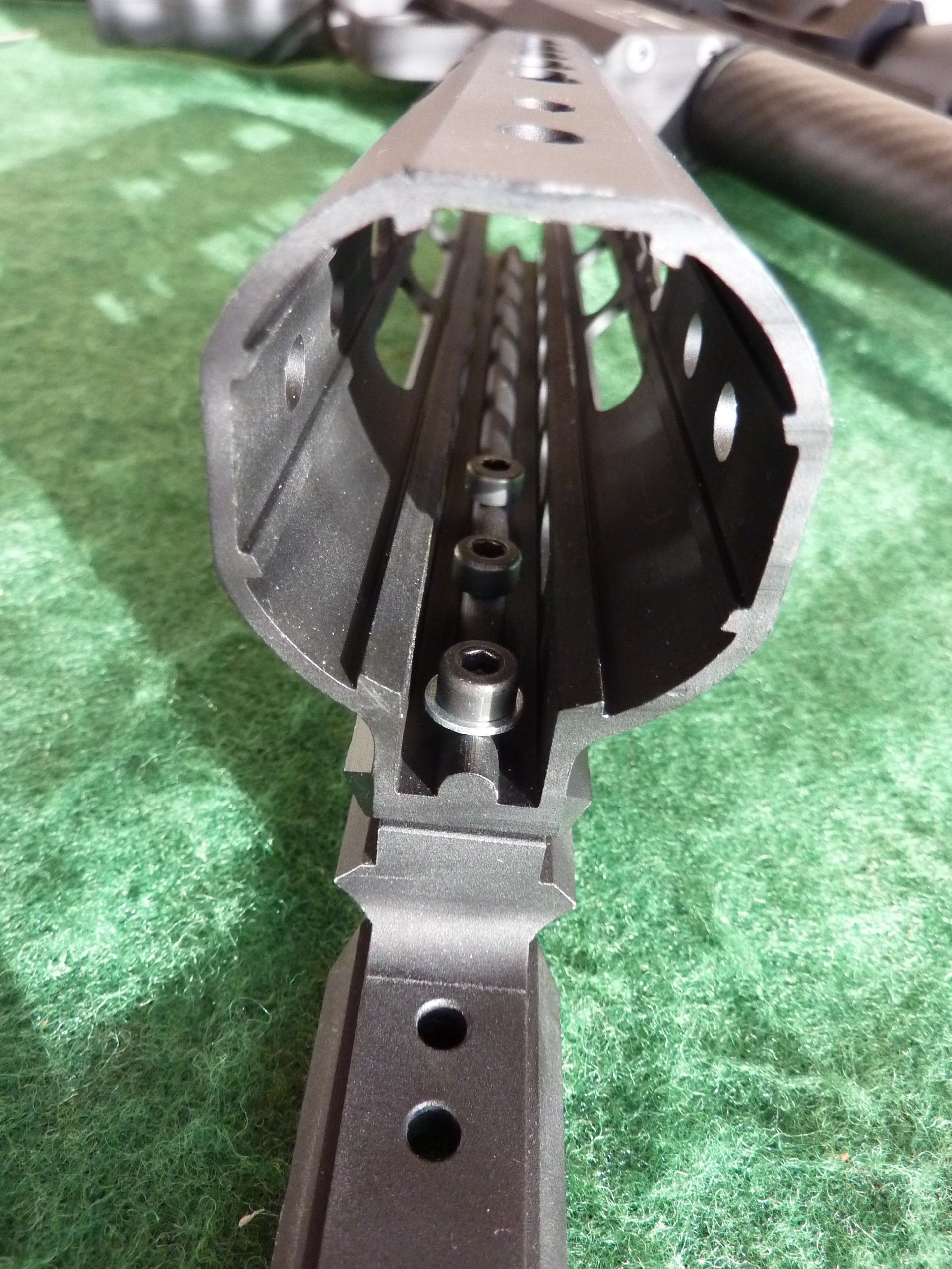

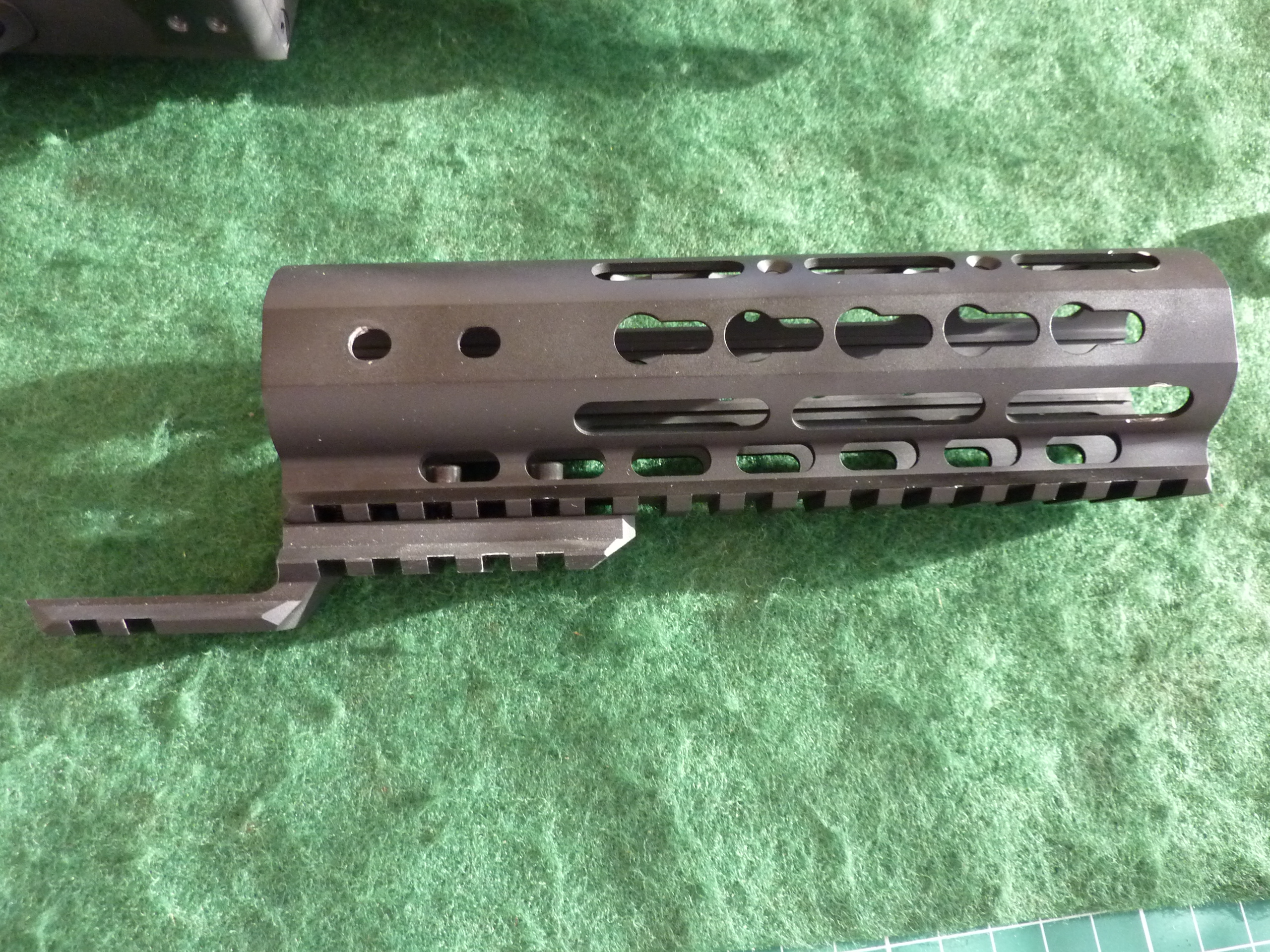

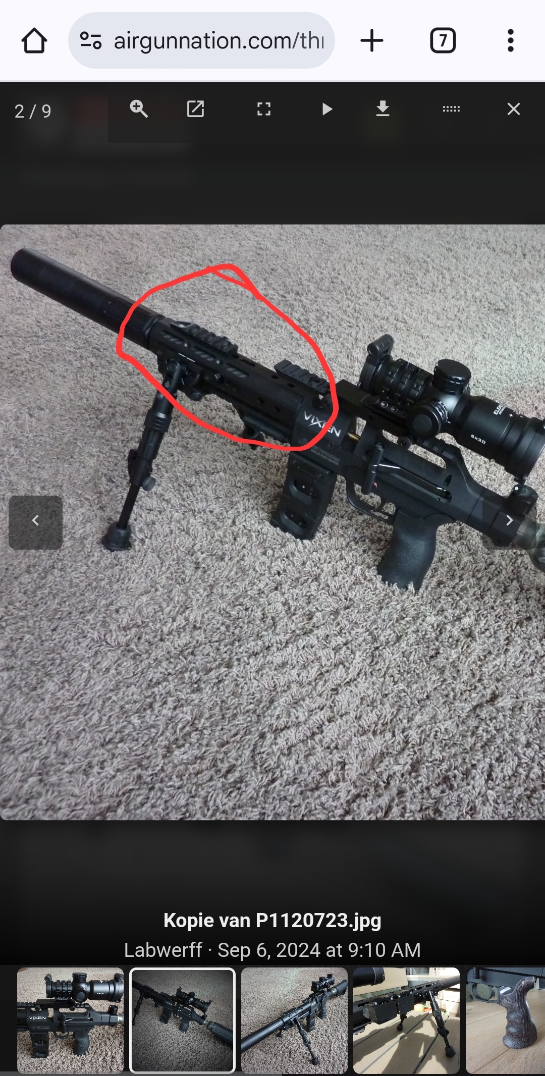

It looks amazing! Could you tell me what the rail over the shroud is called?
Hope you're enjoying the Vulcan 3! Looks like a great piece of kit.
Its a Handguard for airsoft 7"
Example:
You can buy them in black or tan for example. on Ebay and in an airsoft shop

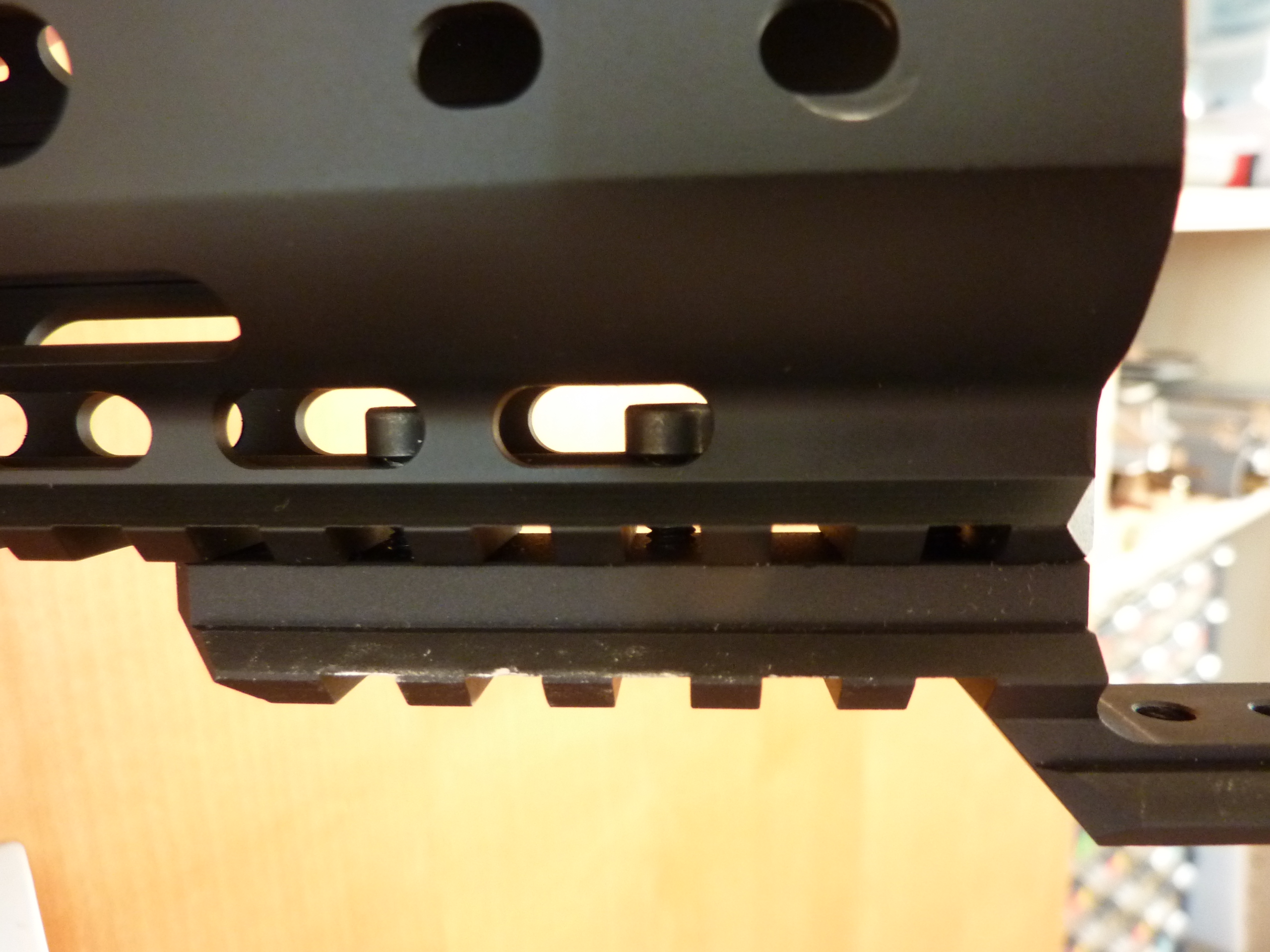

drill 3 holes (see photo) and screw them from the inside. as a silencer a Huma 40mm m14x 1.25mm directly on the barrel.
Greetings Cornelis
Example:
Greetings Cornelis
Legend! Thank you my friend!

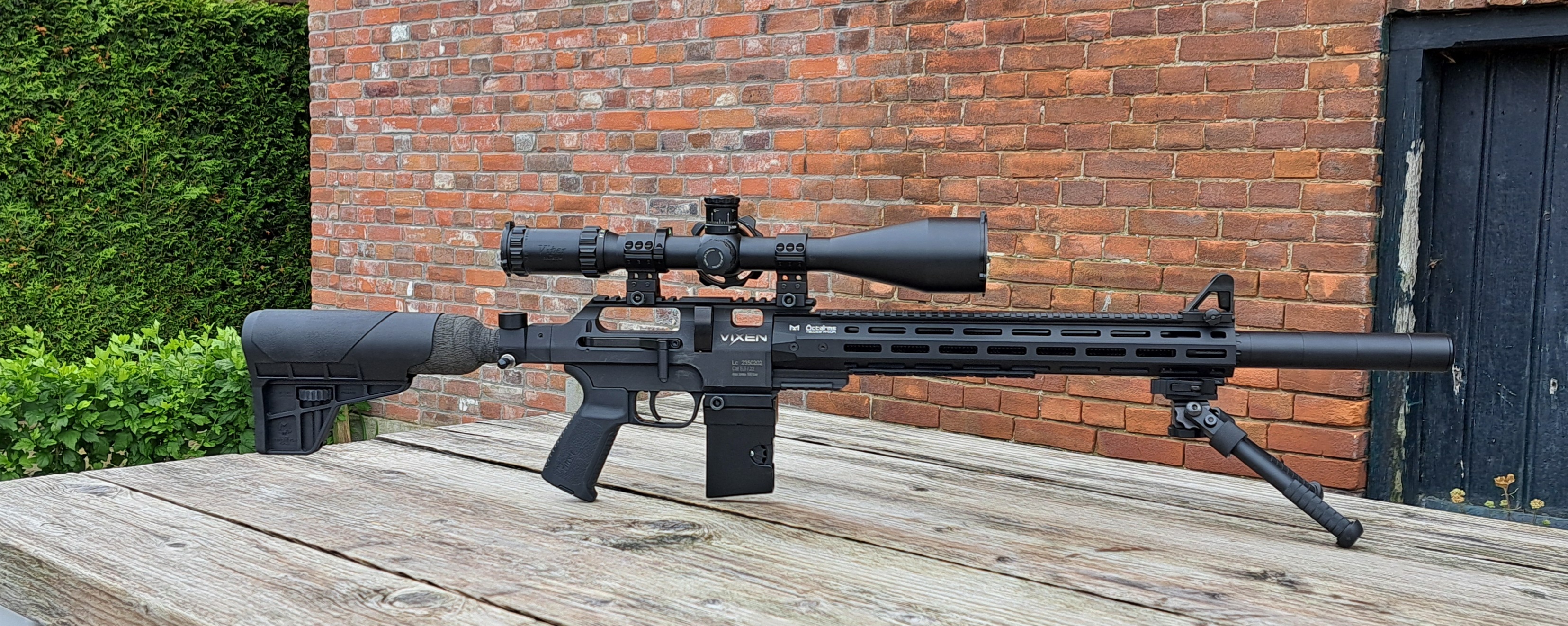

I have the long version in .22. I shoot it in the EBR Speed shoot because of how close the bold handle is to the trigger, and the 12 round magazines. I shoot the speed shoot and the Steel Chainage with it and the only problem I have had is when I try to push my times, I will short stroke the bolt. This will load a pellet but not cock the hammer. ROs will look twice when I hit the target with two shots! The gun is very quite and the RO will often have to tap the timer to record my shots. Our Steel Challenge matches are 100 shots and the Vixen will make it, but I usually refill before the last stage just to be sure.
I have shot it once in a 50 yard benchrest match and I felt I didn't give anything up to my usual BR rifle which is a 1 MOA rifle at that distance.
Ron

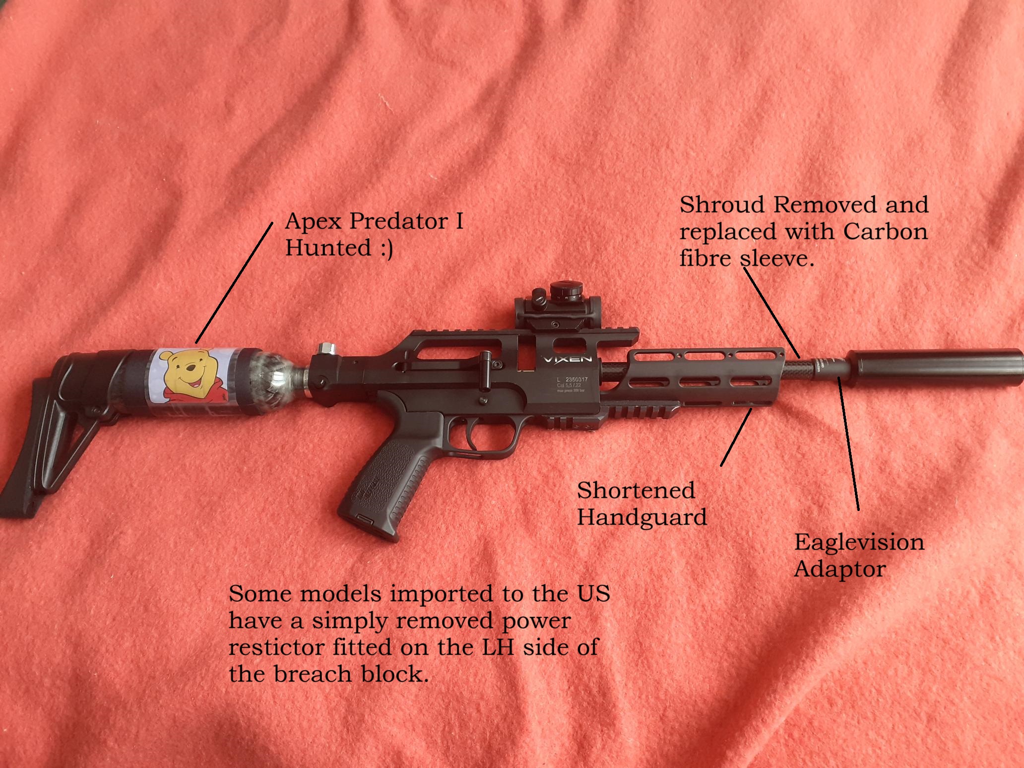

My 22 Cal Vixen short is superb, consistantly accurate, massive shot count with 300 bar fill, nice magazines, very well made, Light, Compact, Easy for Americans to derestrict. Its a joy to EDC with or without sling. Mine only has a 25 mm red dot on it but the critters keep falling. I removed the shroud on mine which shortens the gun substantially, slightly offset by fitting a shorty moderator. I sleeved the barrel with a carbon fibre tube, and shortened the hand guard. Mine love AIR ARMS Field 16 grain diabolos and AIR ARMS Field heavy 18 grain diabolos. But will eat most ammo happily enough. Mine shares equal first place with my Brocock Ranger. Being an ex light infantry NCO I'm obssessed with weight saving, I hate anything over 5 1/2 pounds so the Vixen ticks lots of boxes for an EDC rifle.
