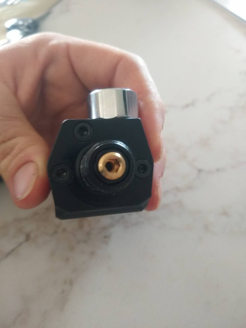

Great little guns. Yes there choked barrels. Reg adjustment is very straight forward. I did a post about it recently. Did a guess and check on it though when adjusting. Basically degas gun, unscrew the bottle and reg is right there.
I'm assuming you turn the inset allen clockwise to lower psi correct? Good picture.
Correct! Counter clockwise will increase reg pressure. Clockwise with decrease. You will of course need to dial more hammer spring tension after you’ve increased reg pressure to see a gain in fps.
make small changes and test. The adjustment are sensitive. Small adjustments can make significant changes. 1/8 turn can change reg pressure by 15 bar.

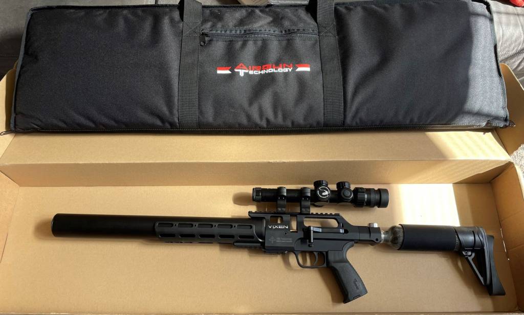

The .22 Vixen arrived this morning from Krale. So funny they always beat every other AG shop in the US for shipping time. Ordered soon after I started the thread. When I can log off for the day, out I'll check it out. Box looked like it sat in about 4" of water and at least one end of the outer box is destroyed..Hope they put it in a hard case but I doubt it. UPS.. sheesh
