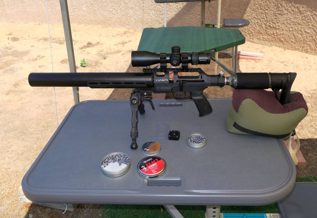

Beauty is in the eye of the beholder, but to me the Vixen looks great. It seems to be very well made and solid - yet it also felt as light as I wanted it to feel. I will likely change out the IWI pistol grip with a rubber coated AR grip, just because I like the feel a little better. The Vixen magazines aren't my favorite to load, but they are serviceable and function just fine. Plus it is nice you get 2 with the gun. Don't think I am going to pop for the magazine holder since I'm going to try and keep the weight down on this one for carrying, and shooting off hand.

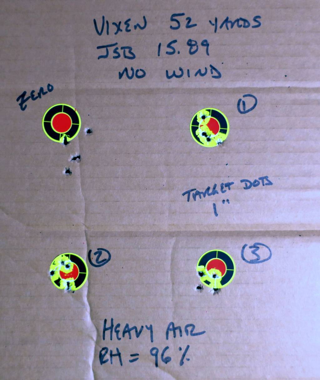

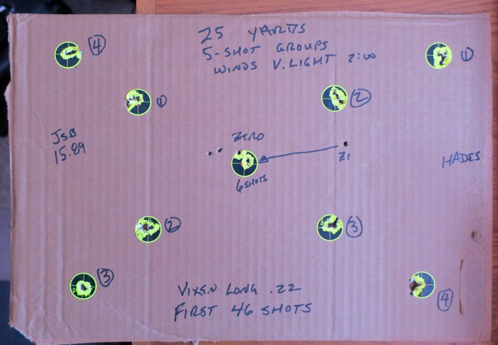

I put on a Veyron 3-12x44 FFP due to its small size, low weight, good range of magnification for hunting, and I also think they have some pretty clear and bright glass for the price. Aired it up this morning (it had been delivered on Friday but I had been away all last weekend), and went out to zero at my 25 yard range. 5 shots got me zeroed and I proceeded to shoot 4 each 5-shot groups with JSB 15.89's. Seems very promising with all groups at about .4" or less, and my best being one ragged hole of about 0.15" CTC. Stick-on target dots are 1" in diameter.
Switched over to the Hades pellets and put one more shot onto the zeroing target to see where they would impact. Landed in one of the existing holes, so no re-zero for Hades. Shot 4 each 5-shot groups with the Hades, and groups were about .5" with my best about .3". Definitely will work for squirrel hunting inside 50 yards.
Then some shots over the chrony showing the 15.89's averaging 898 fps, and the Hades averaging 891 fps, both with about a 10fps ES. I'm just fine with 28 FPE at the muzzle. Seems that if AOA did any significant set-up with the gun, they did a good job.
