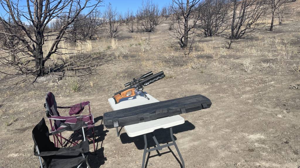

It aired up, shot two pellets through both sides of a cardboard box. Next day, only a mechanical sound presumable the hammer. Yesterday, shot three pellets though a box again, I am going out now to shoot it over a chronograph. I will let you know how it goes. Dave

Well, I am getting pellets to shoot out. ( at 188 to 196 FPS ) something is definitely wrong. This was with 250 bar in the tank. Aired it up to 290 bar and chronographed a few more shots , no change, ..188 to 194 FPS. The manufacturer emailed me back. They said to air it up with the bolt open, safety on, and the tank will pressurize. Instead I went with the scuba tank fill and the rifle maintains a steady pressure. Any ideas?. Thanks, Dave

Yikes. Yeah something is severely off. My first guess would be that something in the hammer spring mechanism is way out of adjustment and the hammer is hitting way too light. If you're inclined to work on guns, give this guys video a watch:
https://www.youtube.com/watch?v=xL5spcqzlxI
He does a great job explaining the whole gun during the teardown.
What pellets are you shooting out of it?
