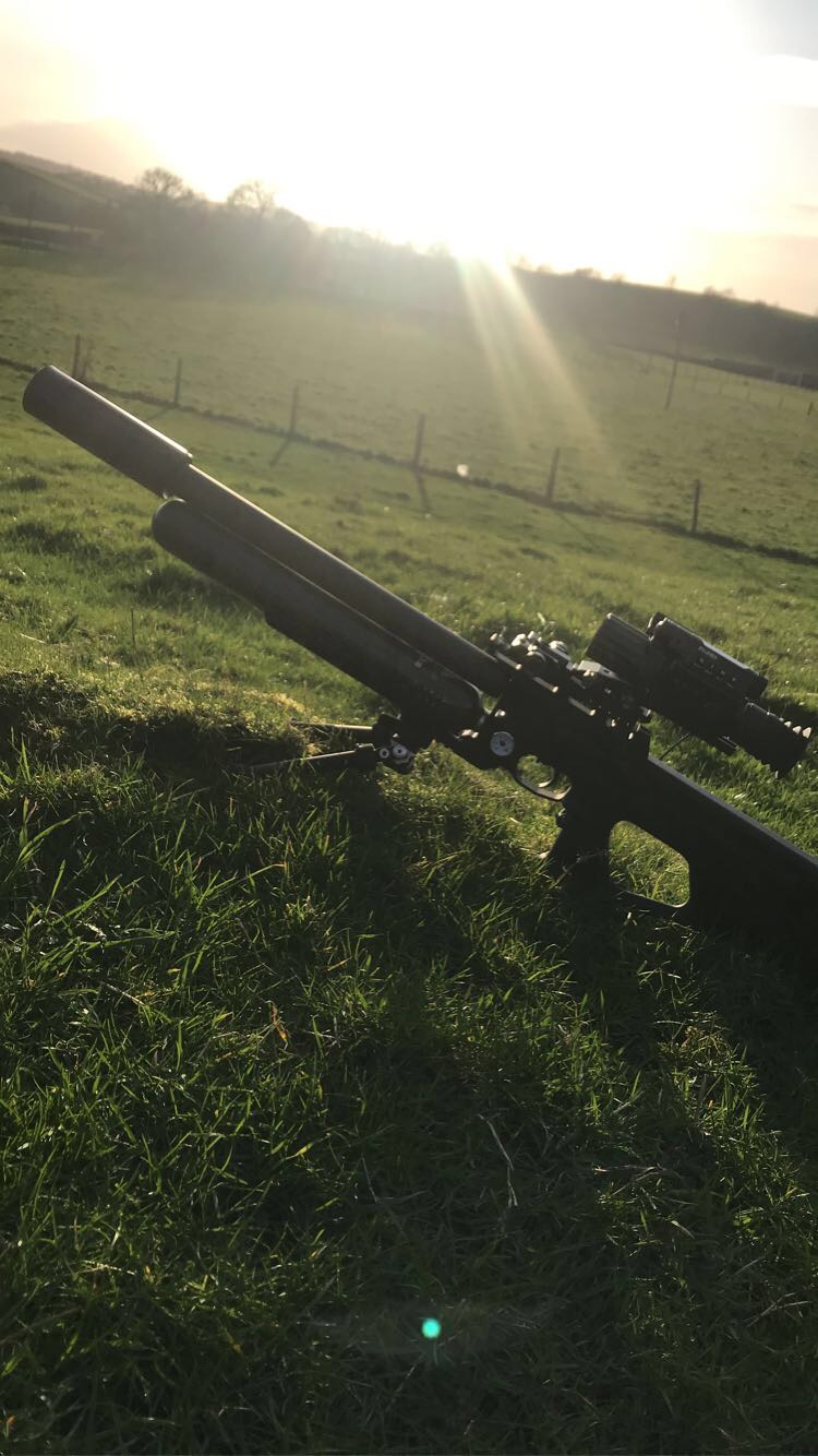

Here’s a pic of her with the Pard scope, and DonnyFL Ronin:
Make sure the shroud is tight and that it's not touching the bottle. The hammer spring adjuster is under enough pressure that it should not fluctuate like many of the wildcats do/can, but if the locking screw is loose it could move outward over time. Clean the barrel and test that first.
