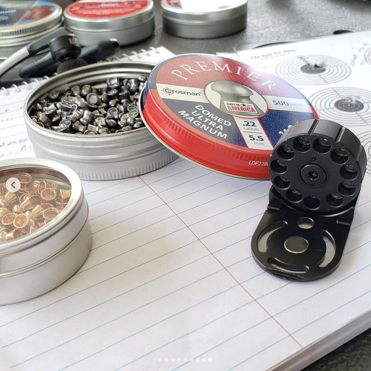

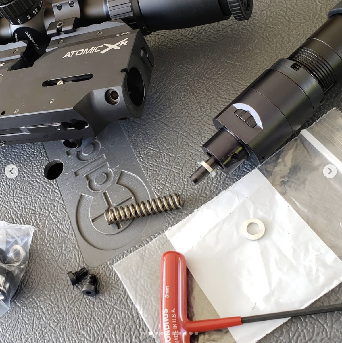

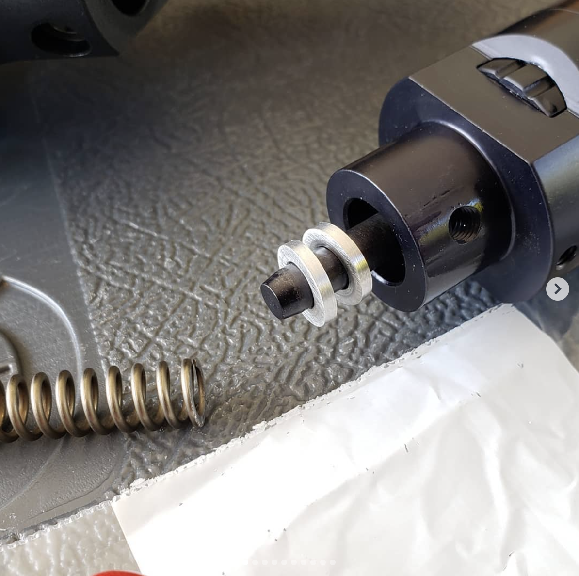

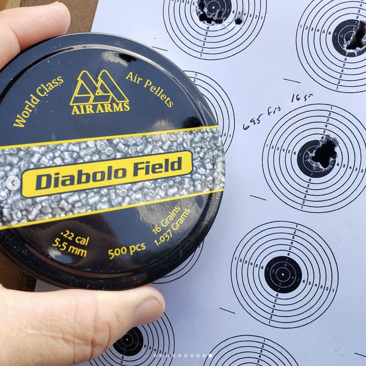

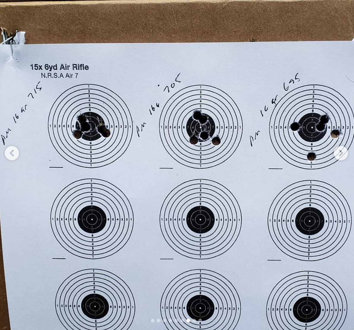

"I put in the work, so I know 🤓... 14.3 to 16.3 gr pellets are what the NEW Atomic pistol performs best with AND in a VERY specific window of 695 to 720 fps, for about 17.5 fpe in .22 (with one HS washer installed). Dip below by 15-20 fps (675 ish) and 25 yard accuracy falls apart. Go above by 40-50 fps (740 ish) and it does the same. Now, I could tell that a few pellets that I was working with wanted to stabilize with more speed but they just couldn't get there on one washer. Today, we experiment with two 🤓"

Notice how the groups open up at lower velocity
Do you think the groups are expanding because of:
A. Pellet not traveling fast enough to stabilize?
B. Twist rate of barrel?
C. Moderator causing turbulence?

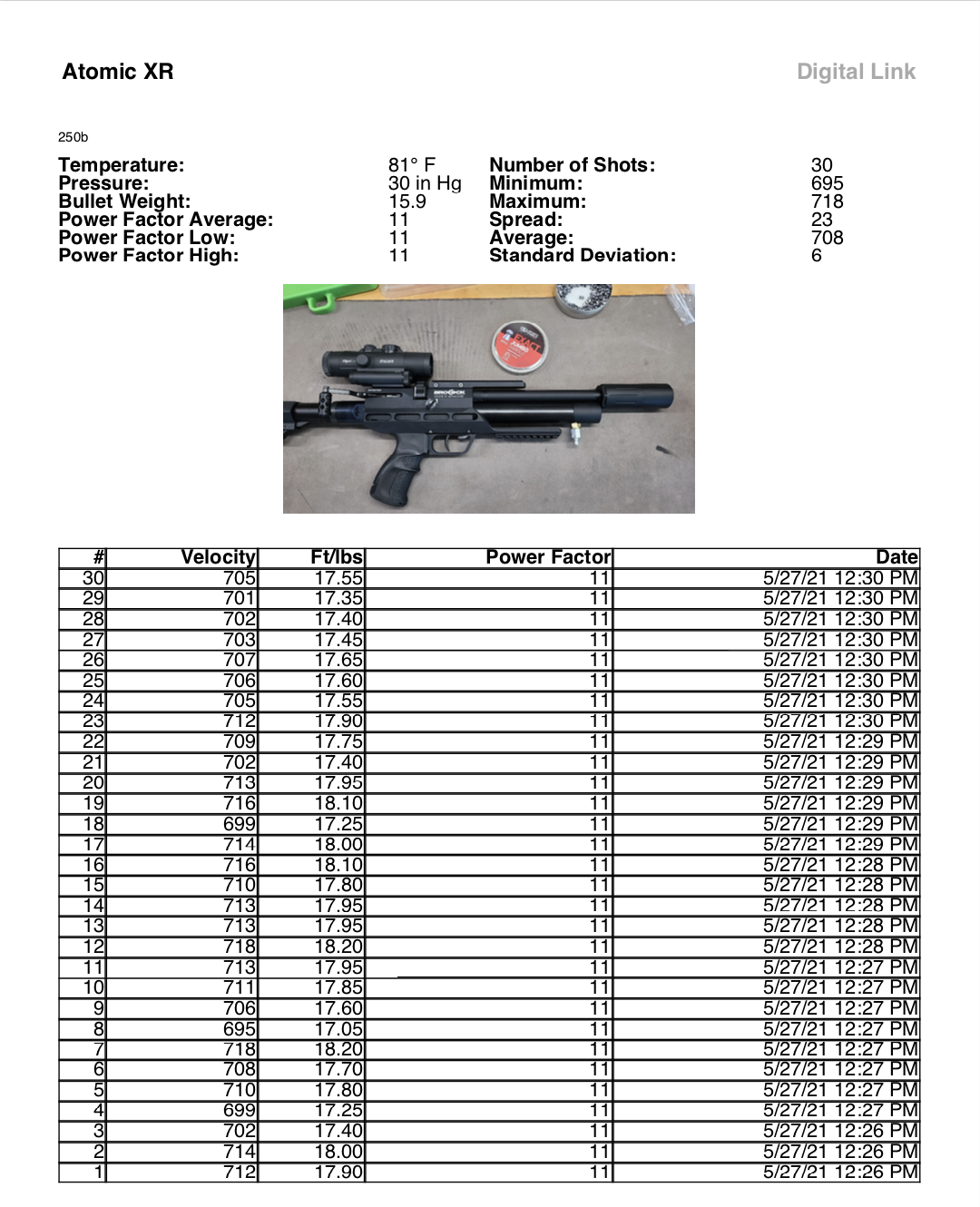

Power factor at 11, is that turned all the way up? Or does the power factor go up to 20? Getting three magazines per fill at high power is great but wondering if turning the power down to get more shots affects the accuracy.
Not sure what the ProChrono means by power factor? If you look to the left one column you can see the actual energy at the muzzle 17.25 - 18 fpe
