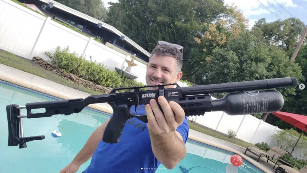

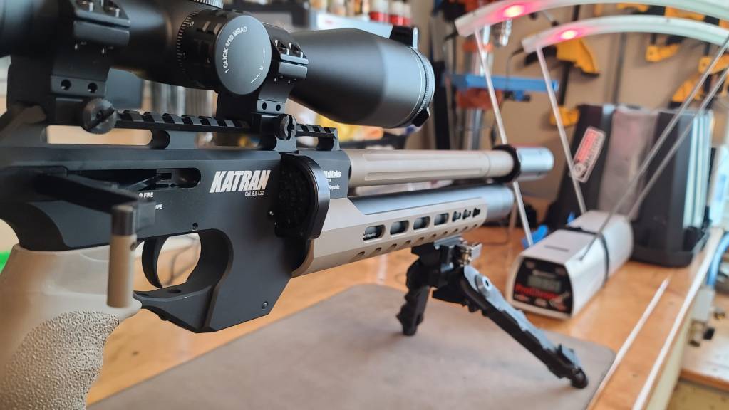

The Katran C (compact tube) and the Katran CB (compact bottle) both measure in at 30.5'' without a moderator. The most obvious difference is the tube gun holds 165cc's of air, while the bottle gun holds 300cc's of air.

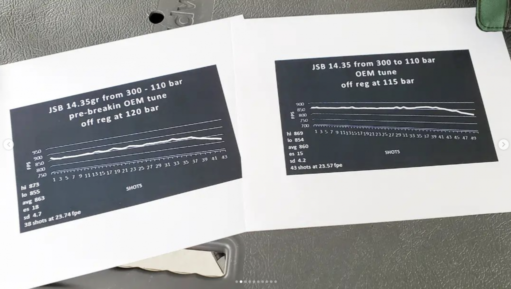

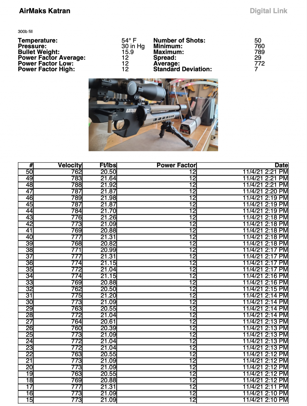

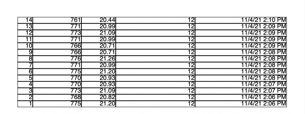

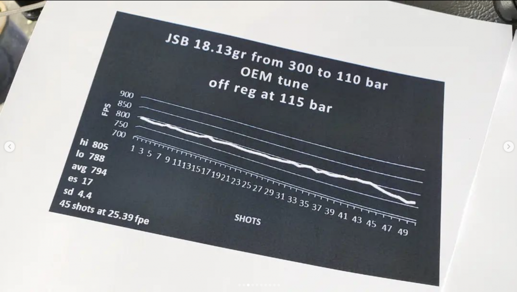

Steve has been busy as a bee doing shot charts with various weight pellets. I've only had the opportunity to chrony the 15.9g pellets, but I just received some 14.3g pellets to try as well.

My Katran C came to me tuned at 20 FPE, while Steve's Katran CB came tuned at 24-25 FPE. Make note how I was able to get 48 shots out of 165cc tube, while Steve got 43-45 shots out of 300cc bottle. Just goes to show how much more air is needed to push pellets just 5 FPE more!

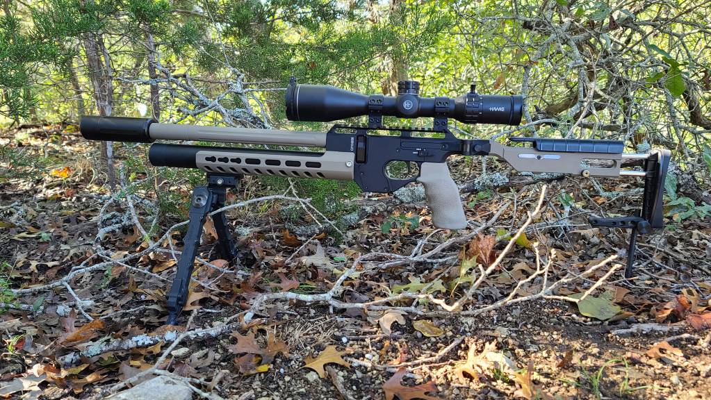

To make a long story short (like the Katran Compact's) these are lightweight, well-built, thoughtfully designed, compact PCP airguns!
