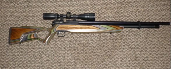

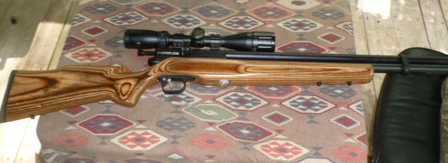

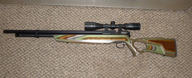

The standard butt pad on the Fortitude / Maximus is hard plastic and tends to slip/slide. I have used a slip-on style to get my preferred lop.
Any of the Boyd's stocks, inletted for disco will fit the Fortitude. The standard butt pad on them is rubberized.
