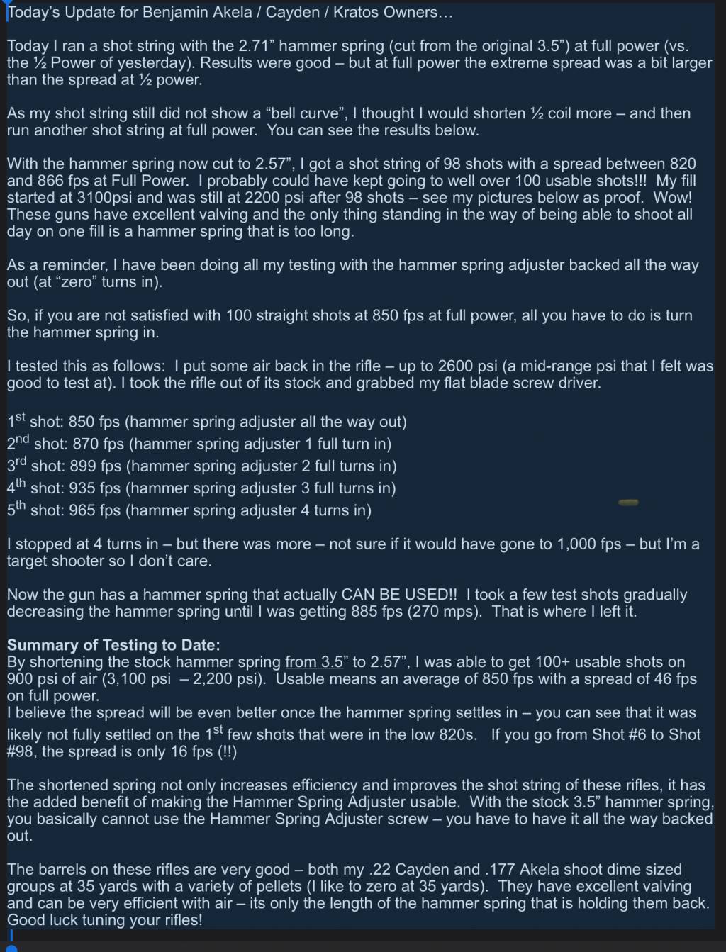

NO! As others have said, adding a Huma regulator will reduce power and add complexity. I have the exact two rifles that you have - Cayden.22 and Akela.177. This is a simple 5 minute fix as the stock 3.5” hammer spring in these rifles is too long. I’ve posted extensive info on this topic on GTA and I believe here. I will dig up and repost.
In the meantime, if you shorten the spring in your .177 Akela to 2.57”, you will have a flat shot string for 100+shots! (yes, I’ve run 100+ shot strings 5 times now with my Akela - no BS here - just fact). The string is FLAT - about 16fps spread - not a “bell curve” - now that’s really cool!
What is also really cool is that your hammer spring adjuster screw will now be usable, instead of backed all the way out. So you can then use your HS adjuster to dial in pellet speed.
This is a repost of my first experience with 2.57” spring. I’ve since confirmed 5 times that you will get a flat 100+ shot string with .177 Akela with 2.57” spring. I’m still experimenting with .22 Cayden, but currently get 60 shot flat shot string with hammer spring shortened to 2.71”.

EPG, Thats some pretty interesting results you got with only a hammer spring mod. I had seen your previous post and saved it and plan to do the same thing. Kudos for the great work, very meticulous! I’ll get started this week. The same thing should apply to the Stormriders I would think, and with their small capacity the horrible shot curve should get better.
