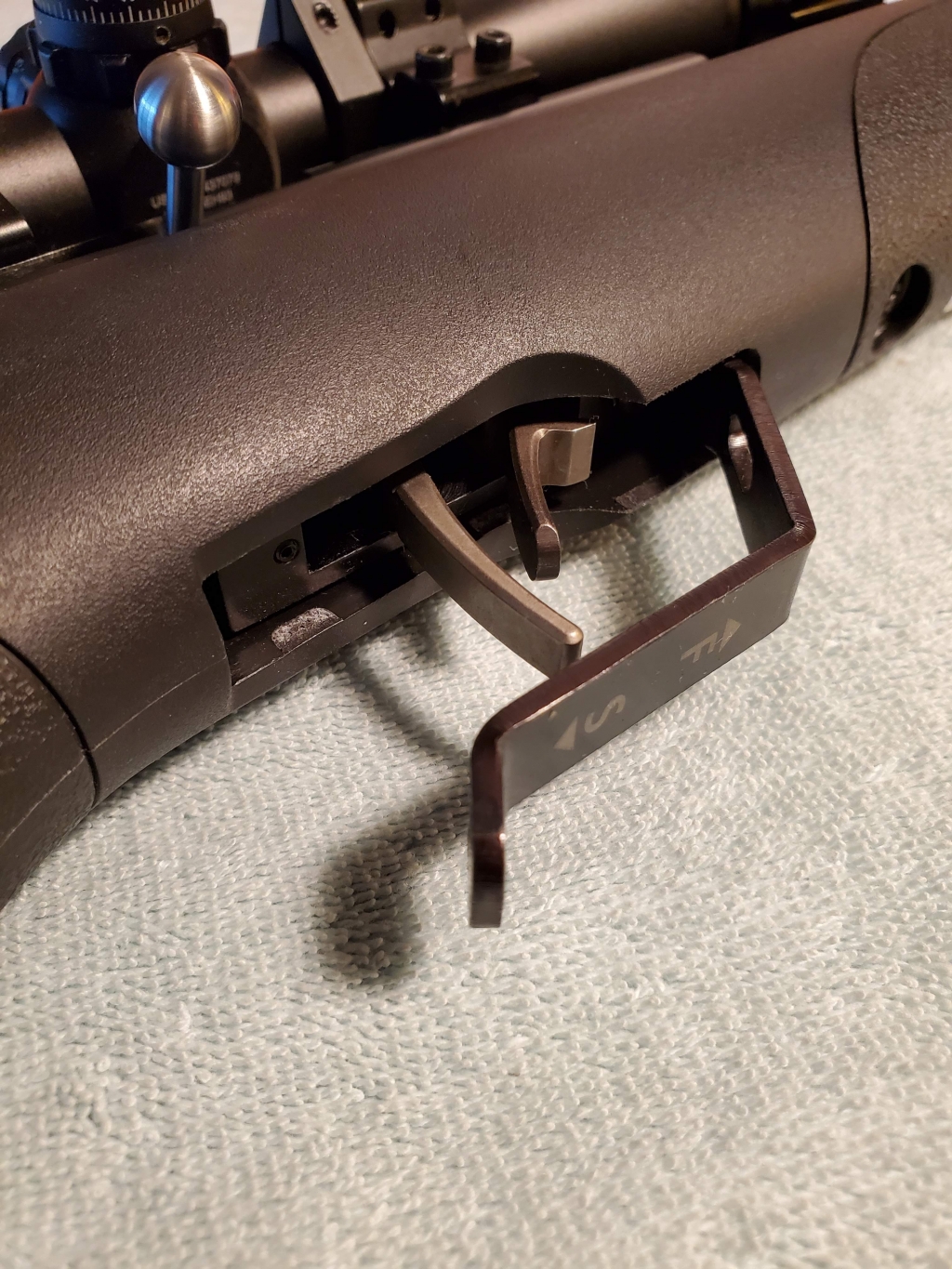

I personally didn’t care for the Baker trigger very much and went with the Marauder trigger on both my Discovery and my Fortitude. If you go the Marauder trigger route you’ll have to modify the Fortitude stock some. Not terribly difficult to do.
If you get the Marauder trigger group you can get a RAW trigger blade and install it. It's very easy to install after opening the pivot hole to 1/8 inch. I have installed them on all my Marauders and Armadas. It really improved the over all feel and I believe by being more ergonomically correct it improved my accuracy.
Thanks guys for the recommendations. I have searched the internet for a metal trigger, doesn’t seem to be one. Baker says their’s won’t fit. If anyone finds one, let me know!
