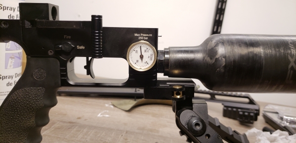

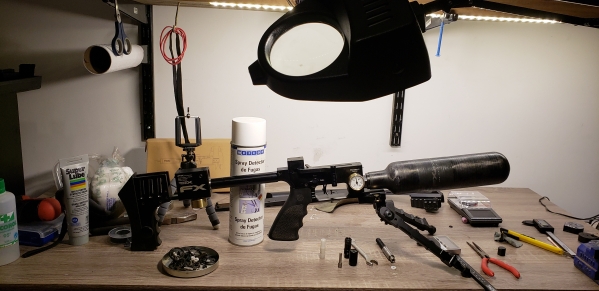

Not sure, i took everything apart and all.looks fine, I change the valvetube orings and the valvehouse (also took measures) too, but my theory (probably wrong) is since I change the valve seat, from 5,5 to 5,8 the delrin (or delron I am confused!) that seals the valve seat needs to settle...donno
I took a few dry shots and has been 1 hour and gauge is right on the spot tomorrow i will know.
Btw I have been order to build a new valvetube, with more cc, it has been tested tested here with good results. As you can see, I have little patience to wait for the power kit jaja...will post more info in the other mod related post
Here a pic
