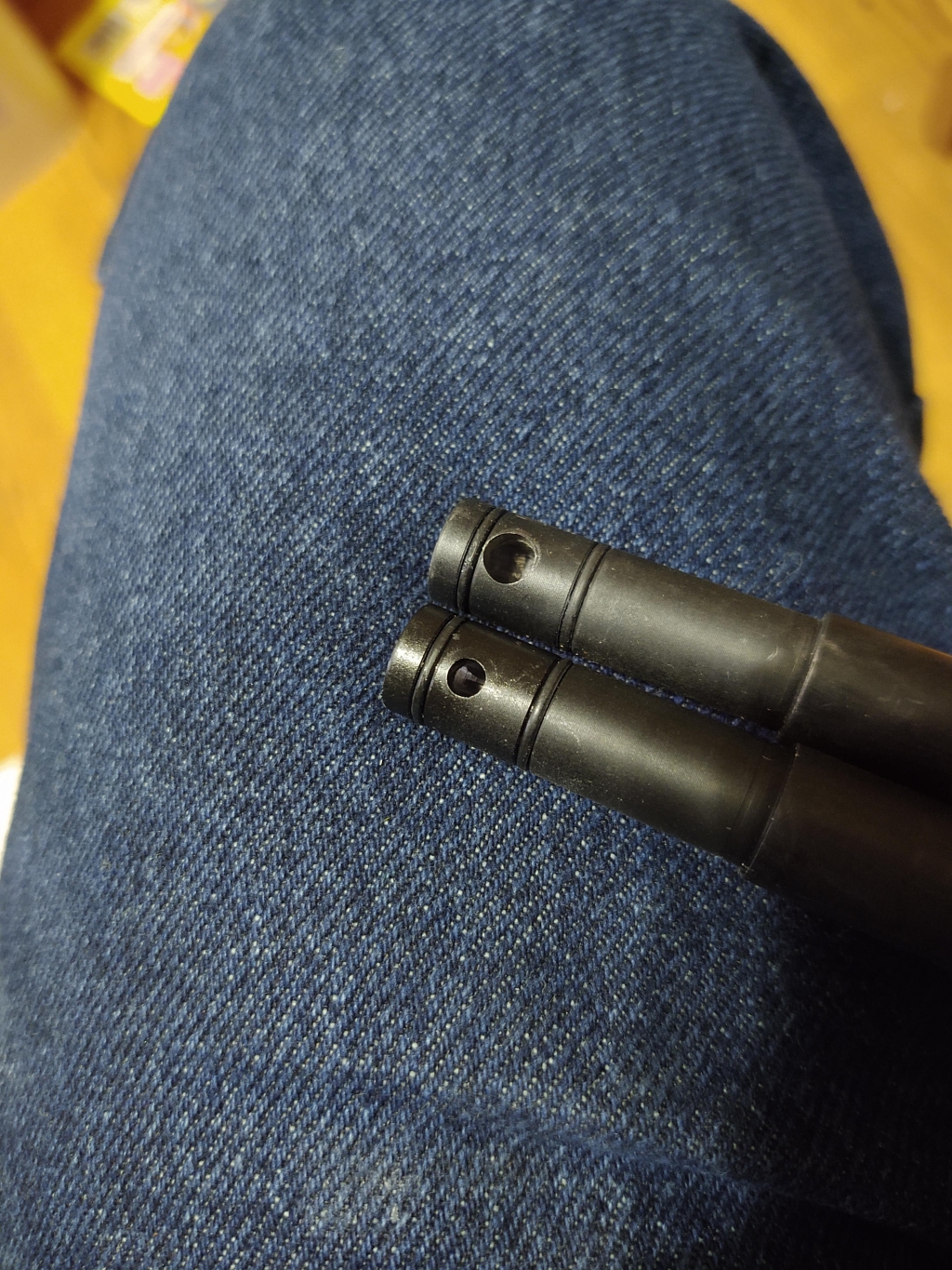

New barrel with the stock transfer port, old barrel with the Troy special over bore TP.
Easy to drill out, used two bits to reach 13/64 final diameter. Now the new barrel matches the Troy special.
