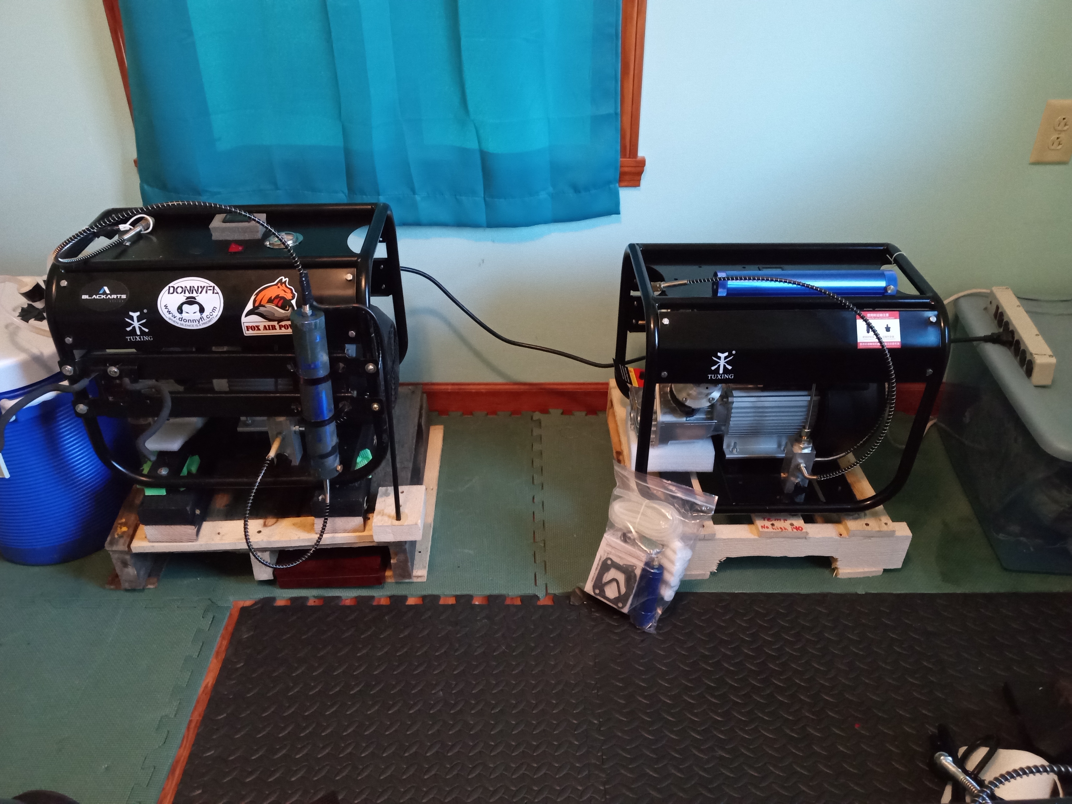

Now on my sixth and seventh PCP compressors despite the fact I've babied and coddled every prematurely-deceased one, I'm afraid of jinxing myself by stating that SO FAR numbers 6 and 7 are still running. Number 7 ($550 Chinese) is showing great performance and promise, but I've become too gun-shy to name names or recommend any PCP compressor, to anyone, any time.
However I will say two cheap Chinese compressors have given much better service per dollar than the American, British and (especially) Italian units. 🤬
