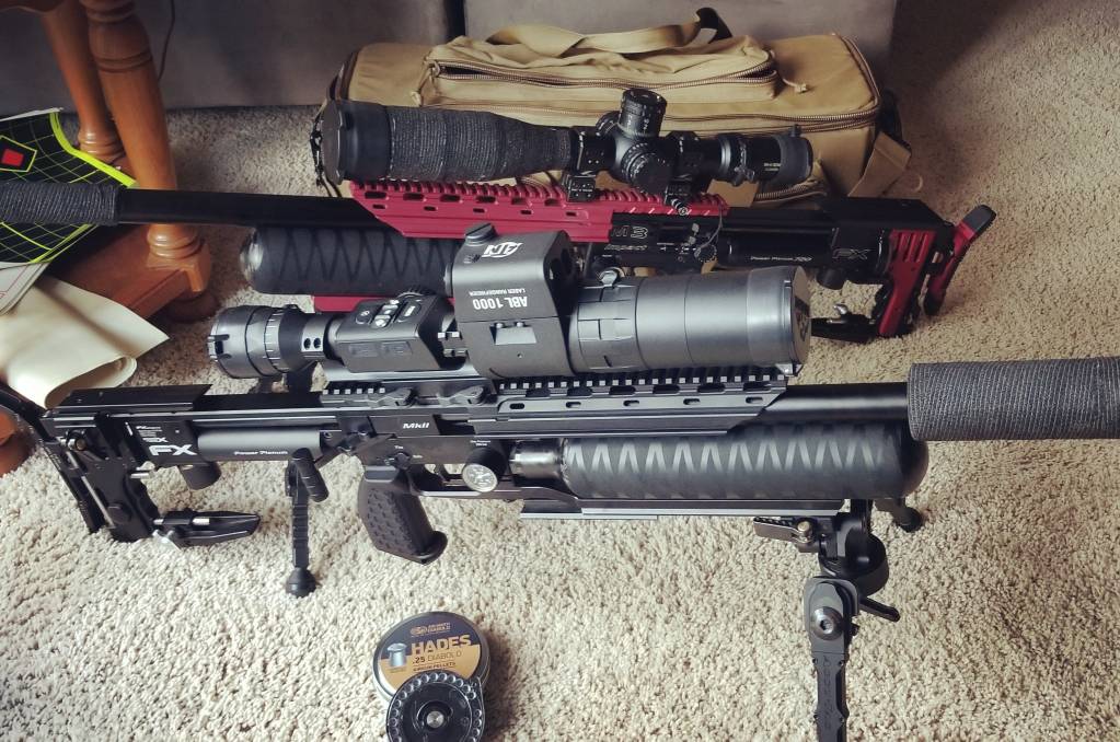

My first was the Sightmark Photon cuz it was cheap, Then when I knew what I was doing I got an ATN 4K So I am spoiled now. Likely not be buying another one for quite some time. Might need a thermal though says the addiction.
Ugh, I know! After reading iffy reviews, I have been very pleased with my ATN 4k other than you could use it as a self defense club. Have the ABL and ballistics calc working pretty well with pellets after a lot of trial and error. Works great as-is with slugs...no idea why they just wouldn't get rid of GL and replace with GA for airgunners.
