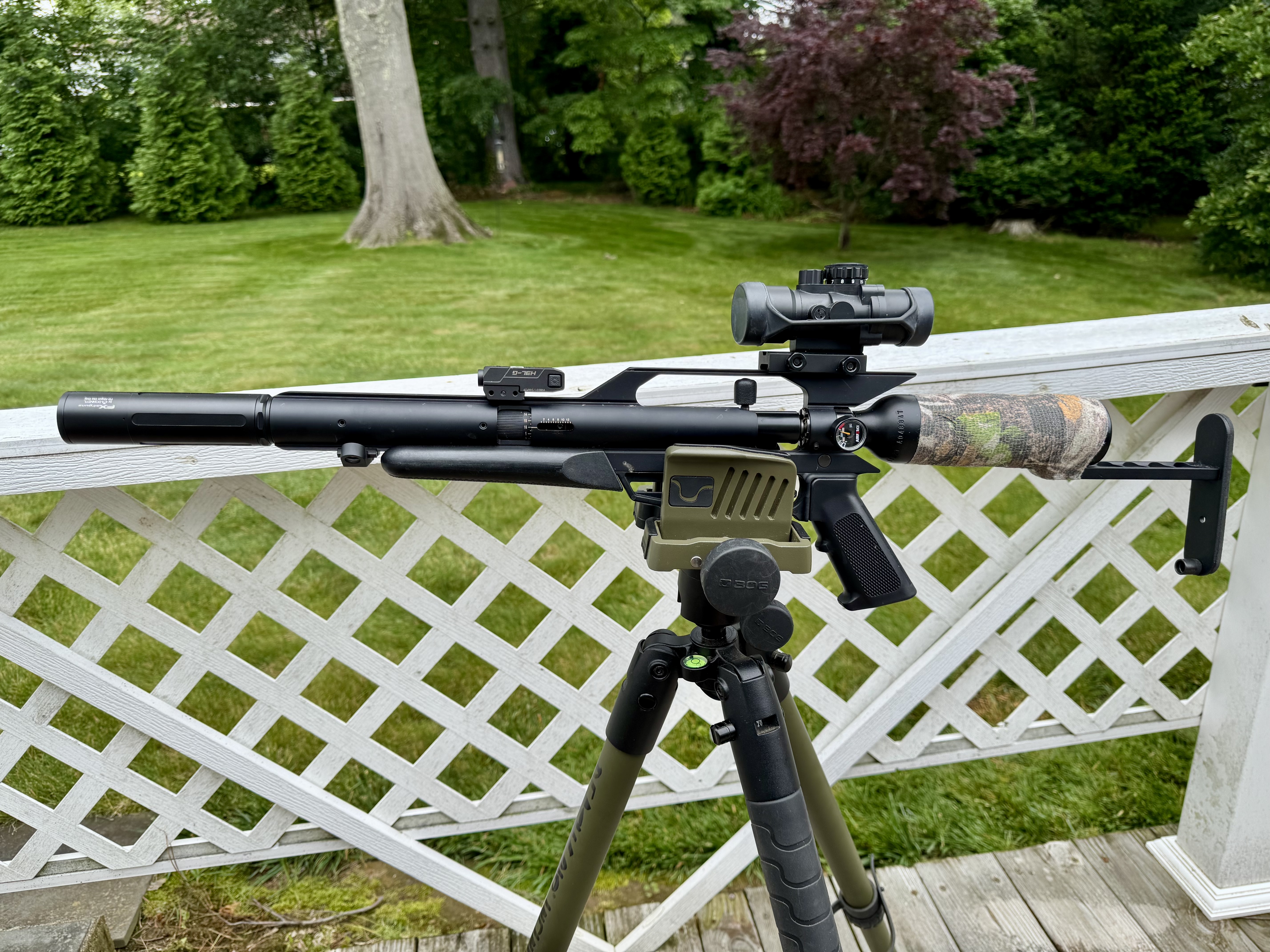

The suppressor is a DFL adapter w/ DFL FX suppressor. I’ve had a friend shoot the gun while I stood out in front 25 yds. away and it’s just a puff sound. Next to the gun You hear the spring and hammer. I’ve also used a Buck Rail 3D printed suppressor, which is very light weight and only slightly louder.
Gun is 32.5” and weighs 5lb. 6oz. as seen in the picture with QD sling attachment points front and rear.

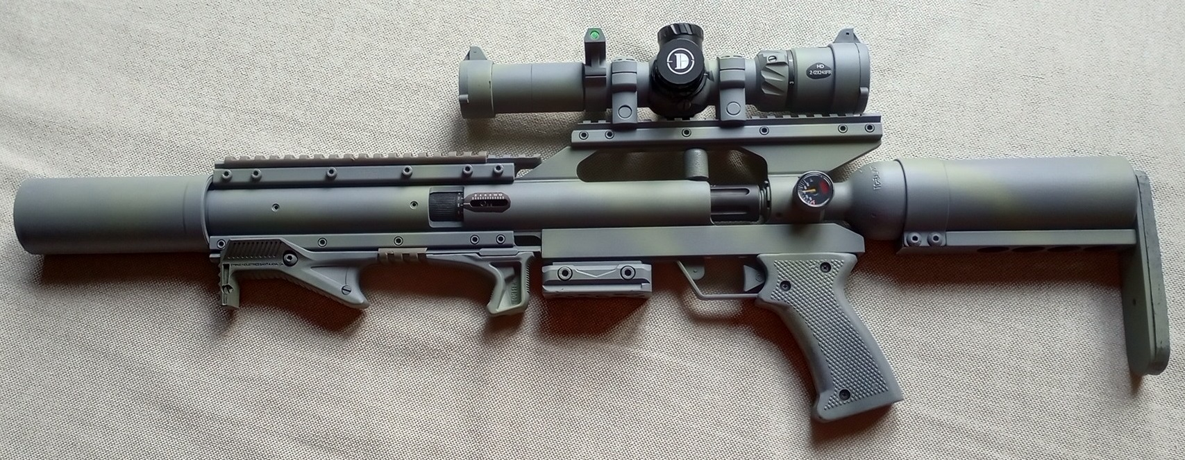

You say you want it as a backpack gun, so this one might not work for you, but the single biggest improvment to mine was a MadDog stock. That and the supprssor make the gun 34 inches long and weighing in right at 8 lbs. If that is not too big for you as a backpack gun, I would really recomend it.
I also added an slightly larger bottle.
Amazing looking, where is the foregrip from?
It is two separate units, that I thought would work well with each other, and I nailed it. The front half is a Strike Industries Cobra Tactical Fore Grip, and the back is a Bravo Company KAG. It's nice to be able to adjust the gap too, being two pieces. It almost looks like they were made for each other, it's really nice when a plan comes together.

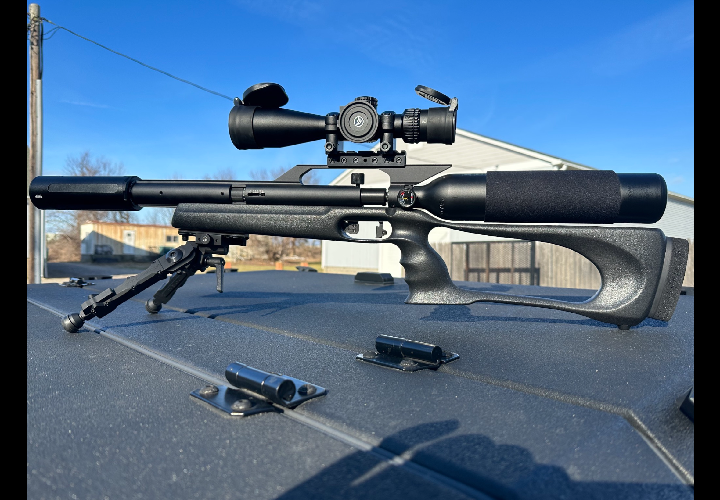

Best mod for TalonP is Maddog stock with pic rail as @NorCal David and @jmohme said above. Here’s what yours will look like with Vector (4-16x44ffp) scope and Ronin. I also went with larger Condor bottle for more shots. It’s 35 inches long now, 28 1/2 without Ronin. I had to buy adapter for 1/2-20 moderators from DonnyFl

I consider the stock a performance improvement. It eliminated any issues of hold sensitivity and makes the TalonP more comfortable to shoot.
