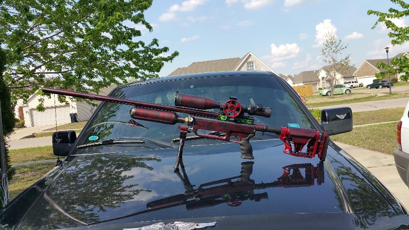

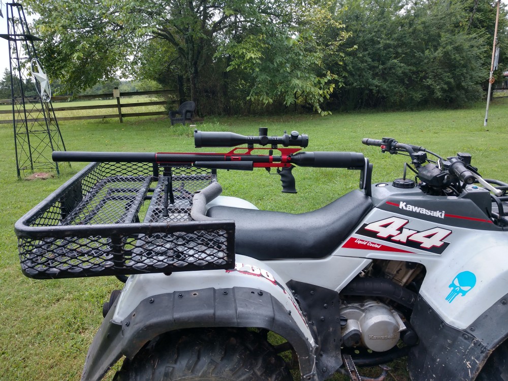

My Raw .20 replacement ‼️

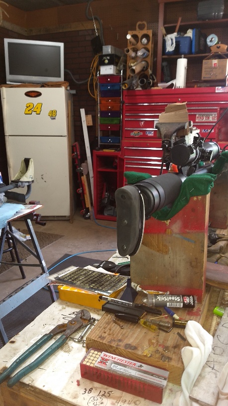

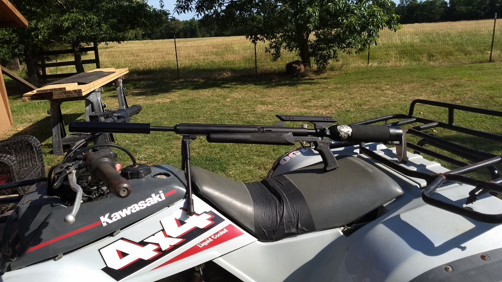

Yes I have. So far an accurate load for the gun. In the RAW I shot the 14.3 and the gun loved them. The Condor eats those as well. I did not notice much difference in my fps from the 14.3 to the 15.89. orfice .145, gun on power # 2. Still a bit hot for the pellet shooting 1040+- fps but the accuracy is there.
I bought this gun in a .22 and ordered the 24" .20 H Barrel. So I have Multiple caliber gun now. Looking to get a 24" .25 H Barrel to go with the mix.

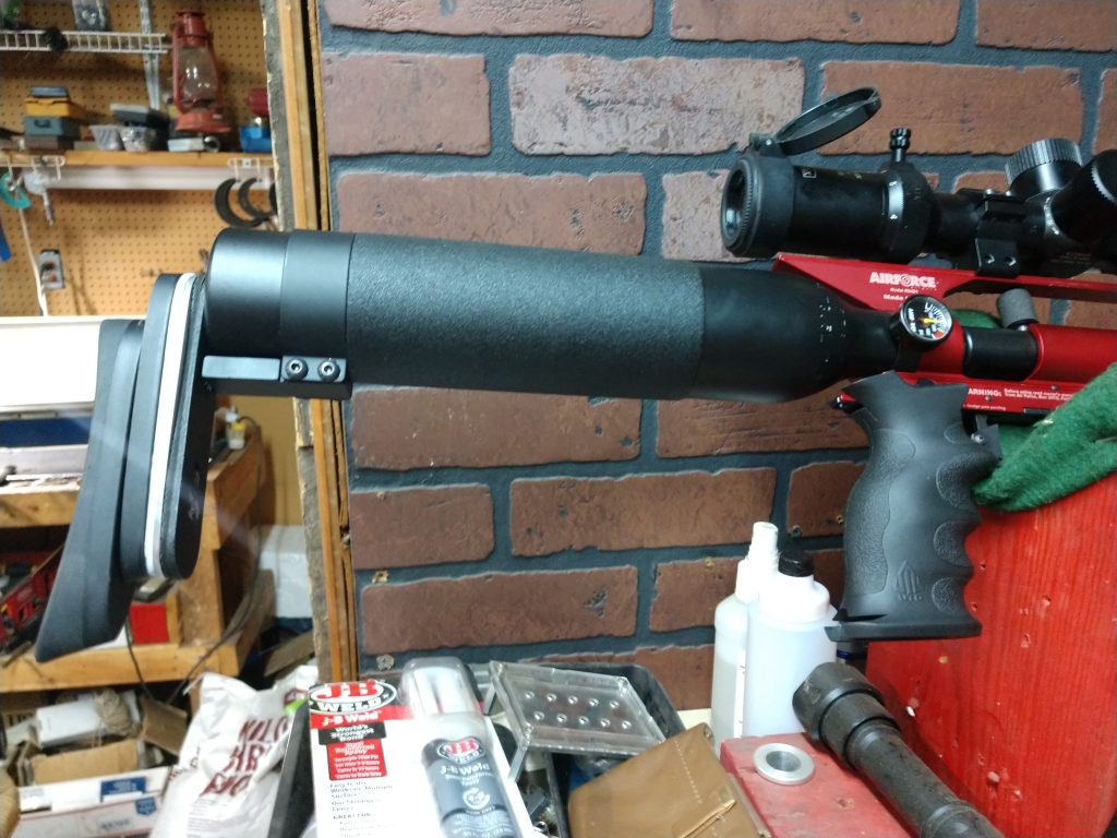

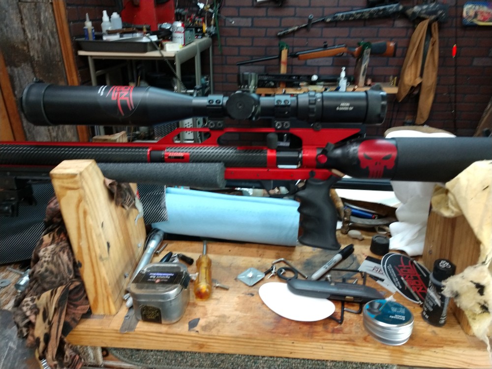

Here was the Talon/Condor build.
Both the Talon build have the extented forarm and the adj but pad. The Talon/Condo can is the baffles from the Talking canned. The Condor has the 14" TT Moderator and works great.
Thanks all for looking

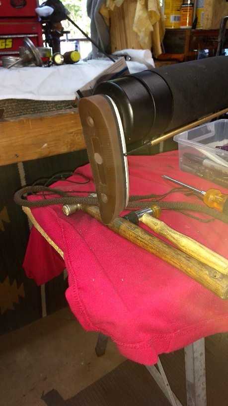

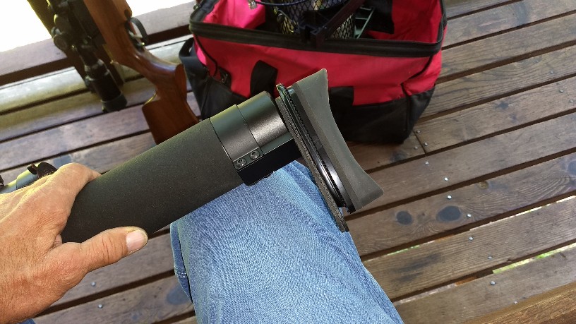

Totally agree. I like the butt pad much better than the factory. I like to cant some of my guns butt. I do use the level on top of the scope and have them on other guns.
Add some barrel length to that Talon p if you can and get instant power gain with no other mods. You will have to change you sound loc or buy a moderator.
The black TALON SS had a 24" barrel added to it and I used the sound loc parts to make a can. Worked just like the factory.
