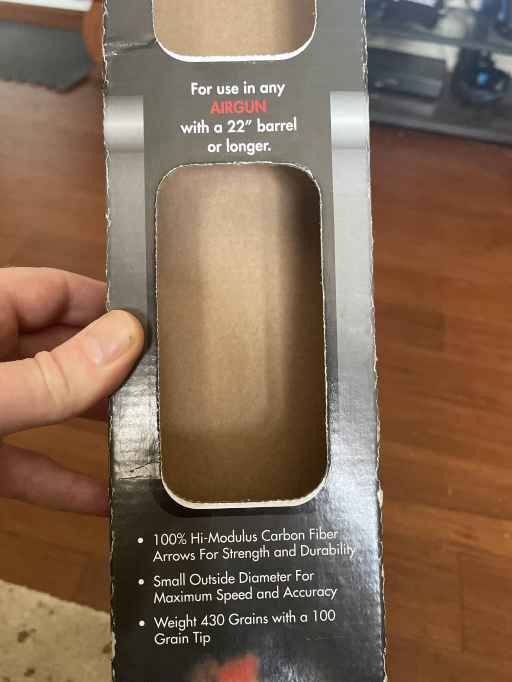

So after a little digging the the .457 carbine has a 24.75” barrel. And air Venturi sell arrows in.45 caliber that are good in barrels 22” or longer. So they will work. But my concern now is the rifled barrel. Is it worth the $100 for the arrows to experiment.
