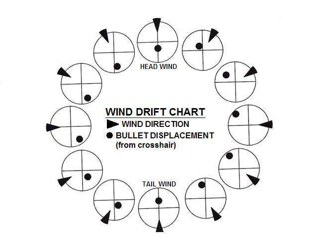

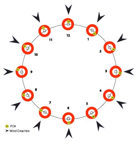

I like to use my charts also, you would think this would be ingrained in my brain by now ;-)
1558784386_14662678565ce929820e56b1.88845919_windchart bullet displacement.jpg

CampFussell - Those wind charts are simply wonderful & most beneficial to all who are in need. Thank you for sharing them with all of us.

    those charts are timeless, but often forgotten on the range. “Dang zero is off again!” “‘Maybe its because its a little warmer today”.
    “Did i bump my scope?”
    These questions plagued me for a long time when I was good at squeezing but nothing else. They still do sometimes. Just another piece of the wonderfully complicated puzzle that shooting is. Thats why its fun!

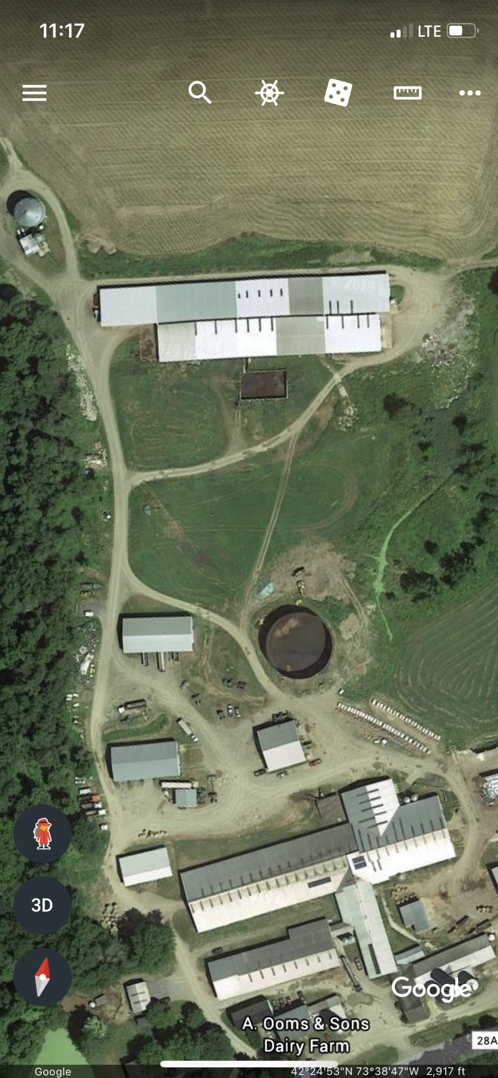

              I love those wide open fields for woodchucks. Buildings are our current nemisis. Swirling and dropping winds on top of us while trying to shoot pigeons . Ill try factor in what i feel and see, and be rewarded with a complete surprise when my slug lands lol. One of Our favorite farms is a mess of tall buildings and the wind is completely variable at all times
