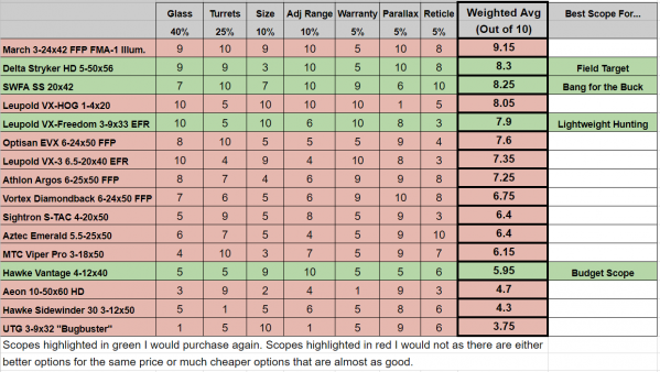

I don't have near the experience with scopes as JoeWayneRhea does, but I own or have owned all sixteen of these scopes. I thought I'd give my 2 cents worth about each one. I realize many might not agree with my rankings and may have had different experiences with each one. Please feel free to disagree in the comments and add your experiences with each. Each scope is rated roughly as follows:
Glass: A subjective opinion of the image's brightness, sharpness, and color accuracy at highest magnification in a variety of light conditions. I consider good glass the most important factor.
Turrets/Tracking: Are turrets repeatable? Do they click consistently? Is each subtension really 1 MOA/MIL? Are they zero resettable? Can the zero be locked? Bonus for tactical style vs. capped and for low profile as opposed to tall towers sticking out the top and side.
Size/Weight: How does the scope compare in length and weight overall?
Adjustment Range: How much adjustability do the turrets allow? Scores roughly equate to 1 for each 10 MOA of adjustment or Mil equivalent.
Warranty: If something goes wrong, how likely am I to be taken care of? 10 only earned if warranty successfully tested.
Parallax: Side parallax is preferable. How detailed can the parallax be dialed for measuring distances out to 50-60 yards? Side wheel available?
Reticle: A subjective opinion on the usefulness of the reticle with no preference toward 1st or 2nd focal plane. Standard duplex rates a 3. Points are deducted for artifacts and dust on reticle.

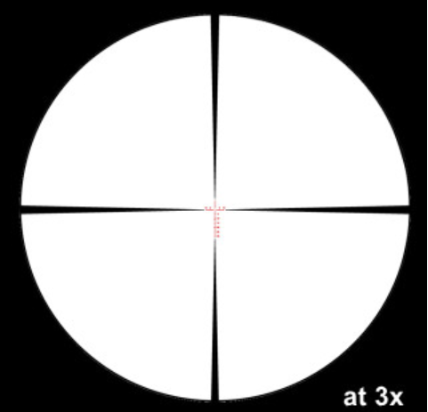

#1 March 3-24x42 FFP with FMA-1 Illuminated reticle
Pro:
  • Glass: The glass is extremely bright and clear. It is difficult to distinguish between the Leupold scopes and the March in terms of brightness. The March does have and edge in contrast to the Leupold scopes, but the difference is slight and not noticeable unless under severe scrutiny.
  • Size/weight: I like the low profile of the turrets and overall size (12.3 inches long) and weight (22.6 oz.) of the scope.
  • Magnification Range: The magnification range of 3x to 24x is pretty amazing for such a small scope and allows the scope to be a great option for both hunting and target shooting.
  • Reticle: I like the reticle. It isn’t anything too fancy which is a good thing IMO because it does everything I need it to without being overly complicated. I think it would be the reticle I’d design if given a choice. I’m partial to MOA subtensions and this scope has got them. There is also a Mil version if that is your preference. The reticle is even very useful as 3x magnifications because at 3x the reticle looks like a traditional duplex with the the crosshairs starting out thick on the edge and narrow toward the center. I find that I don't need the subtentions for close range shots. A thinner FMA-2 reticle is available. However, I find the FMA-2 target dot to be a bit cramped by the cross hairs and actually prefer the FMA-1. Like all the first focal plane scopes I’ve used, the reticle can seem thick at the highest magnifications. This one seems thicker than the Athlon’s reticle. This has never affected my group size or accuracy on any of the FFP scopes. In fact, the target dot seems exactly the size of the bullseye on the 25m Benchrest targets. This makes it very easy to shoot those targets accurately.
  • Consistency: Changing the magnification has no effect on POA.
  • Simple Illumination: There are only four settings for the illumination. I find this perfect as too many settings just makes it take longer to find the right one. When needed, I find the lowest setting is sufficient. Switching between settings is a simple push of a button.
  • Tracking: Every scope I’ve used (that wasn't probably broken) has passed the supremely important box test, and this scope is no different. I checked the actual distance markings on the reticle and they are dead on. Each mark equals exactly 1 MOA.
  • Adjustment Range: The scope has incredible adjustment range for both elevation and windage (100 MOA) making it a great long range scope. Each revolution of the turret gives 25 MOA of adjustment so that I can do all my adjust the scopes clicks all on 1 revolution and not worry about getting lost.
  • Zero stop:The zero stop is super easy to use. Simply turn a screw where you want the zero stop to be and it is done.
  • Resettable turrets: The turrets are easy to adjust so that the markings are realigned to zero.
Con:
  • Cost: This scope is not 5-10 times better than the other top scopes on this list even though it costs that much more.
  • Distortion: There seems to be a little distortion around the outside edges at 3x magnification. It isn't obvious or too distracting, but is definitely there. It disappears at 4x and above.
  • More Cost: A middle focus wheel must be purchased and doped with ranges if you want to use the parallax knob to determine relative distance. The parallax adjustment only has 3 numbers on it (10 yards, 100 yards, and infinity) and they are only used to show you which direction to turn the knob to focus.
  • Illumination: The illumination of the reticle is not worth the close to $1,000 it adds to the price tag. The red color is not perfectly uniform and there is a bit of bleeding at the two highest illumination settings. If you absolutely have to have illumination, I’d get a different scope.
  • Not true MOA?: Each click of the turrets is supposed to equal ¼ MOA. It is the closest scope I’ve tested to being exact on its claim, but I found that over a range of 40 MOA of both elevation and windage, that the scope tracked short 4 clicks (1 MOA) in all directions. Basically the scope is measuring 1 MOA=1.021 inches at 100 yards instead of the actual 1.047 inches. This is closer than all other scopes I’ve tested and doesn’t really affect us airgunners at the distances we shoot, but I was hoping that it would be perfect for the money.
  • Warranty: The warranty is only for 5 years and is non-transferable so if you buy a used scope it has no warranty. I’ve heard this is Japanese law and March takes care of its scope owners. I hope never to find out.
Status: Owned and mounted on my Steyr Hunting 5 Automatic. The high cost is simply not worth the performance difference compared to more budget friendly scopes. This scope is for shooters who like knowing they have the best money can buy. I'm keeping mine, so I guess that applies to me.

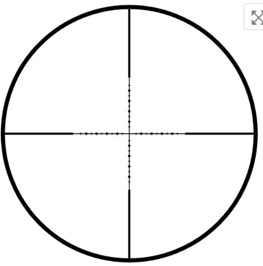

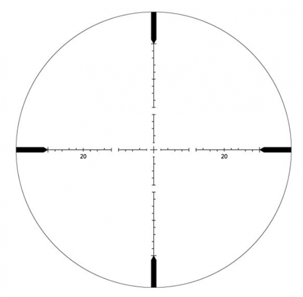

#3 SWFA SS 20x42 with MOA Quad Reticle
Pro:
  • Reticle: The reticle as good as (and very similar to) the outstanding Aztec Emerald’s. It can be had in Mils instead if you prefer.
  • Glass:  The glass is pretty good. It is (usually) clear and the image shows decent contrast. The colors can get washed out easily in bright sunlight, however.
  • Adjustment Range: The turrets will allow a whopping 126.5 MOA of adjustment. That means the scope will allow you to zero out past 100 yards with no sweat. They are a little taller than I'd like, but the extra height leaves plenty of room to put a custom turret tape on.
  • Turrets: Nice and crisp for each click.
  • Warranty: Lifetime no questions asked.
Con:
  • Parallax:  Lacks side parallax adjustment. If using on a field target gun, this might be a big deal. For basic hunting (with rangefinder) or target shooting it isn’t a big deal at all.
  • Fixed Magnification: Cannot be adjusted down to lower magnifications to make tracking during hunting situations easier.
  • Finicky eyebox: makes getting a clear sight picture harder than most scopes and can be irritating. The image has a tendency to get washed out if head placement is not perfect.
Current status: Sold, but I loved the lightweight and clarity for the price. I simply wanted higher magnification for the target shooting rifle I had it mounted to. I'd definitely buy this scope or another in the SS series again if it fit the needs of my intended shooting of the rifle.

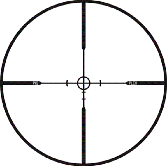

#4 Leupold VX-HOG 1-4x20
Pro:
  • Image: Extremely clear and crisp image. It is much easier to get a great image at low magnifications, so the 4x maximum magnification gives this scope a significant head start here.
  • Sight Picture: is big and target acquisition is easy at all magnifications. Ideal for small, light rifles because it only weighs half a pound and is very compact. Reticle is useful for finding holdover/holdunder.
  • Reticle: The reticle adds a lot to this scope. The subtentions are useful for holdovers and the circle around the center is great at bracking round targets.
  • Size/Weight: Perfect size for a low powered backyard pesting rifle.
  • No parallax: Magnification is so low that the image is clear at about any distance. Just point and shoot.
  • Adjustment Range: More than enough adjustment range to zero this little scope at any range the 4x magnification is suitable for.
Con:
  • Small magnification range: Only 4x magnification makes target shooting extremely difficult. This was a deal breaker for me.
Status: Sold, but I'd definitely buy this scope again if I needed a lightweight scope for close quarters shooting (such as hog hunting).

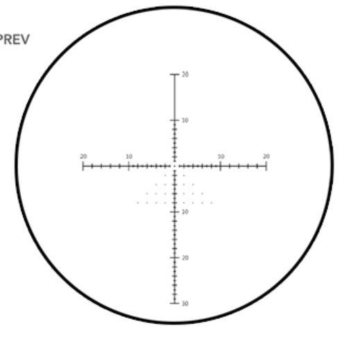

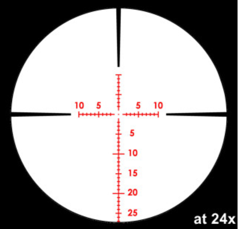

#6 Optisan Optics EVX 6-24x50 F1 MH24 Reticle
Pro:
  • Forgiving Eyebox: Getting a clear sight picture is easier on this scope than on the SWFA SS and Aztec scopes which can be a bit finicky to get a clear picture without milkiness.
  • Sharp Image: With both scopes at 20x to make a fair comparison, the Optisan seems to show a bit more contrast than the SWFA. The glass is as close to as bright as my Leupold 6.5-20, but not quite. I'd would be tough to tell the difference unless looking through them side-by-side.
  • Great Turrets: I wish I still had my Athlon to compare side-by-side to, but it seems to have all the clarity of the Athlon but with better turrets that don’t have the mushy first click. The turrets also lock.
  • Side Parallax: The adjustable parallax makes it more versatile than the SWFA which is nice if doing a bit of close range pesting.
  • Great lens cap covers: The lens cap covers are awesome and remind me of the real nice ones found on the viper pro. They can flip all the way back and flush with the scope instead of sticking up in the air.
  • FFP: The Optisan is first focal plane, and that is my preference. I would still like the scope if it were second focal plane, though.
Con:
  • Artifacts on Reticle: I noticed a few small specs of dust on the first focal plane. They are very hard to see but I can spot them easily now at 24x since I know where to look. They disappear at lower magnifications. This is a big con for me because I believe it is a sign of poor manufacturing quality. I don’t like the reticle as much as the SWFA reticle. I prefer a small target dot on the center.
  • No MOA: The reticle is mil only. MOA fans are out of luck.
  • Warranty: The warranty is not transferrable if you ever wish to sell your scope and you have to pay shipping both ways. Your receipt must also be provided, so don't lose it!
Current Status: Returned due to dust on reticle. I wouldn't buy this scope again. I'd go with the Athlon or Vortex because of their superior warranties.

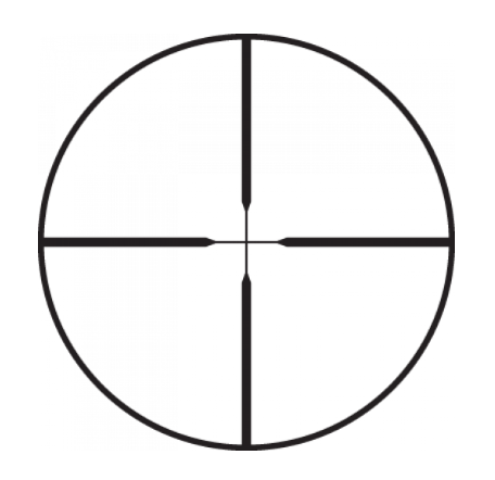

#7 Leupold 6.5-20x40 EFR Air Rifle Target
Pro:
  • Glass: The brightness and clarity of this scope puts most others on this list to shame. At least it is easy to see why it costs more than most of the other scopes on the list.
  • Size and Weight: This is the lightest 20x power scope on the market. The light weight is very noticeable and makes guns of any size easier to pack, shoulder, and aim. This scope has caused me to emphasize weight more in my scope preferences. I love the feel of this scope on my guns.
  • Parallax Adjustment: The ranging capabilty of the parallax adjustment is outstanding.
  • Tactical Target Turrets:The tactical turrets are very easy to click. The scope tracts perfectly and returned to the correct point of aim perfectly every time on the box test.
  • Excellent Eye Relief: Getting a clear sight picture is automatic.
  • Warranty- It also comes with the world's best warranty. What is not to love?
Con:
  • Reticle: While the plain duplex reticle is functional, a mildot reticle would be very useful especially for the times that the turrets run out of adjustment range.
  • AO Parallax adjustment:  With the parallax adjustment at the front of the scope, I can’t look through the scope on a bench and easily adjust the focus because my arm is so far extended.
  • Limited adjustment range: The adjustment range of the turrets is too limited at 40 MOA. It is a consequence of the tube only being 1 inch instead of 30mm. If the scope is zeroed in the center of the glass that only leaves 20 MOA of affective adjustment range. As a result, I cannot adjust the scope to shoot out to 100 yards (it falls just short) without shimming the back of the scope up.
  • 1 click not equal to 1/4 MOA: When testing that the 1/4 MOA per click was accurate over a 20 MOA span, I found the Leopold over-estimated by 3-4 clicks. This means 1/4 MOA per click is actually a touch higher. It doesn't affect my use of the scope, but I found it interesting.
  • Turret caps: must be removed for adjustment and are easy to lose.
Current Status: Sold when downsizing.

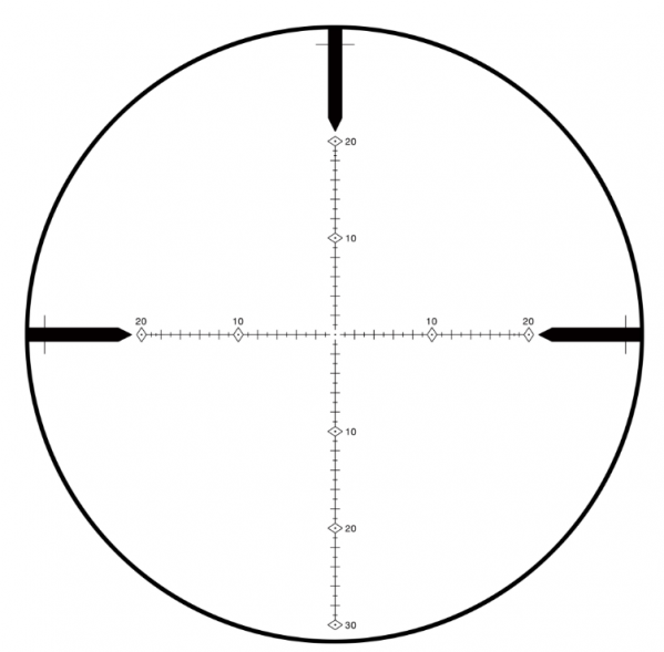

#8: Athlon Argos 6-24x50 with Illuminated mil reticle and mil turrets
Pro:
  • Glass: The Athlon Argos has nice clear glass (better than the SWFA and Aztec IMO). I never saw any fogginess at any of the magnification levels.
  • FFP: First focal plane scopes are the way to go for shooters who like to change the magnification on their scopes often.
  • Reticle Options: The scope comes in both MOA and Mil reticle versions to suit your preference. It also comes with flip up objective covers (my favorite).
  • Warranty: Great transferable warranty.
Con:
  • Thick Reticle: The reticle is a touch too thick at high magnifications. It is definitely still usable for target shooting and I doubt it has ever affected my accuracy, but is a con for me since most of my shooting is target shooting with the scope at high magnifications. If you solely shoot targets and never adjust magnification, a second focal plane scope would have an edge. I prefer the fine dot in the center of the reticle like the March, SWFA and Aztec have, especially in a FFP scope.
  • Mushy Turrets: The turrets would feel mushy on the first click of adjustment and be crisp on all following clicks. I've heard this can be fixed by removing a bit of the thick grease from the turret and replacing it with a bit runnier stuff. It would be better if Athlon just used the runnier stiff in the first place.
  • Illumination Overkill: The scope also has an illuminated reticle with something like 12 brightness levels. 12 brightness levels seems a bit overkill to me. I’m not a big fan of illuminated reticles. They are a cool sounding feature I never find myself using and that just add extra weight and bulk to the scope, but for some they are nice to have.
Current status: Sold when downsizing. This is a very good scope and comparable to the Optisan and the Vortex first focal plane scopes. I'd buy the SWFA again over all three.

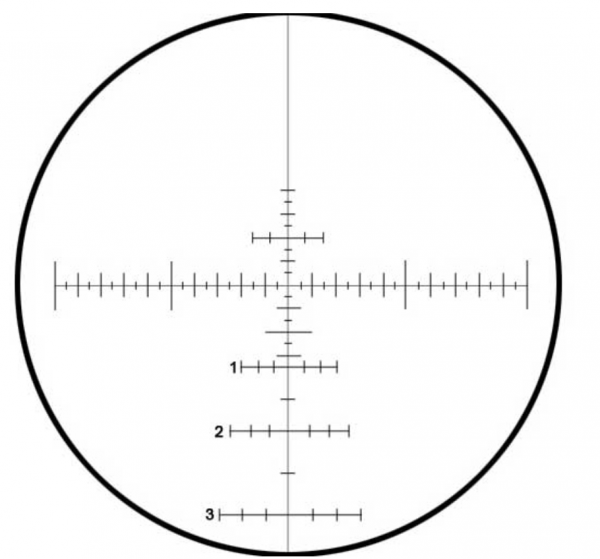

#9 Vortex Diamondback 6-24x50 FFP Ebr-2c MRAD Tactical
iyLBniuPWD7hDgOjS_sVK10_zEUZdoFDsM-vzYMii2h3GH-GnkG1ouG65R_L_aaVo5s08bWftYekjzV3qWHAqnib3P0LAOV1YlGWBCULmv_5zvjU73mVfNrs-krF-CLDXn2n7S8G
Pro:
  • Repeatable: As a bare minimum, a scopes turrets have to be repeatable. The Vortex aces the box test with grippy turrets that are easy to turn.
  • Parallax: I love side parallax scopes. The Diamondback has a very nice one that has the most important airgun distances marked (10,15, 20, 25, 30, 40, 50, 60, 75,100,150, 300, and infinity). Unfortunately, the marked distances aren't always accurtate to where the image is actually parallax free. For example, at 27.4 yards I found the correct parallax setting on the scope to be just a hair further than the 30 mark.
  • Adjustment Range: With 19 MRAD (65 MOA) or elevation adjustment, the scope has enough adjustment to reach out too 100+ yards without the need for adjustable rings. Adjustable rings are still needed if you want to stretch the scope out to 200 yards such as for the Long Rangers challenge.
  • Reticle: While quite busy at first glance, the small subdivisions make using the reticle for holdovers and windage adjustments very accurate. I personally use a rangefinder for ranging, but if you like to use your reticle, you’ll love the fine subtensions on this scope. The size of the reticle is perfect. The subtensions are still useful at the 6x magnification and do not grow too thick at 24x. There is an MOA version if you prefer it.
  • Turret Height: The tactical turrets don’t stick up as far as a lot of other tactical turrets. I really like this feature as the turrets on my Leupold stick up so high that it is hard to fit the rifle in a gun scabbard.
  • Zero Stop: Since the turrets do not have markings to show which revolution you are on, the zero stop has become a feature I rely on with this scope that I usually ignore on other scopes.
  • Company Policy: I’ve been wanting to buy a Vortex scope for a while now. Even though I am not a veteran, it is my belief that we don’t treat our veterans with the respect they deserve. I appreciate that Vortex gives veterans a 20% discount on their scopes and have been wanting to buy a Vortex scope for a while to support the company and show my appreciation.
  • Warranty: Unlimited, transferable, lifetime warranty for any owner of the scope. No documentation needed. Can’t get better than that! Well, I guess it would be better not to ever need the warranty, but it is nice piece of mind to have.
Con:
  • Glass: I sure wish I had an Athlon, Optisan, and Aztec to compare the glass too. But alas, I no longer own those scopes so must rely on old observations and opinions of those scopes. All scopes lose brightness and clarity as the magnification increases. On the Vortex, the image stays bright and sharp at magnifications up to about 12x with no noticeable change in image quality. The image degradation becomes noticeable at about 16x and above. The image is not as clear at high magnifications as my March and Leupold 6.5-20 scopes. There is a bit of noticeable haze especially at the 24x magnification. The glass is decent, but does not stand apart from other scopes in this price range.
  • Finicky Eyebox: Head placement is very important. The image is washed out easily if the head is not placed perfectly. It is reminiscent of the SWFA SS in this way.
  • Mushy Turrets: There is significant play in the turrets between each click. This never really bothers me as the amount of play is consistent each time and is always followed by an audible click. It is much different than the turrets on my March which have absolutely no play. I know most people prefer turrets with no play which is why I list it as a con, but it doesn’t really bother me. Consistency rules and these are consistent.
  • No Revolution Markings: This lacking feature bothered me at first until I found a work around. I often adjust my scopes to shoot long range and rely on markings under the turret to determine which revolution I am on. It takes several revolutions to reach out to 200 yards for example. This scope has no such markings. The zero stop can be used in replace of these markings. As I crank on the turrets to lower the point of aim, I know that I am at the correct revolution when I run up against the zero stop.
Other:
  • Size- The scope is the typical size for a 6-24x50 scope at 14.5 inches long and 24.6 ounces.
Status: Owned and mounted to my father's Air Arms S510 carbine. My father likes the reticle and good elevation adjustment range.

#12: MTC Viper Pro 3-18x50
Pro: The smart range turrets are neat. I would definitely use them. The SBC2 christmas tree like reticle is nice and thin. The objective covers are awesome and can flip all the way down or straight up as desired.
Con: I hope it was something wrong with the scope I bought, but the image was cloudy at all magnifications compared to the Athlon I had. The reticle is on the second focal plane. The Athlon was so much more clear that I couldn’t justify keeping the Viper Pro over the first focal plane Athlon. The scope is heavier than it looks.
Status: Sold in favor of the better clarity and FFP reticle of the Athlon. There are better scopes for the money.

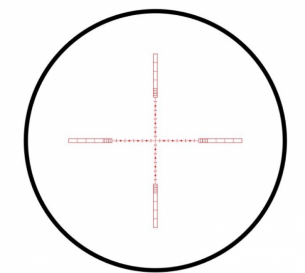

#13 Hawke Vantage 4-12x40
Pro: An excellent scope for the money. The glass is decent for a budget scope. The mil dot reticle is useful for both hunting using holdovers and for punching paper targets. The zoom range up to 12x is useful for more precision shooting. The scope only weighs around 16 oz. and can be used adequately on about any air rifle. Bikini style lens covers have clear windows so the scope can be used in a pinch without removing them.
Con: The turrets are not tactical, so the turrets covers must be removed to adjust elevation and windage. I suppose the reason this is a problem is more personal than anything else. I have a habit of taking them off to adjust the POI and lose them when I forget to put them back on. The scope has a front focus knob, which is my least favorite, but I’ll happily use them to save some cash as long as I like the rest of the scopes features (In this case I do!). The scope has MOA adjustments but a mil reticle. This irritates me more than it should. It would drive me crazy if the scope was first focal plane. Since this one is second focal plane, it is probably a non-issue.
Current Status: Sold and replaced by the higher dollar scopes I’ve tried, but I would definitely buy this scope again. It is the best budget scope I've owned.
