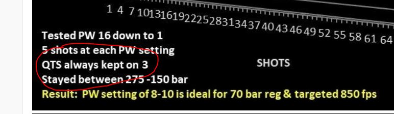

AEAC may have stumbled upon a useful M3 "hack" tool that could help the user identify an enhanced performance sweet spot in the overall system mechanics of the M3. He and Sweden aren't really sure yet. Additional evaluation & understanding is required 😊.
Read on!!!

Hey y'all!!
Explanation of the above shot charts.
12/24 EDIT & UPDATED UNDERSTANDING (thank you AGN members & FX Sweden) - The above "AEAC M3 Power Wheel Search Tool" is a sweet spot search tool hack I stumbled upon that can help one locate & identify a theoretical mechanical system-sweet-spot hiding within the M3's overall system-mechanics... a sweet spot where PW & QTS interact with a bit less resistance, hence may offer enhanced performance. If/once identified, the user could build upon this tool's usefulness by incorporating knowledge of its location into their tunes.
Originally, I thought that the found anomaly could be used to identify a harmonious sweet spot between reg pressure & hammer spring tension, but as it turns out, it's probably only useful as described above... we'll see, I'm gonna play around with it some more. Either way, it did help me to create a very decent 850 fps, 16gr .22 cal Eco Tune for the M3 "Compact," with the 300cc bottle and 500mm liner.
If you'd like to repeat my steps and try for yourself on your M3, here's how I went about it:
First Step - Using the regulator pressure the gun arrived from the factory set at, the owner's manual, and intuition as a guide... choose a fore & aft regulator pressure you want to test at, and dial that in. Remember that Reg 2 is what the valve sees and Reg 1's only function is to simply "step down" the bottle pressure to a more manageable pressure for Reg 2, enabling Reg 2 to do a better job with consistency. About 30 bar between the two regs is an ideal place to be... feel free to experiment but going less than 25 bar in between isn't recommended. More than 60 bar in between is approaching the realm of not observing a difference in influence.
Second Step - Run the 85 shot "AEAC Flat Spot Search Tool," keeping the gun pressurized to between 150 and 225 bar (275 was a typo sorry) throughout the test. To run the test, simply take 5 shots at each Power Wheel setting, beginning with 16 down and working your way down to 1 (with lower reg pressures, allow 5-6 seconds in between shots for regulator breathing for this step). Follow your gun's recommended Valve Adjuster setting for this portion of the test (as stated in the manual or as it arrived from Sweden). Mine was just about fully unscrewed and touching the shroud bottom.
Third Step - Evaluate your shot chart and look for "flat spots." If their manor resembles the ones I found above, they may be where your PW and QTS interface with the least resistance. Knowing of these sweet spots aren't necessary for creating a great tune, however if you learn of them, you can exploit their existence and perhaps make a great tune even better.
Fourth Step - Bring it all together by gradually reducing the M3's "Valve Adjuster" (by 1/4 to 1/2 turn at a time from max to min & testing with 5-10 shots at each position) and be on the lookout for ES & SD tightening. This final step sets a "bump-stop" travel limiter for any valve overtravel, hence effectively reduces waste air behind the pellet. It improves accuracy, and it will increase the efficiency of your tune (see above Eco Tune 1 > Eco Tune 2 improvement). You will also likely "hear" an audible "cough" report turn into an audible "snick" report as you approach the sweet spot of this step.

Hey y'all!!
The above "AEAC M3 Power Wheel Search Tool" is a "Sweet Spot Search Tool" I came up with to dramatically cut down on the tune-time (and pellet usage when tuning) of your M3. This simple approach to tuning the FX Impact M3 will quickly inform you of where your hammer spring wants to be for the regulator pressure you are currently set at.
First Step - Using the regulator pressure the gun arrived from the factory set at, the owner's manual, and intuition as a guide... choose a fore & aft regulator pressure you want to test at, and dial that in. Remember that Reg 2 is what the valve sees and Reg 1's only function is to simply "step down" the bottle pressure to a more manageable pressure for Reg 2, enabling Reg 2 to do a better job with consistency. About 30 bar between the two regs is an ideal place to be... feel free to experiment but I wouldn't go less than 25 bar in between. More than 60 bar in between is approaching the realm of not observing a difference in influence.
Second Step - Run the 85 shot "AEAC Flat Spot Search Tool," keeping the gun pressurized to between 150 and 225 bar (275 was a typo sorry) throughout the test. To run the test, simply take 5 shots at each Power Wheel setting, beginning with 16 down and working your way down to 1 (with lower reg pressures, allow 6-7 seconds in between shots for regulator breathing for this step). Follow your gun's Valve Adjuster recommended setting (in the manual or as it arrived from Sweden) for this portion of the test (mine was just about fully unscrewed).
Third Step - Evaluate your Shot Chart and look for "flat spots." Those flat spots are where your hammer spring wants to live, with the current regulator pressure you have assigned to your gun. Match up your chart's flat spots with the corelating Power Wheel setting/number, and you've just found your setup's preferred HS/PW "sweet spot" setting for that reg pressure.

Steve, Might be a silly question, but, when you mentioned keeping the QTS=3 setting "always" is that literally while you are running down the PW from 16-1?
Re-adjusting the QTS to "3" as you work your way down to 1?
Just making sure I get you're method.
Happy Holidays,
Patrick
Correct! Reposition the QTS back to 3 (neutral) with each new PW setting and 5 shots. Steve
The QTS that you mention setting at 3, also known as the minor adjustment in the manual, provides exactly the same hammer spring tension when set at 3, regardless of where the 1-16 (macro) wheel is set. In other words, a micro of 3 with macro of 16 is exactly the same HST as as a micro of 3 and a macro of 1. The macro wheel exists only to make it easy to get consistent changes in HST for different ammo or speeds. For example I might have a high power tune for a slug needing HST corresponding to 4.5 on the micro wheel. By setting that up on macro 16, I can then find a lower macro setting (say 5) that shoots a lighter pellet at my favorite speed. The macro allows me to jump between them quickly without having to count the clicks on the micro dial (which can easily get mal-adjusted and out of whack.
I’ll refrain from any further comment on your method.

Steve - there’s no option for us both to be correct here! These are mechanical devices with defined functions.
Multiple people with experience in tuning this platform have debunked the premise of your approach. It’s akin to setting two presets on your car radio to the same broadcast frequency and claiming that one sounds better than the other.
I can at least save you the time contacting FX. I email my contact there along with the folks at UA. Both confirmed that what myself and others have pointed out is correct.
