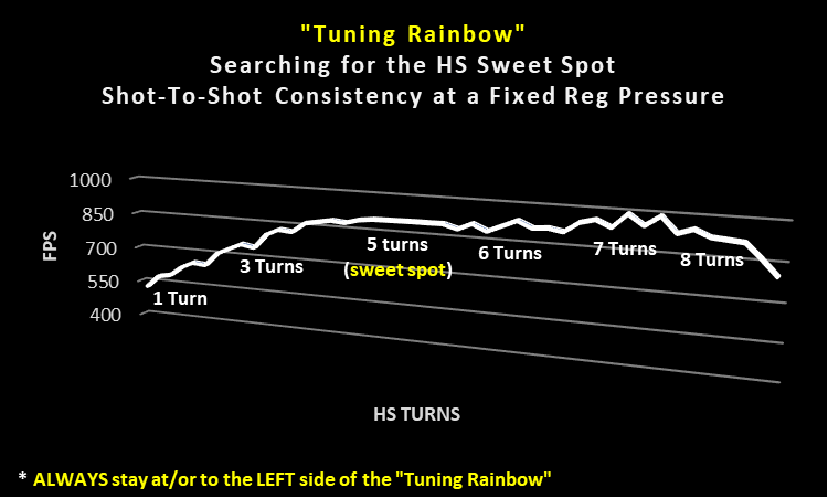

11:16 Step-By-Step Tune Creation Demo/Walkthrough and the "Tuning Rainbow"

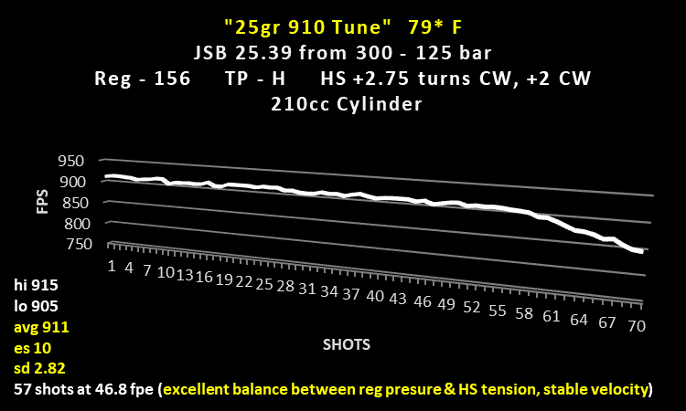

21:03 JSB 25.39gr "910 Tune" and 50 Yard Validation (un-moderated)
23:23 JSB 25.39gr "910 Tune" and 50 Yard Validation (moderated with DonnyFL Ryu)
24:14 JSB 25.39gr "910 Tune" and 120 Yard Stability Test
25:45 JSB 25.39gr "910 Tune" and 50 Yard Validation (moderated with Impulse Air 1350)

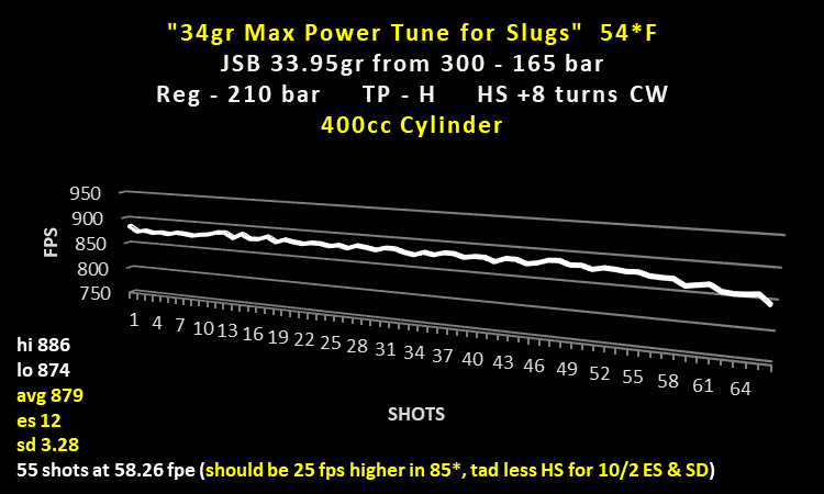

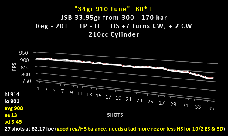

34:57 NSA 33.5gr Slugs "Max Power Tune" 120 Yard Validation
37:35 Zan Projectiles 33gr Slugs "Max Power Tune" 120 Yard Validation

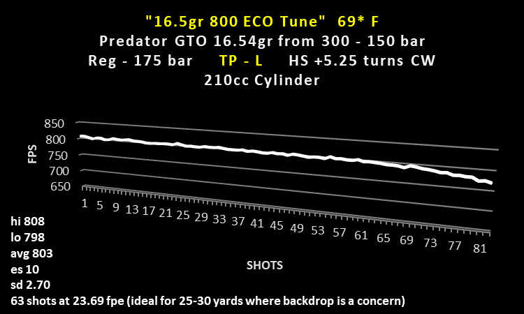

40:07 Predator GTO 16.5gr Tin Pellet "Eco Tune"

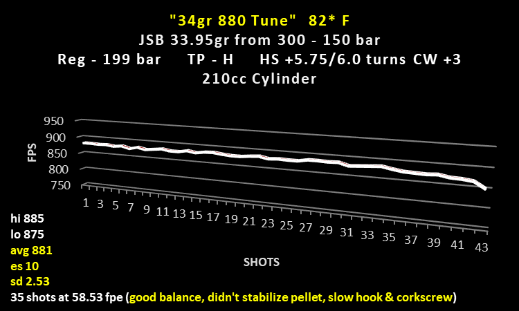

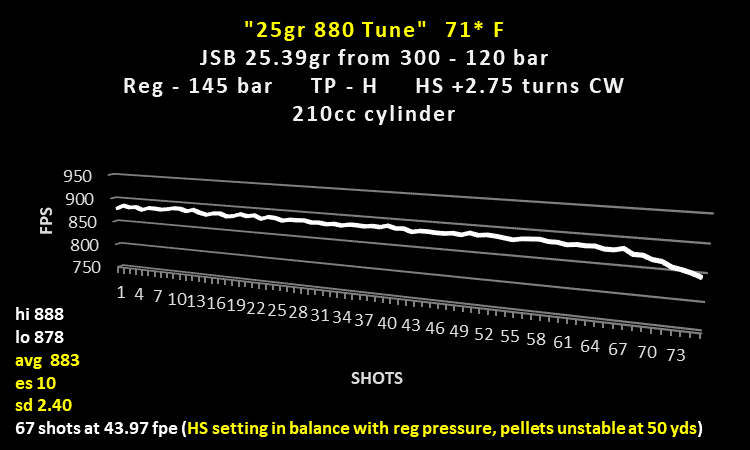

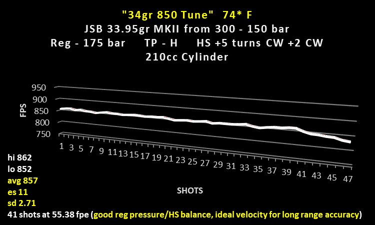

Tuning Process (same for any adjustable PCP airgun)

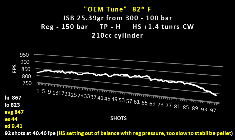

The first thing I want you to do is pick a random reg pressure to start out with… don't care what it is, so long as it’s on the lower side of what you’ve heard is good & proper.
Next, I want you to back way-off your hammer spring tension, begin shooting over a chrony, and slowly bring the HS tension up, until your shot-to-shot velocity just begins to stabilize… taking at least 10 shots to be sure.
Now STOP, that newly found HS balance point marks an ideal place to be for the reg pressure you just chose. Take note, you’re close to a sweet spot.
Continue to tighten your HS tension, in ultra small bits at a time now, until you observe your shot-to-shot velocity really tighten up… like within 1-3 fps of one-another. STOP, you’ve arrived.
Don't increase the HS tension much past this balance point, or you’ll cross over into the right side of the tuning rainbow.
Now if you need more or less speed, that’s okay, but go to the reg, not the HS. Try not to use the HS as a velocity control device… for the most part, that’s the regulator’s job! Remember, “the regulator is the master flow control.” The HS is just there to balance the valve out with your reg setting.
If you need more velocity, increase the reg pressure and repeat the above steps to rebalance the HS tension to match. If you need less velocity, reduce the reg pressure and rebalance the hammer spring to match.
Now that you’ve got the basics of how to go about locating balance points between regulator pressure and HS tension, begin testing varying velocities for accuracy… and test at a minimum of 50 yds (75 yards is better).
Along the way, it’s important to rebalance your reg/HS selection for each new velocity tested, otherwise your accuracy results won’t be reliable. And always work the HS from low to high and slowly. Hammering up past the sweet spot is super easy to do.
As you go, repeat the above steps, until you find a velocity at which the projectile becomes its most accurate… and doesn’t hook, wobble, or corkscrew in flight.
Then, go build yourself out a nice clean tune around that speed… it’s that easy.
Key Things to Remember While Tuning Any Airgun
* Let the reg be your velocity throttle, the hammer spring setting just brings the rest of the system into harmony with your chosen reg pressure.
* All you’re doing with tuning is balancing out the forces between your reg pressure and hammer spring tension… at your chosen velocity.
* When searching for a new HS setting to balance out with a new reg pressure setting, always work the HS adjustments from low to high and right up to the point of velocity stabilization and NOT PAST… this will keep you on the left side of the tuning rainbow.
* If you slowly HS your way up the left side of the tuning rainbow, then observe velocity level out, you’ve arrived at that reg pressure's desired HS setting. If you continue to HS past it and observe erratic velocity or sometimes descending velocity, you’ve crossed over to the right side of the rainbow and you’ve overshot the HS balance point for that reg setting.
* Always stay on the left side of the tuning rainbow to avoid erratic fps, hammer bounce, waste air, and accuracy-ruining projectile instability.
* The left side of the rainbow is desirable because it is a place where the reg pressure is quickly closing the valve after the hammer smacks it open, creating a place of efficiency and eliminating turbulence-causing waste air.
* If you want more speed and can’t get there with the Reg/HS in a state of balance (consistent velocity) add more reg, back off the HS, and repeat the process… don’t let the HS be your go-to for increasing velocity. That’s the reg’s job.
* Learn your gun’s "Reg Pressure Road Map" by taking note of the velocity balance point at each reg pressure setting.
* Field tune for the right velocity (for that pellet/slug) in the wind at 50+ yards to ensure that projectile stability is there, then go home and build a clean tune around that speed.
* Obsess over ES & SD not because of shot-to-shot consistency but because the tightness indicates a fast-closing valve with minimum waste air emerging around the projectile as it leaves the barrel.

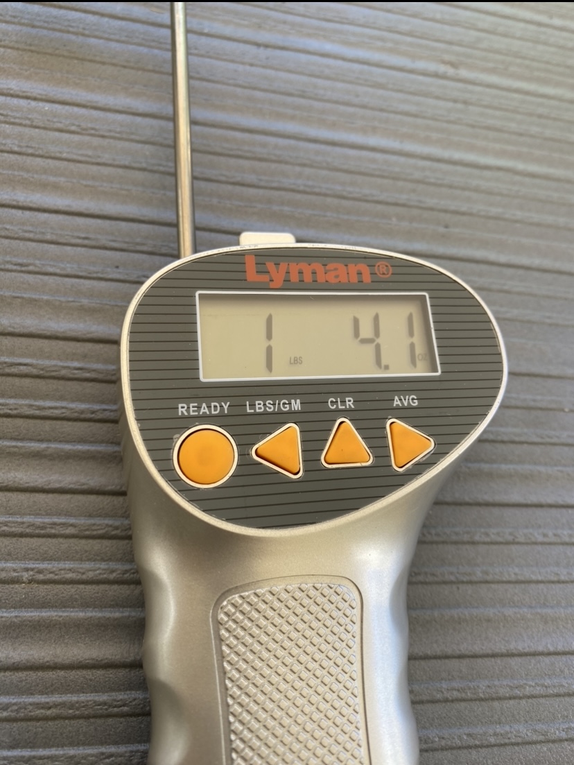

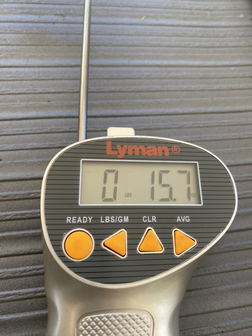

If anyone is interested in knowing the results after making the mod to the trigger of our Avenge-X airguns that Steve recommends, here it is. And also the difference between a bad and good tune in a 30 yards range. All this shots were done with the JSB 25 and air arms diabolo fields 25 grains pellets, our X airguns love this pellets and the rebranded JSB Hades FX Atomics 26.6 grains as well.
Reactions: Netman
