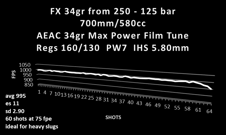

        Hey guys,
        ... for those wanting to know how much power the Mav .25 Sniper is capable of off the shelf.
        60 shots x 75 fpe WITHOUT use of the accessory "Power Slug Kit."
        Steve
