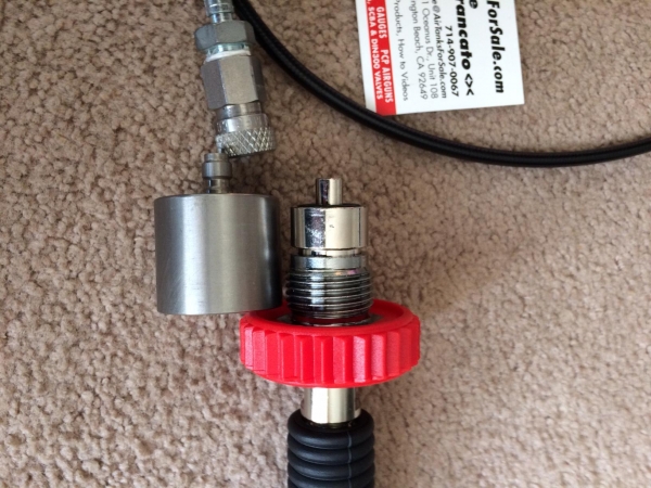

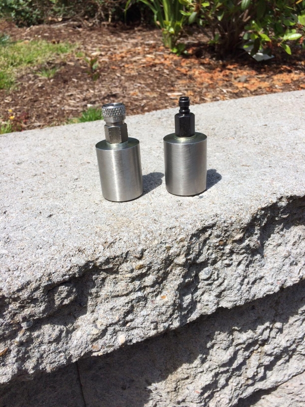

I bought one about a month ago and filled two 88cu ft tanks and topped off another two tanks. She runs perfect! I bought two quick connect/disconnect fittings. One male and one female for the different tank valve configurations. Important to note, you need the extra long, quick connects to work on the 300din hose that Coltri supplies. The Din300 has a nipple on the end... Pyramid Air and Airgun Depot have them. I'll attach a couple of pics later today.

"Oregun"Fantastic job, Steve!
--Carl
The pic of the fitting next to the hose is too small, the other two are the right size

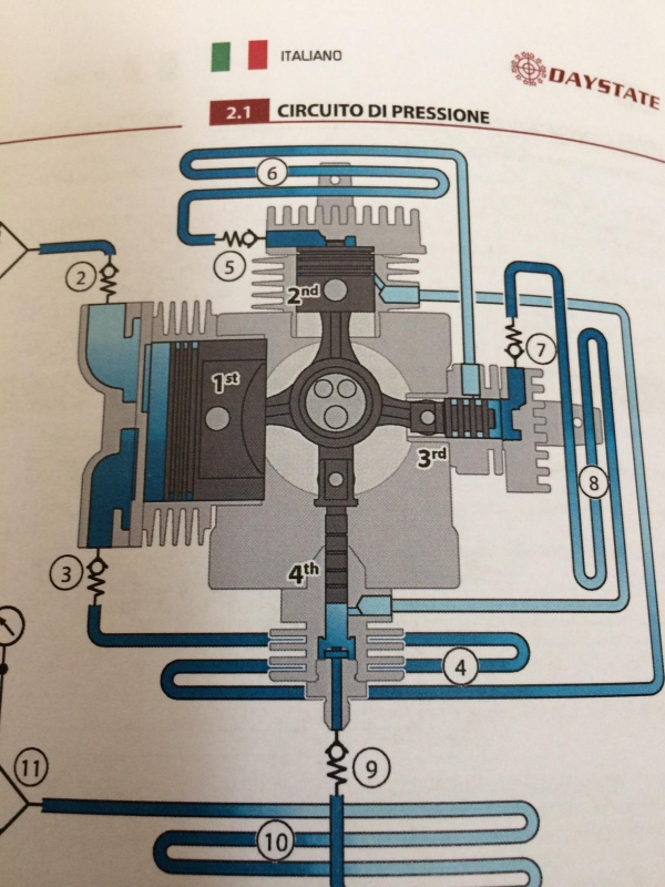

"Oregun"I know the one Steve reviewed is a 2016 model... mine is 2017. I don't think there's a difference. The manual says, Type-3.
When I look at the manual, they call out a 4th stage, which appears to be a small piston and outlet valve. See pics below.

The new 4 stage 110v's have a new pop valve hanging off the bottom of one of the pistons that you can see me take apart in last Wednesday's vlog. I'm guessing it's some sort of extra moisture relief or over fill protection... not 100% sure and neither is AOA, lol. Coltri just added it and nobody in airgunland really knows what it it yet.
