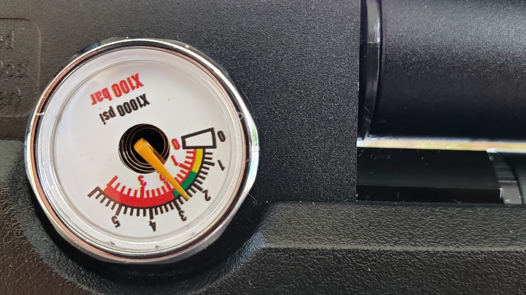

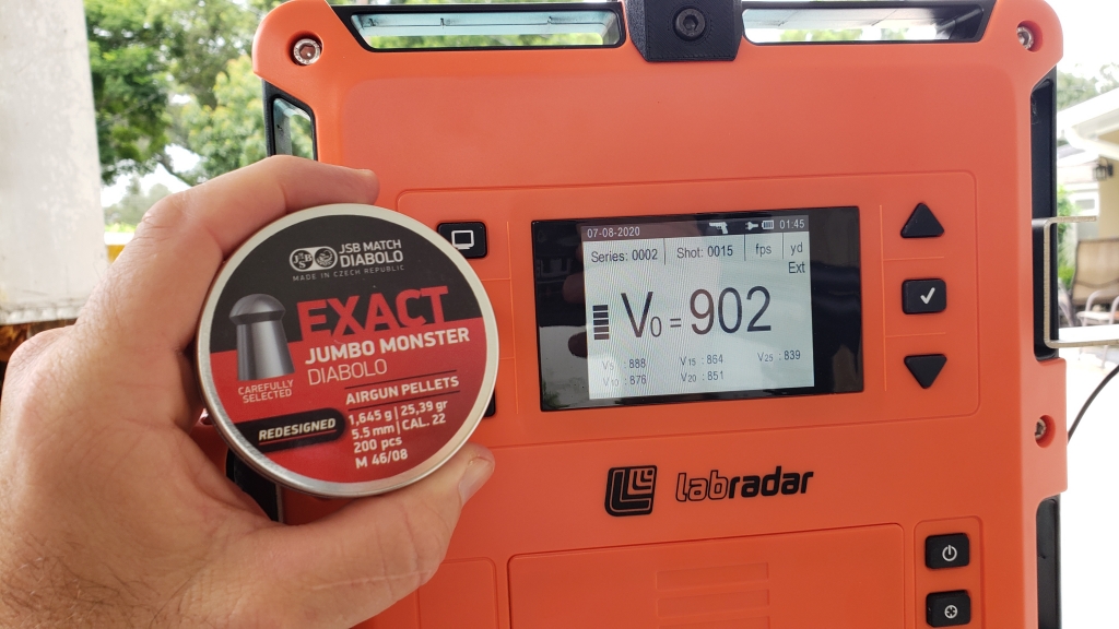

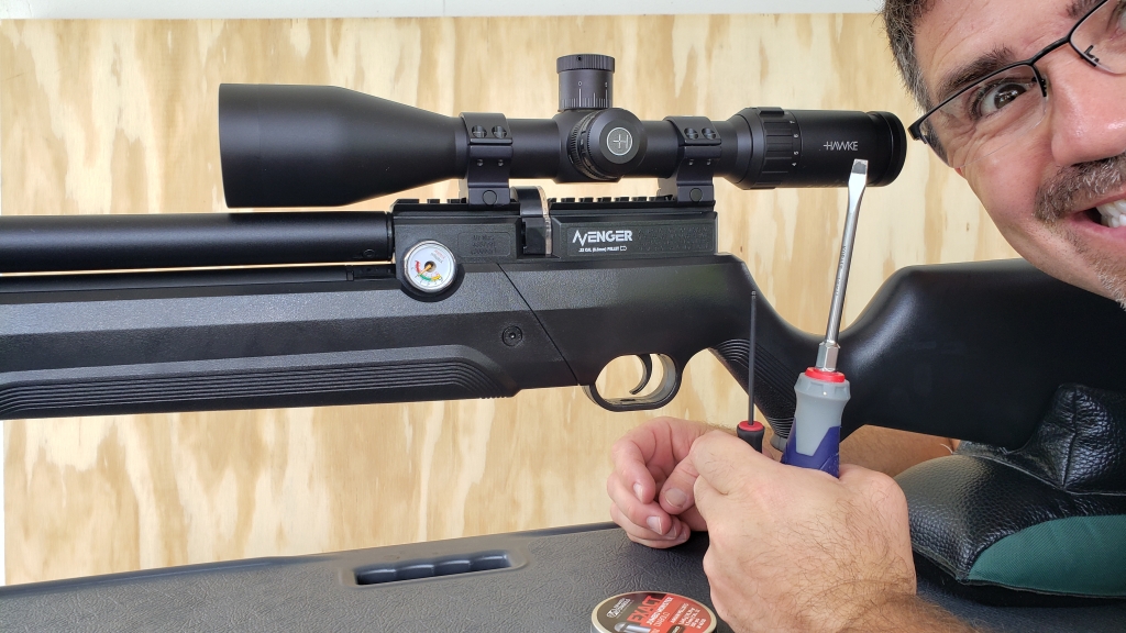

In preparation for some 50 & 100 slug filming tomorrow, I wrung a little more power out of the .22 for 45.88 fpe 👀
Reg 2,500 psi
HS + 5.5 turns
this setting and others all around it gave me 40.7fps with the RD's @at a 4.5k fill...
what else should i try for the 45.8fpe goal ?
5.5 turns is max on my gun
