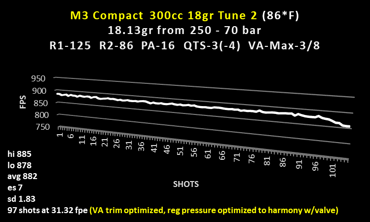

Tune created at 86* Fahrenheit and arid.
Above tune retested at 48* Fahrenheit and rainy/wet.

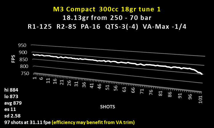

Here's one I came up with yesterday... first swipe at an 18gr pellet tune.
My goal was to improve upon the OEM tune with an improved ES & SD, while maintaining the speed of 880. Today, I'll try to stretch things out a bit more. Guessing that some VA trim, or another 3-5 bar on the reg may help accomplish this.
