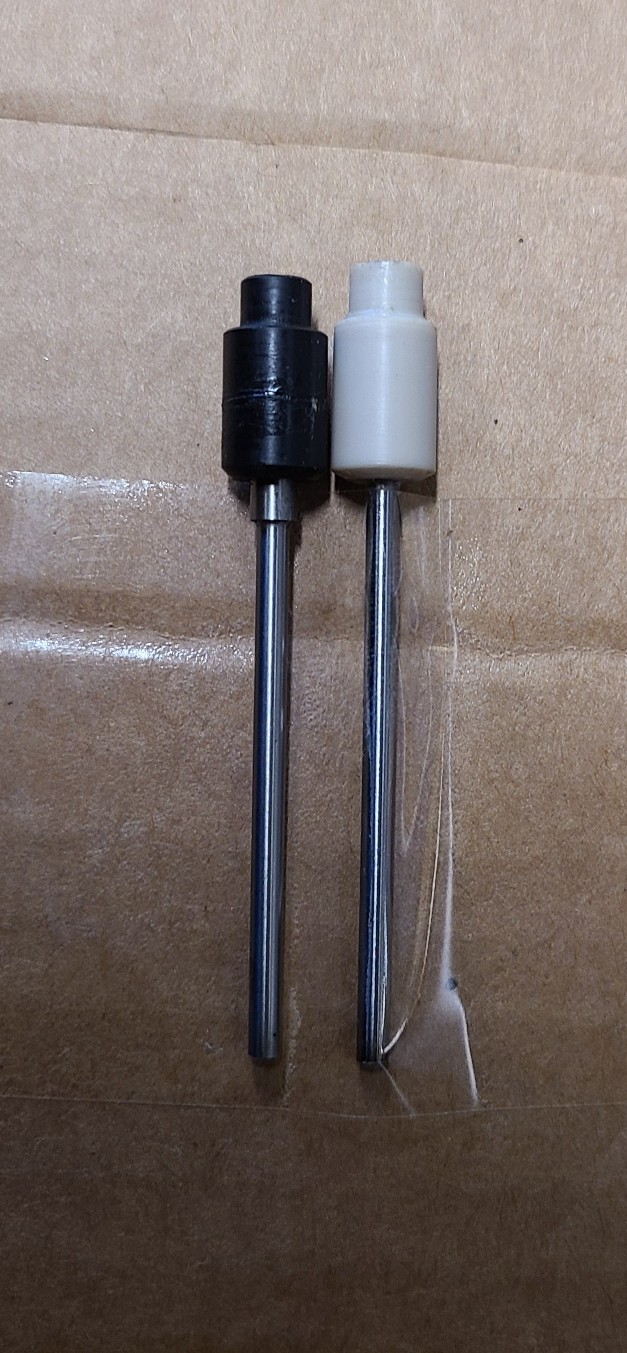

We didn't hit on the tuning portion of the cycling or the overdriven bolt. While the fill air does have something to do with cycling, you can easily remedy that by using a peek poppet so the hammer can pop it off the valve seat easier.

Well, I did have a guy make me a new poppit and so far it's working fine, but just in case I had another guy make me one out of peek. It appears that the stem on this one is a little longer tho, maybe a quarter inch at the most. Will that still work, I really don't want to take the other one out as long as everything is working? And when and if I do need to replace the one in there now and I find that the peek one's stem is a little long couldn't I just grind it down?
Jimborg here is a pic of an OEM poppet for my carbine and the PEEK. It shouldn't be too long. If it is PM me.
