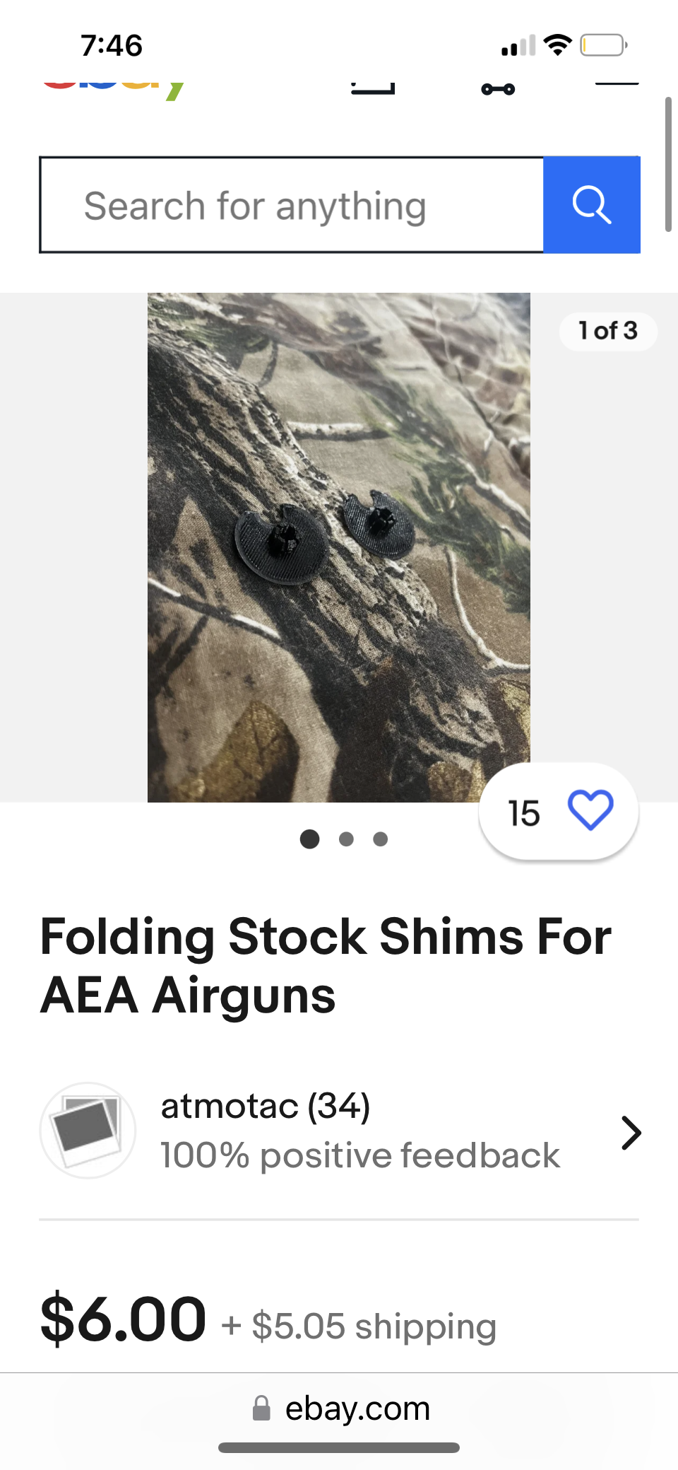

I just saw today shims on eBay for the folding stock
It’s the same as the Hp series set up
Look up aea stock shims. $6 bucks as I recall

Just an update for everyone on this. I ordered the 3D printed spacer from Ebay and they came in Saturday. The seller sent 3 thin ones and 3 thicker ones. I popped a thin one on and it completely fixed the stock! I had already added a little tape to the buffer tube to take that slop out and had adjusted the catch pin on the latch previously, but still had lots of lost motion at the latch. The 3D printed spacer cured that ill and I'm a happy camper now :)
I'm a little delayed on responding because I accidentally had it shipped to my old address. Bounced back, sent back to my proper address after I updated Ebay info. The seller was communicative the whole time (for a $6 order... you can tell he's a solid dude).
I also got 6 shims. My HP SS 30+ is feeling super solid now. I'm glad you mentioned that 3 are thin and 3 are thick. I put one in my Challenger Pro 30 and it helped but not completely. I saw your post, took that out and realized it was a thin one. Just now put one of the thick ones in and it's solid as a rock.
