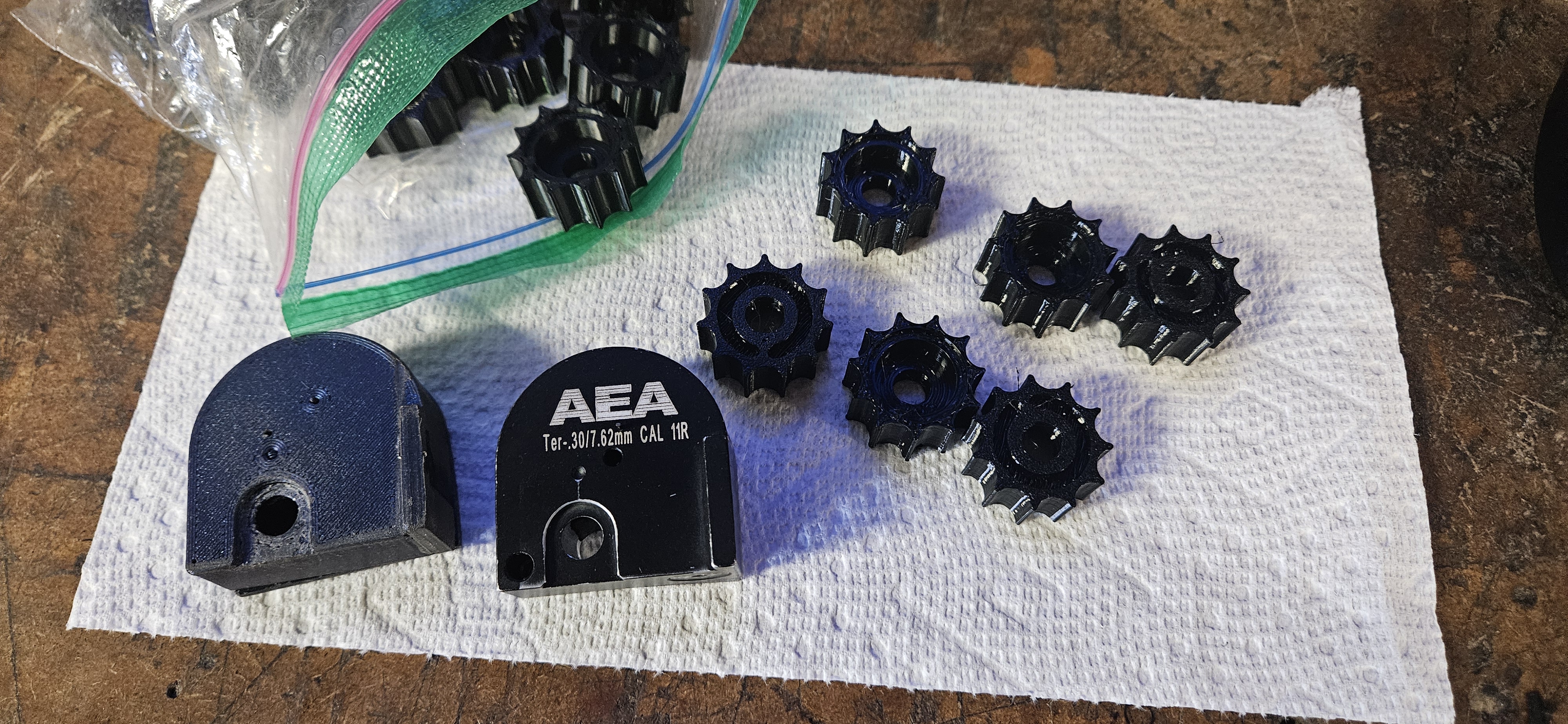

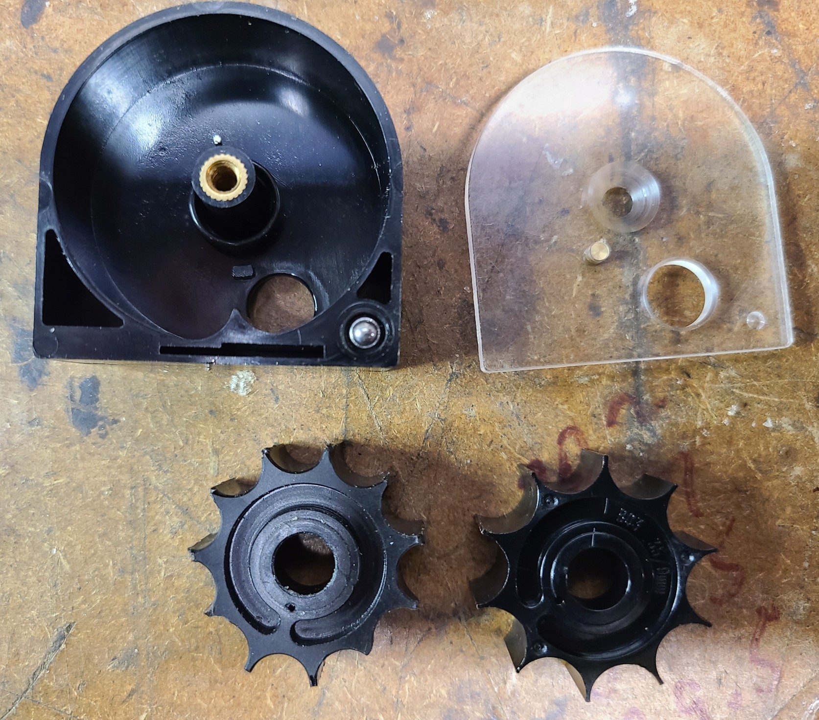

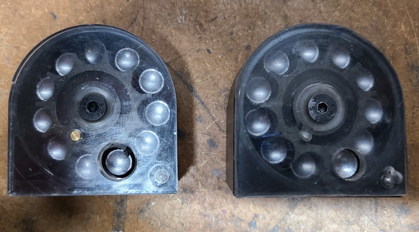

I have been trying to find 30 cal mags for the Terminator sinse last summer. For some reason they are unobtainable. I had some carousel wheels made for my two 30 cal mags and decided to purchase the ..357 mags and try to convert to 30 cal. The body is the same size but the clear plate cover and carousel are different. Anyway I changed out the carousel and left the cover as is. So far it is working fine and I have not had any jambs. This might be an option for others who are trying to find 30 cal mags. Converted mag on the left.
