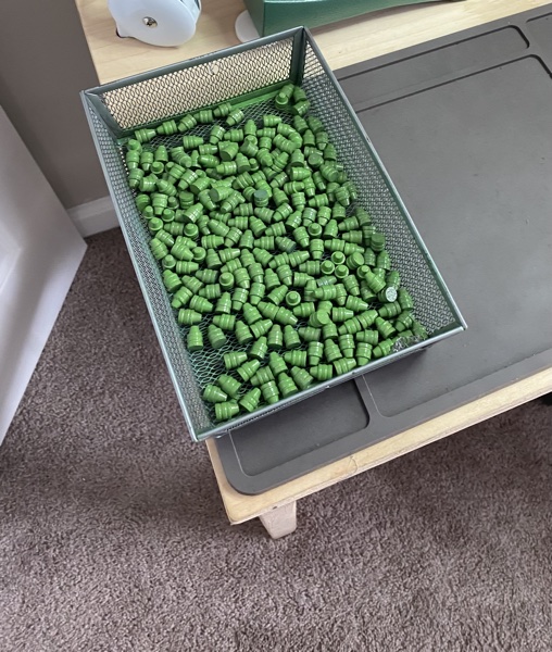

Powder coat your lead pellets if you're concerned?
