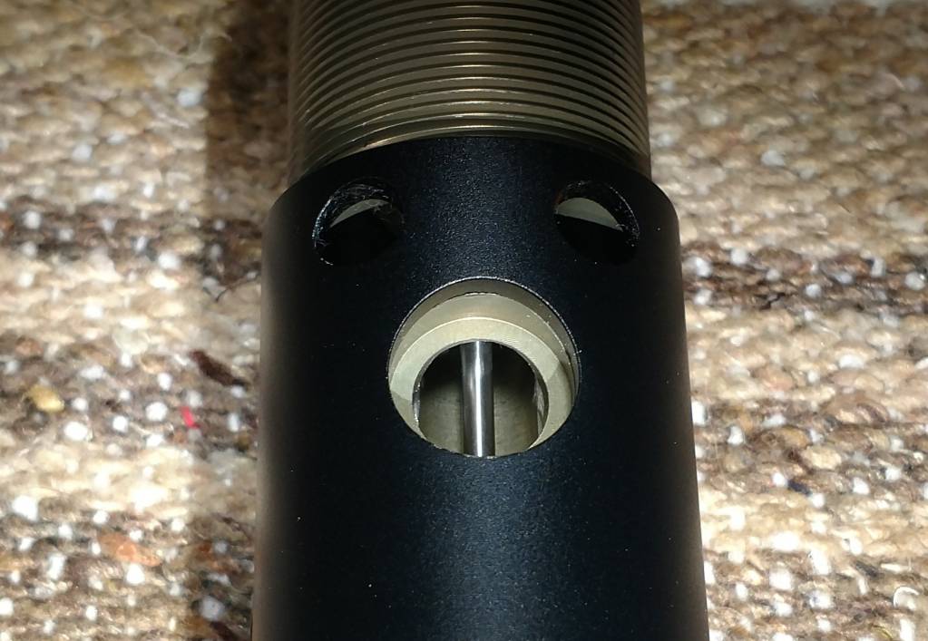

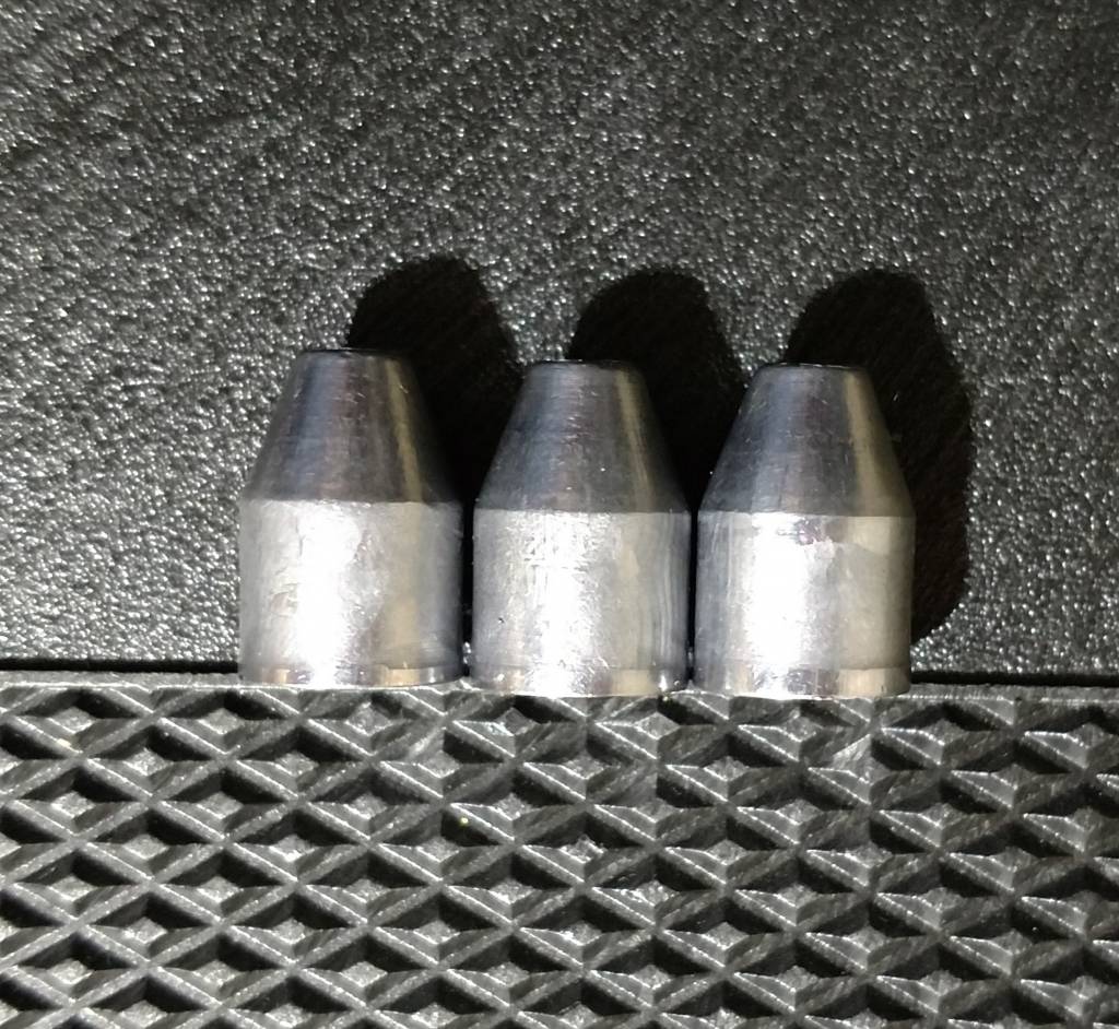

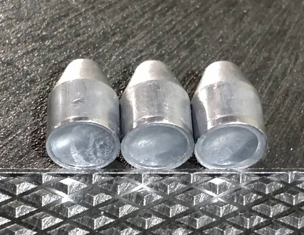

I have an easy working solution for the NSA slug sizing in the large bored .457 Challenger barrel, which slugs out at over .4615". I have both NSA 220 and 240 grain dimple/dish back slugs. I take a long punch, about .125" diameter that fits about 3/4 the depth into the hollow point, and tap it with a hammer until the lead expands. (More taps for more expansion).
Then I size the slugs through a Lee sizing die .457 that I expanded/sanded & polished the inside to match the inside of my barrel bore. If you don't expand the slugs as much as I do, then you won't need the Lee press and sizing die. Just a few taps with the hammer on the punch expands the bottom several thousandth of an inch and acts as a gas check to seal the bore. Though sill .457" the front of the slug centers and rides the rifling.

I like the gun as well. So much so that I looked into re-sleeving the existing barrel to a .452 as there are a lot of ammo choices in this size, along with a lot of room for polishing the bore. It is the easiest and least expensive way to go with the least amount of machining involved (to keep the cost down). But for now I will pound out and size the six hundred slugs I have from NSA and probably won't require much more than that once tuned properly.
The next process will be to get the velocity up to the other guys' speeds. My 30" Challenger Bullpup only pushes the 240 grainers' to 840fps at 3100 psi. So now that the barrel and slugs are done I'll work on polishing up the moving parts within the valve system and porting and polishing the transition into the barrel to move the air efficiently.

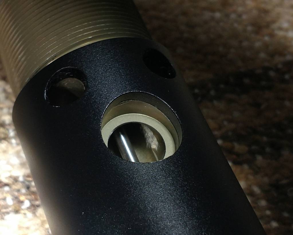

With the modified/sized NSA 196 grain HP-DB slugs I get two consistent top speed shots right around 980 FPS, between 3100 & 2800 PSI. Now that there's a baseline for pressure where the valve opens without restriction, I'm hoping that a regulator could be fitted for a pressure of 2500 psi to get four to six consistent but slower shots... If anyone is knowledgeable in the realm of regulator's and the like please give some input in the new "Regulating a Big Bore" thread.
So if I did a barrel swap for one that's better suited to .457 diameter and then ported, think I'd have similar results with .457 slugs? Who apart from xp airguns could I ask about a barrel swap? They arent being very responsive right now. 240 grains going 900 fps is a bit over 431 FPE. I'd be very happy with that. Curious if you have any 220s or 196s to widen and test, as those yielded higher energies for me, albeit unmodified

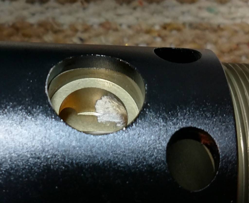

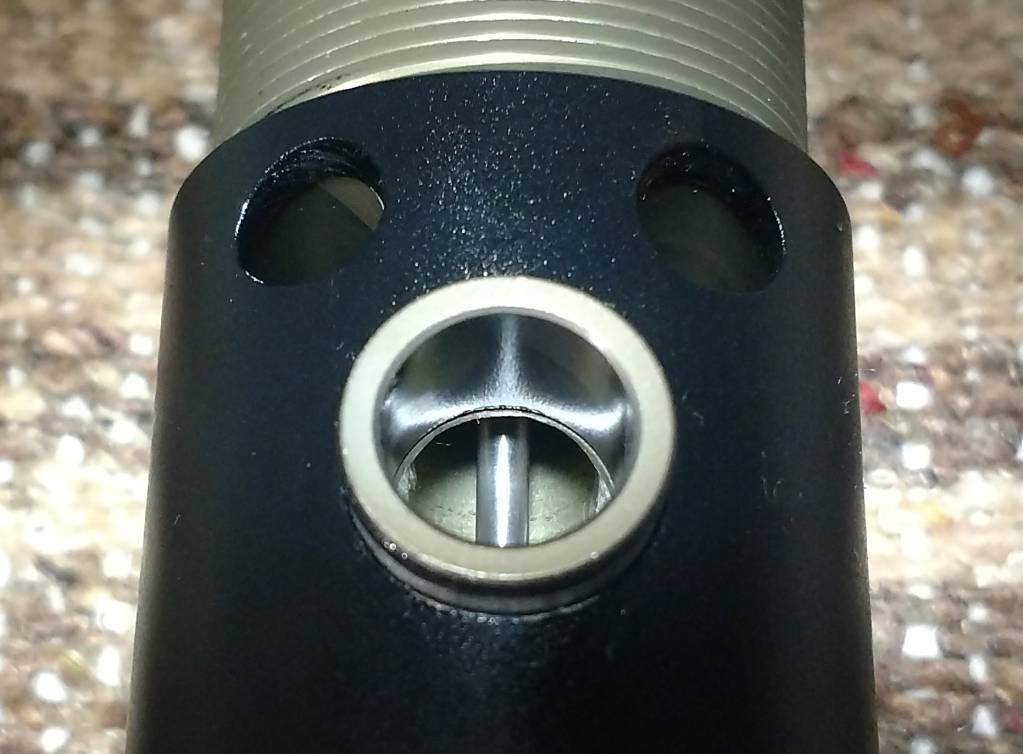

If you just ported the valve corners so the air flow up smoothly, added a hammer weight washer (which also adds spring tension), and tapered the barrel port holes, you would push those 240 gain slugs at 960 fps.
There is a decent amount of money invested in either a big bore barrel swap or re-line. Personally, I would look to any gunsmith shops that re-lines barrels and have them install a quality new liner, like a TJ's. That would probably be the least expensive way to go too.
Finally got around to slugging my barrel. It is indeed a .461 just like everyone else. Bummer. I'm just gonna get a .458 die made and have the punch set up to make dish based slugs so that hopefully it acts a bit like a pellet skirt and helps make up the difference in diameter. I'll report back how it works out.
The great thing about the Corbin press and die is I will be able to precisely change the length and therefore weight, and thus be able to hone in on exactly what weight slug is most efficient in terms of FPE. I know it's somewhere between 196 grains and 240 grains. This assumes stock configuration and not with washer rings and higher pressures used. Will report back on that too
